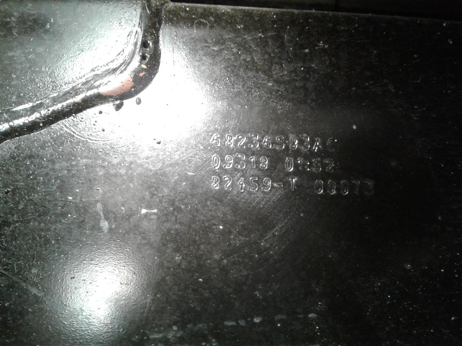

Well maybe my welds aren't so good. I just looked at the photo I took of my frame stamp and guess what I see. Pits in the weld.
Jeep Wrangler JL Massive Frame Weld Issues Frame stam
Seriously this looks no different than any other vehicle I've ever owned (Ford, Chevy, Pontiac, Dodge, Honda and Jeep). I think we may be a little more focused on them than other vehicle owners because this is the first I've heard anyone mention weld issues. Though the OP's do look a lot worse than mine. That then leads to the question of what is acceptable and what is considered bad?

Ya one small porous area isn't too bad and actually meets spec per the star publication by FCA. My entire frame is covered in missed welds, beads from spray, large porous areas, etc. Does anyone know how to interpret the frame numbers and what numbers were part of the recall?

Many of the frame numbers were not legible. Mine looked like braille. FCA opened the recall (track bar bracket welds) to the build date range regardless of frame number if I recall correctly. I don't think there is any other official recall regarding frame welds. That's not to say you can't get a buyback for bad welds that don't meet the FCA inspection criteria.
Makes complete sense. Can't get the welds right, so why would the frame numbers be legible. Would you agree that my welds definitely validate a buy back? Seems to be the consensus to me.

The top number is just a part number. The middle number/row is the one you're concerned with. The second row is the one you're concerned with. I don't know if I'm right or not, but as best I can tell, the first three numbers are the day (1-365), with the next two digits being the year. If I'm interrupting that correctly, it shows mine built April 3rd, which matches my door sticker's build date. After the date there's a gap and what looks like the time the frame was built. I don't know what the third row is.
On another thread, someone posted the recall inspection and where to find the stamp.
See post #9
And yes, I'd definitely say your welds look sub-par. Whether they do a buy back or repair is hard to say (I don't know how they make such decisions), but the quality doesn't look like what I would expect.

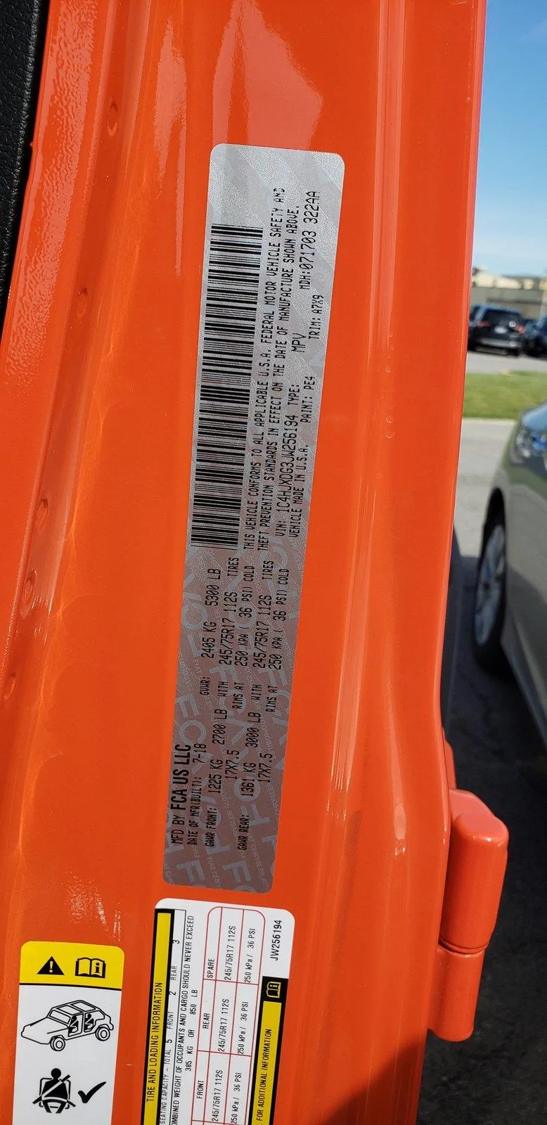

Actually the more I think about it, it makes more sense. Your door shows 7-18 for a build date. If the frame shows similar or it was made before the vehicle build date your's would be coming in right at the end of the recall. Mine was made before the issue began so maybe only a little pin here or there before the problems began.
Per the post from the other thread (and assuming I'm reading the frame numbers right) the recall would be for those made May 6th through June 5th. It's not unreasonable to think that the issue would extend beyond the initial recall dates reaching your July build.

Exactly what I was looking for! I will check my frame number and post it on here. I have a feeling the issues much bigger than they have made it out to be. I will check on my lunch break to see if the number is legible!
