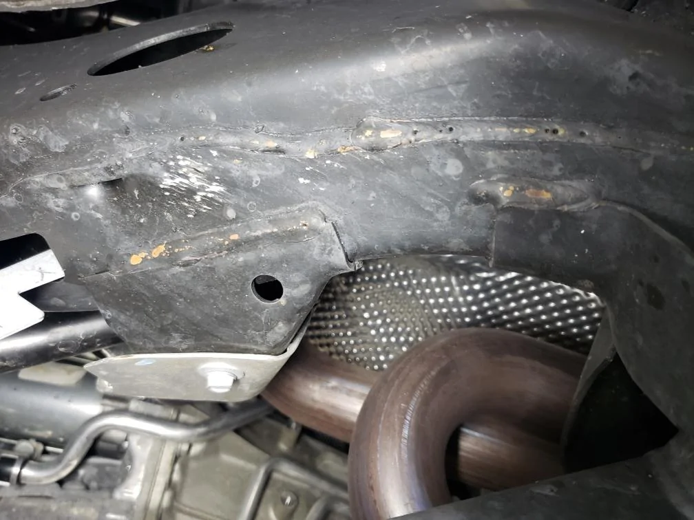

Mike MacDonald had me take in my Jeep for inspection on Friday. The service manager put my Jeep and another 2018 Wrangler up to compare the welds. Needless to say, the other wranglers welds were a thousand times better and we're what I expect on a vehicle. The service manager agrees it was definitely an issue and is hopeful FCA will take good care of me. He reached back out to FCA, as did I, and we're now waiting on a response. Hopefully I'll be in a new Wrangler before the end of the month!
Good luck. I have taken it to two dealers and contacted JeepCares multiple times now with very little success. They're basically telling me that "rust is normal for a 1 year old California car."

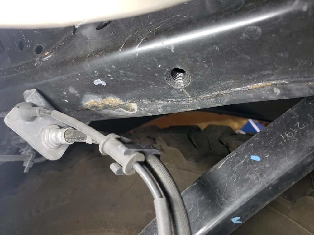

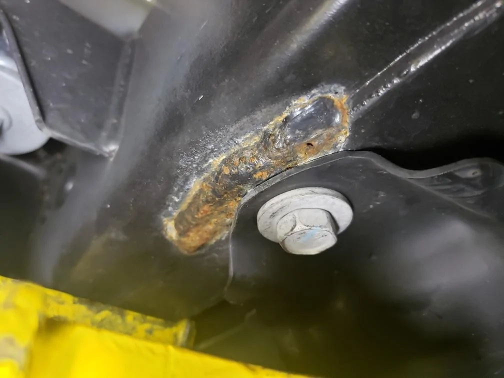

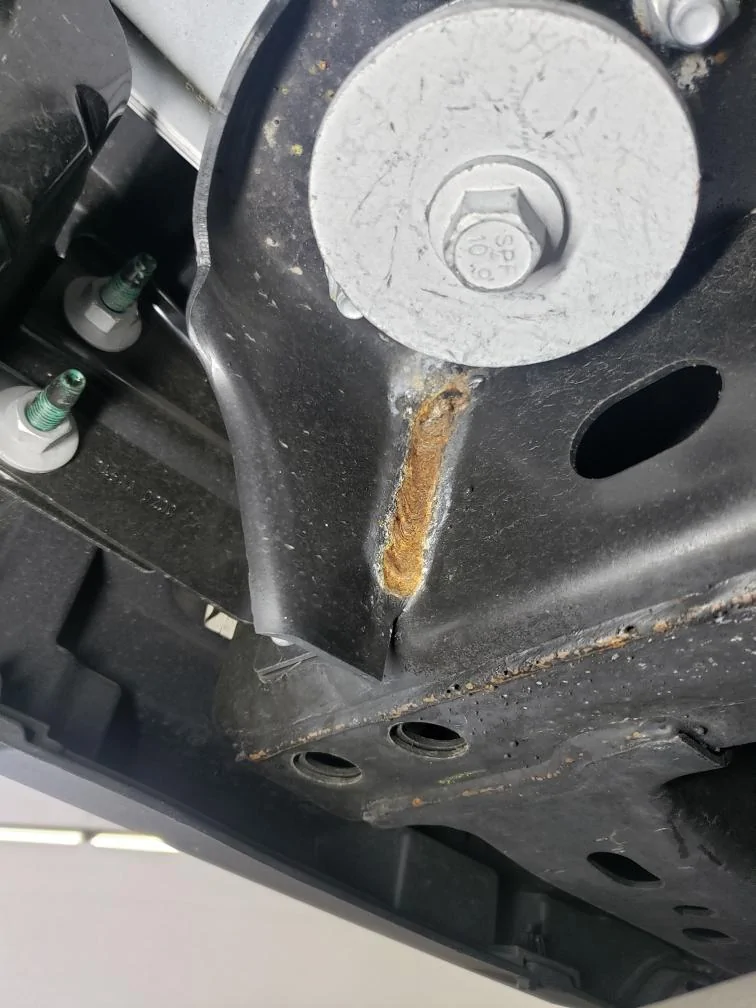

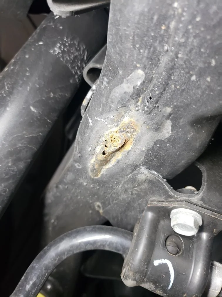

Took my own car in for a third party/independent-from-a-dealership examination and we found rust, not slag, in multiple locations. As for "slag"....it's all over the car and there's no point uploading those. Too many pics of slag. Mechanic took pics, here they are.
Again, this is a vehicle that was purchased and used in Southern California. Has never seen snow salt rust, etc. Around a year old, 21k miles. Everyone tells me "the rust is normal for weather conditions and use." My 12 year old Honda Fit that actually was used in the east coast in snow and salt, when I lived out east years ago, has less rust issues than this sunny-SoCal-only car. Ridiculous.
Hope you have better luck than me, Rutterbg.

FWIW your welds don't look bad, just rusty. If the rust concerns you clean it up, and put some paint on the affected areas. No, you shouldn't have to do that on a new vehicle, but you can prevent it from getting worse if you choose to. Or you can let it go because you shouldn't have to do it, and accept that there will be more rust years down the road.

Jeep/FCA should replace yours under customer goodwill, but probably are afraid of setting a precedent. It looks like your frame welds had been gone over prior to you buying it, and are
Technically sound, but weren't painted. Probably won't be a Happy Ending to this Story....

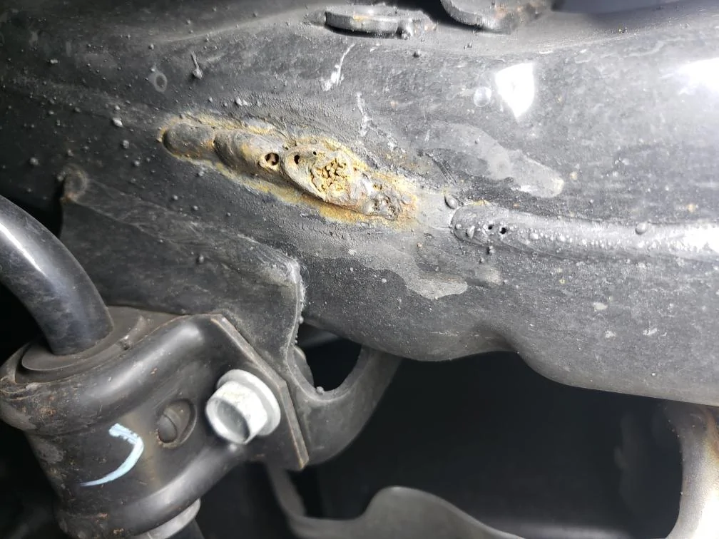

I would be interested to hear the end result of this. My Jeep appears to have similar issues. Lots of weld porosity, some very serious examples of cluster porosity, and some places where the weld is completely off track and not joining the two components. I’m thinking they didn’t have the kinks worked out if the robotic setup yet....Fortunately for me, I am a licensed professional engineer and a certified welding inspector. Hopefully FCA will take care of this, but so far it has been agonizingly slow. My dealer took pictures but they were rejected because they didn’t have a verifiable steel scale (rule) in them.

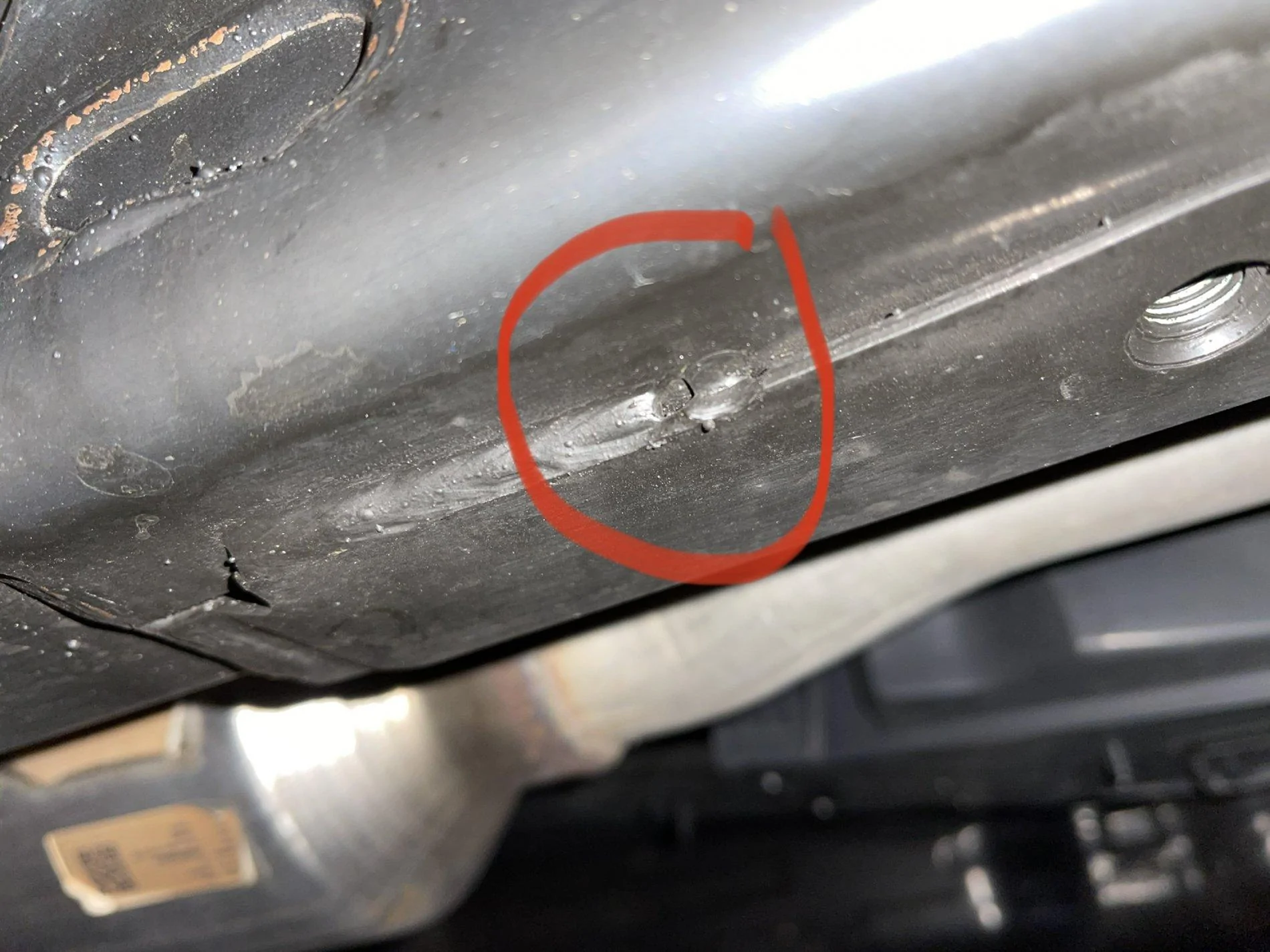

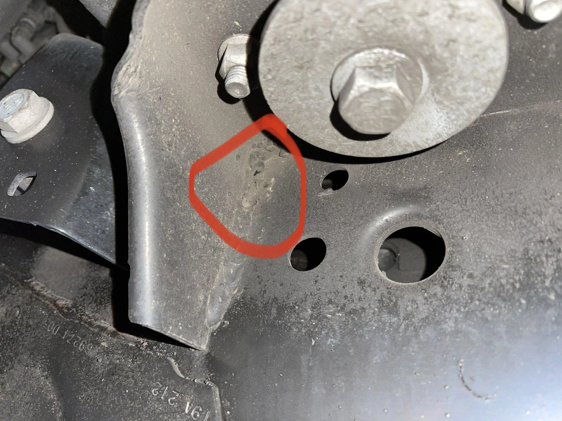

I have a 2020 Sahara and I have a chunk out of my one chassis mounting point seem and another on the frame.
