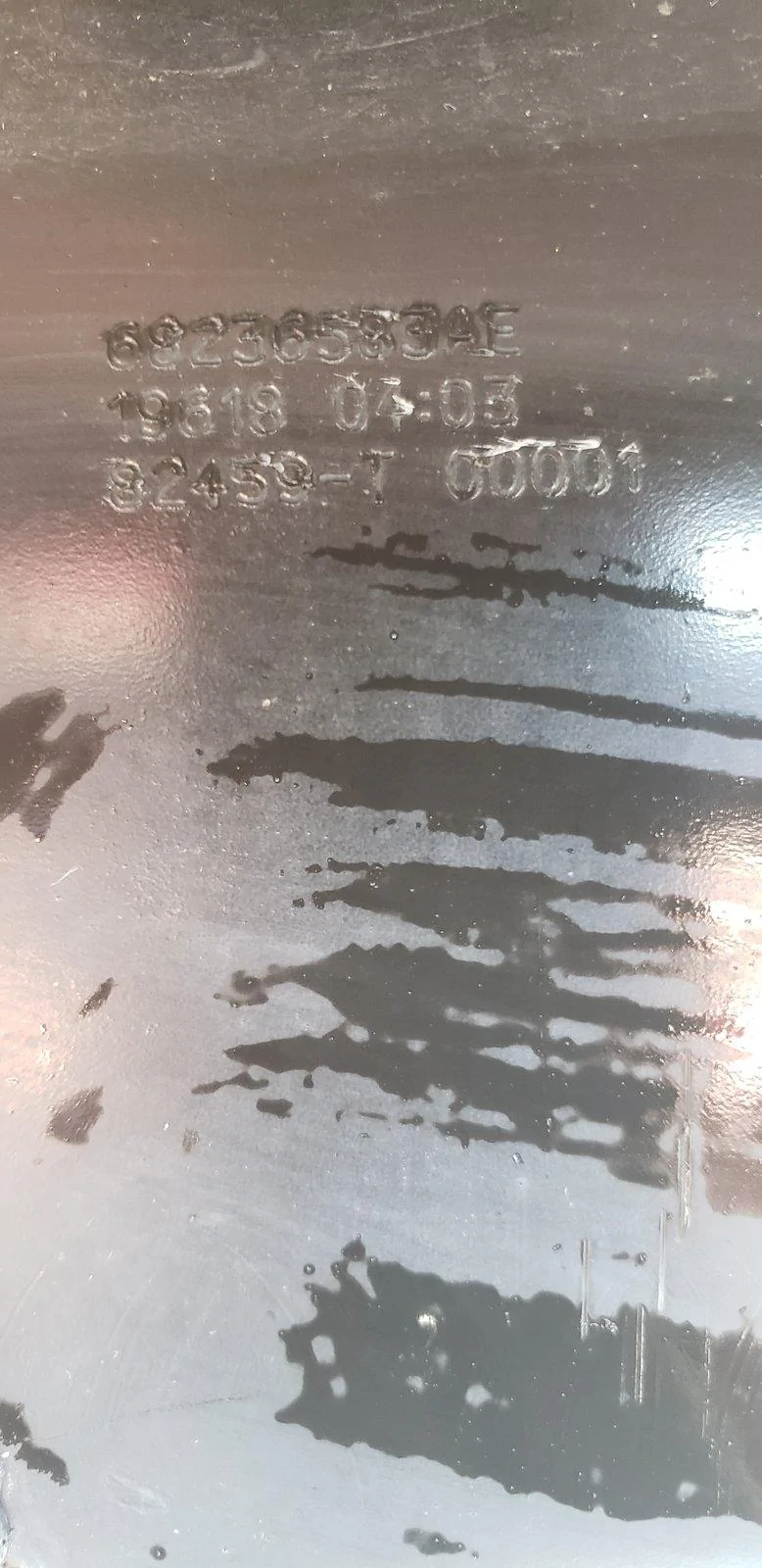

It should be as long as it's not caked in dirt. I found a flashlight made it a lot easier to read too.
I wouldn't be surprised to find your fame is within range of the recall. That or if they have an unofficial range that they'll replace outside the official recalled dates that yours falls into.
I'm much more comfortable knowing mine was made a month before the issue began, than I would be with it a month after it allegedly ended.
Looks like mine is a 196 which would have been after the fact. Looks like your conclusion may be correct! They definitely didn't recall enough vehicles for weld issues.
Jeep Wrangler JL Massive Frame Weld Issues 20190614_112741
