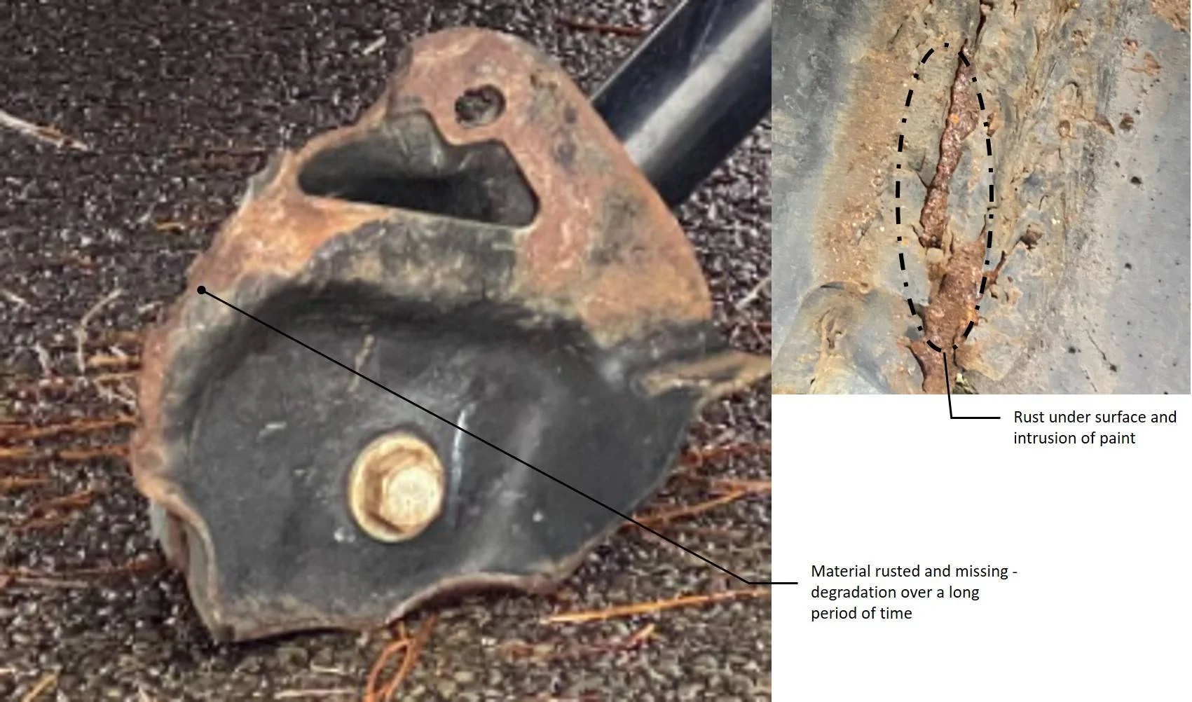

There appears to be major decay over time of oxidation on your frame and components i.e. salt invasion. With the apparent missing parent material as well as a weld failure this is fatigue over time - and everything is not known. So as far as an answer on this forum, for your area and environment this would be expected and is not a sign of weld penetration etc. It is failure due to the environment and fatigue of the mounted component load - the affected weld area looks as if it had been "touched" at some time and that would not have been normal maintenance that a dealership would have performed.

I don’t see any evidence of attempted patch welds. Just the typical sloppy robot welds.

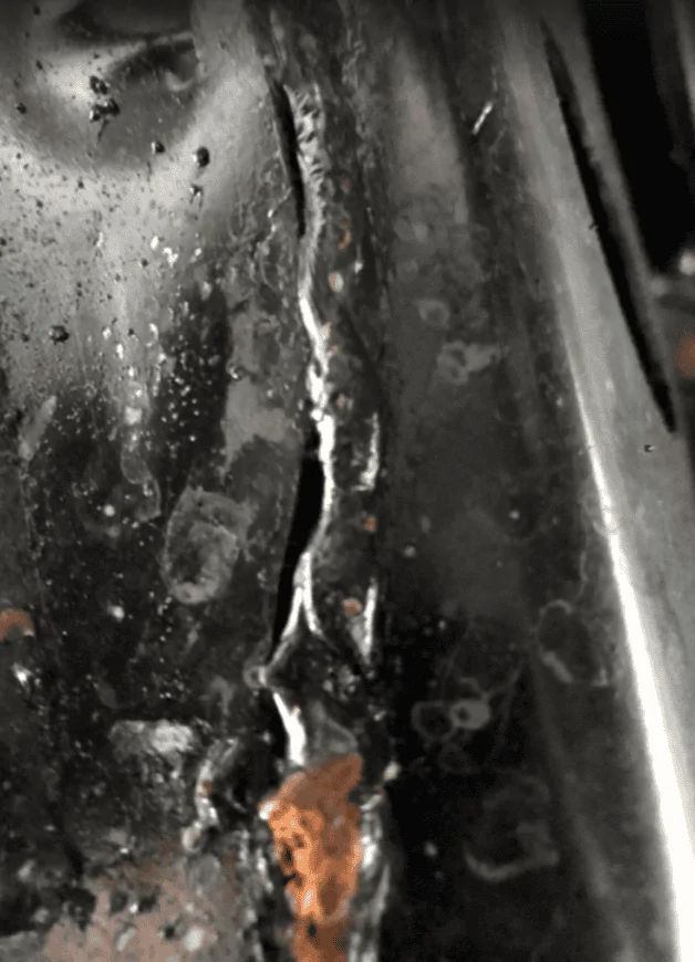

I think in 2018 they had the Boy Scouts working on their welding merit badge welding the Wrangler frames. Here is a pic of my 2018 frame weld in August of 2018. Jeep was 2 months old and never driven in the rain or mud (at that point).

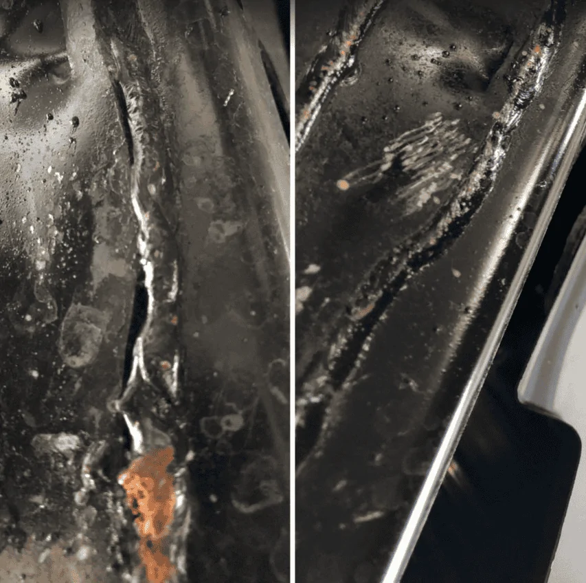

Here is a comparison of my 2018 frame (left) and a 2019 frame (right)

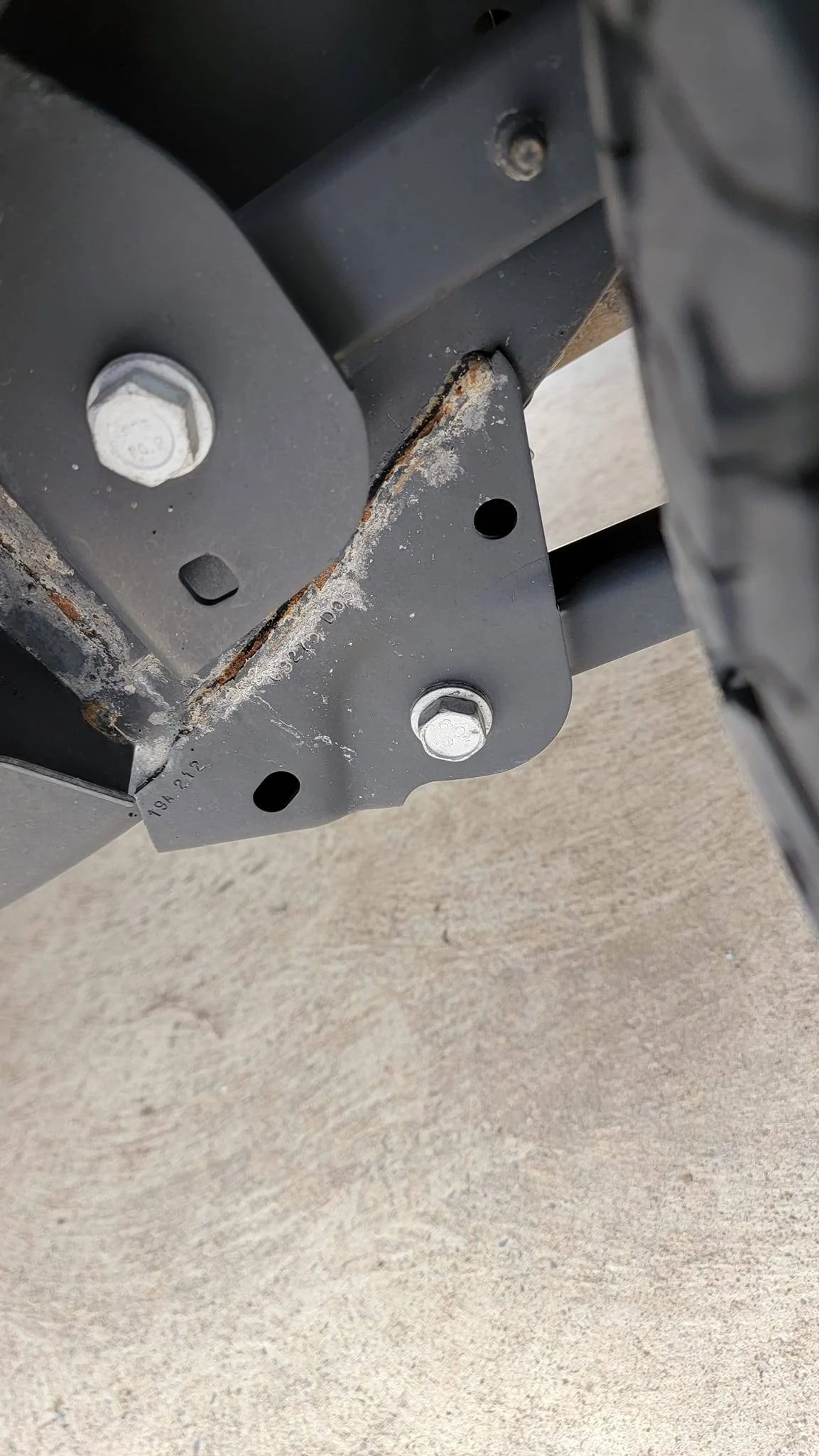

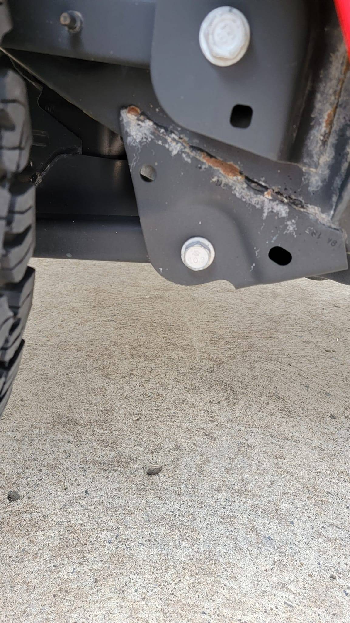

I was just putting my RainGear cover on in prep for a storm. While strapping things down, I noticed my rear control arms looking odd. Anyone think these needs looked at? This is a 2020 JLUR and pretty much factory underneath.
