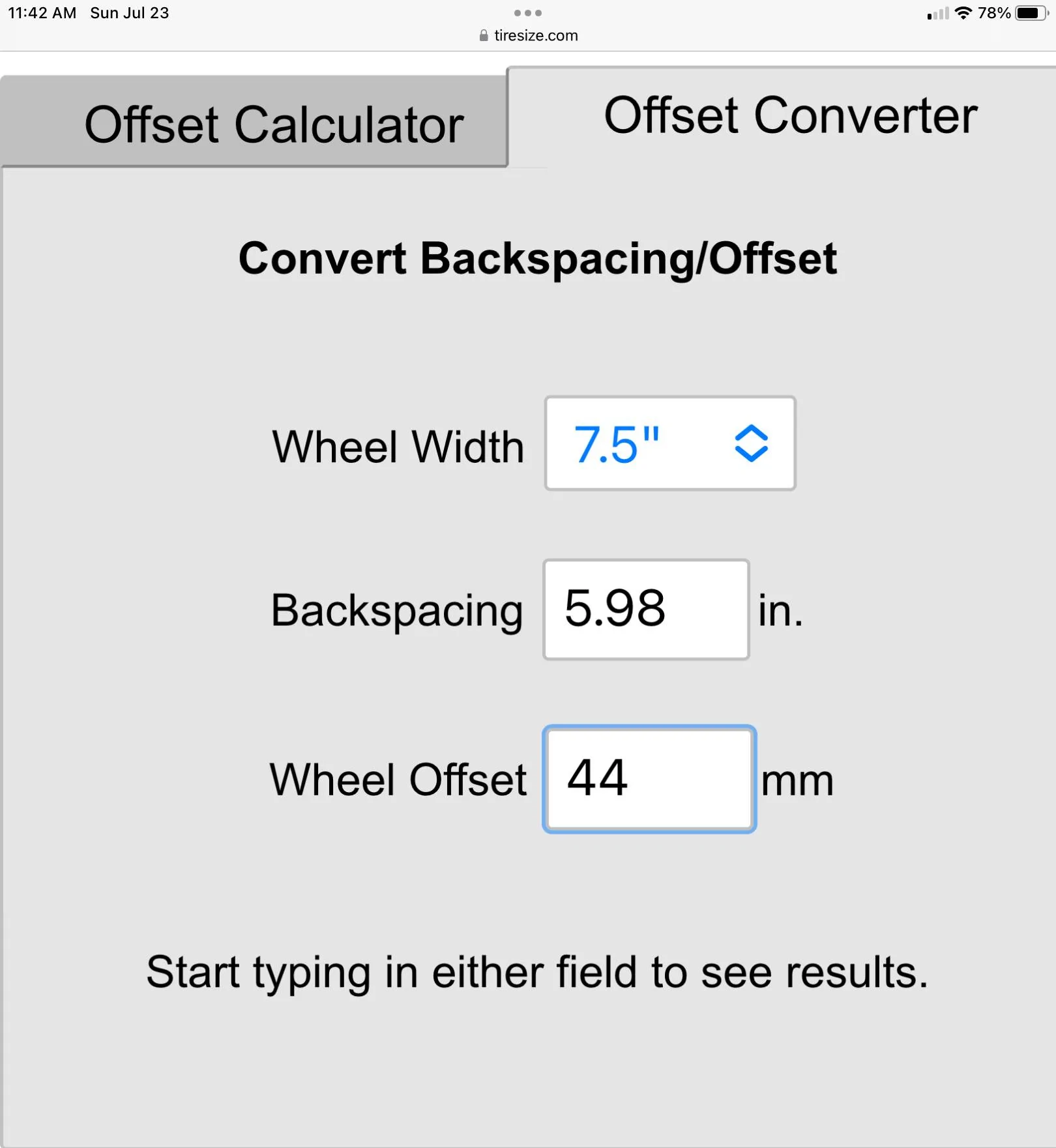

No, your thinking backspacing not offset. With offset the width of the wheel isn't relevant. ... at least not if a wider tire isn't required. Of course, if you change the tire width half of the difference will go to either side of the new rim.
run some examples here:
https://tiresize.com/wheel-offset-calculator/
Incorrect. Wheel offset is absolutely tied to the wheel width when determining where the front and rear edges of the rim will be. Offset refers to where the mounting surface is in relation to the center line of the rim, positive means its closer to the front and negative means its towards the back. Without knowing the width of the wheel in question there is no way to know where either front or back edges will be. Backspacing will give you the back edge measurement by itself.
This is a better and easier calculator to use when fitting wheels, assuming you know the dimensions of what you're starting with.
http://marksink.com/tire_wheel_offset/offset.html
The SRT wheels, when compared to the stock wheels on my wife's Sahara 4xe (20x8, et45), will extend 30mm more into the wheelwell, and 20mm more towards the outside of the fender. Not much poke for him, but 30mm inboard is quite a bit and would likely rub on the control arms when turning.
I was making a big assumption that he'll be wrapping these wheels with a tire and that these tires will sit a quarter inch more inward on the new wheels compared to his stock ones, assuming the same width tires old and new, which your math verified as well. I Feel like Joe Pesci in my cousin Vinny.
I saw that movie once 30 years ago and don't quite get the reference as I didn't really care for it then nor remember much about it, but that's beside the point...
Forget the tires, they're an unknown variable. Wheel fitment is the first and foremost concern. You said "With offset the width of the wheel isn't relevant", but offset and width are absolutely tied to each other and both have to be known to determine fitment. A 7.5" et50 wheel will have 32mm (1.25") less inboard clearance than a 10" et50 wheel. Compared to a stock JL 7.5" et44.45 wheel, this 10" et50 wheel will have 38mm (1.5") less inboard clearance.
The link you posted never asks for wheel width, so it can't accurately calculate anything if that is changing. If you're using the same width wheel, but just changing offset or tire size, then it's great.
It’s there . . .
