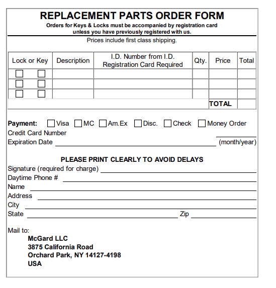

I have two sets and the key is not the same. The package has a code number on them, idk if you can order a new key with that code.
A tire shop can get them off.

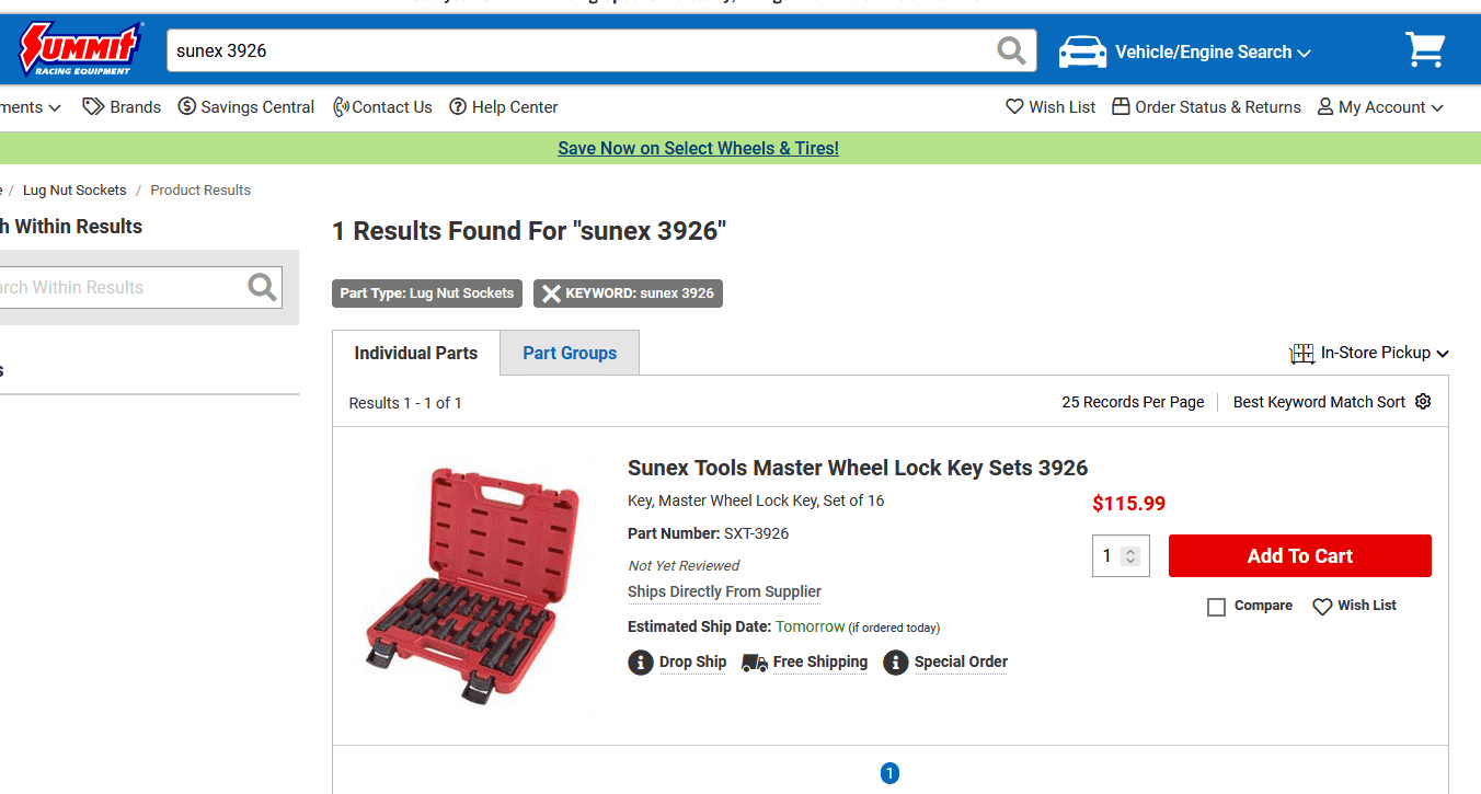

that is insane. You can buy a single socket that will remove locking nuts for as $10 or a whole set of different sizes for $40-$100.When I had my JK I left my key on my bumper after I did a tire rotation and it was lost. I realized it a week later when I went to change brake pads. Ran to AutoZone and bought the socket and locking nuts came right off

Go to the dealer and talk to the parts counter. They have a plastic case with a bunch of different lug nut “keys” in it. Normally it would be easy and you would have the bag that the original lock key was in and you would give them the number and they would sell you a new key for a few bucks. But if you don’t then the parts person can walk outside with you and test the keys till he finds the one that fits then sell you that one. It’s not a big deal.
