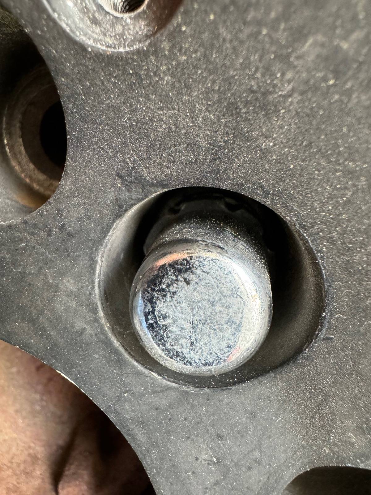

Can anyone identify this special lug nut key? I’m looking for the socket and I can’t find it anywhere. I have XD822 Monster wheels on my 2018 JL.

Not the direct answer to your question. Any reputable tire and wheel shop can remove those at a reasonable cost. Replace them with new wheel locks of your choosing.
bjm00se
Jan 26, 2021
1,457
3,465
JLUR 6sp ordered 11/3/21, picked up 8/30/22
There are not that many possibilities out there. Count the number of slots, it'll probably be six or seven.
Figure out if they're evenly spaced or irregular. If they're irregular, you'll probably need to go to a "brute force" destructive technique involving hammering a socket onto them.
But if they're regular, you should be able to google up a fitting hex key by looking for e.g.
M14 x 1.5 six spline hex key
That was how I did it when mine went missing.
