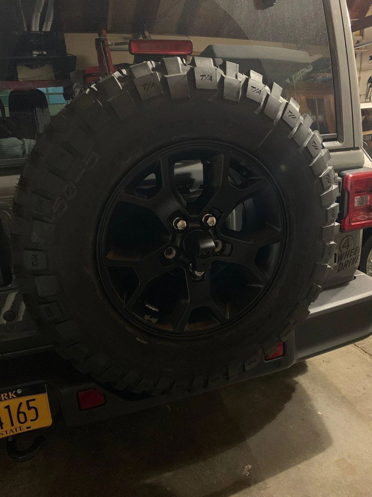

Good idea. BTW did you order extra lugs for the spare? Your pic looks like the spare has 5 mine only has 3 and I'm trying to figure out what to put in the empty holes to cover the silver
There are 5... I picked up a handful of lugs, wheel studs & 5/8" washers from AutoZone to cover the blanks.

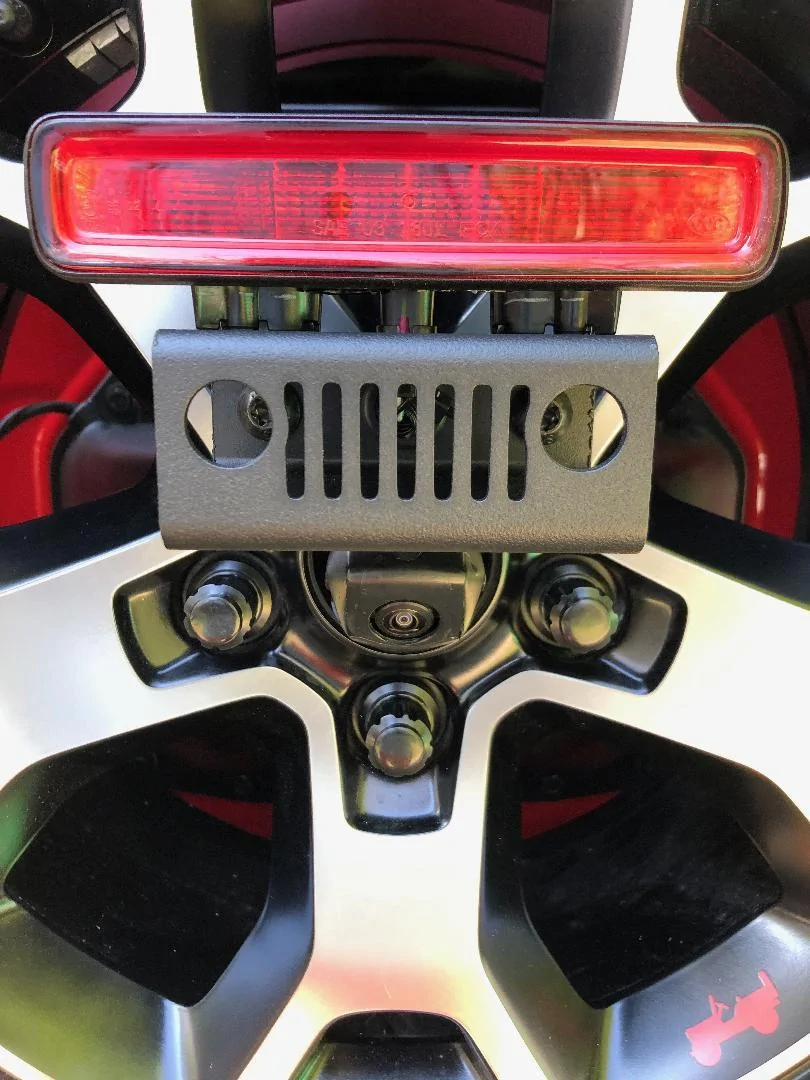

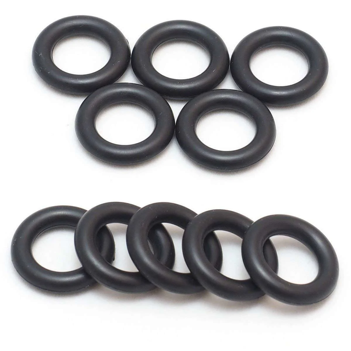

@cmichaelis1990
The Dorman 610-329 studs can be had for $4.50 each at most auto part places.
You will need 2 Dorman studs, 4 -6 metal washers and also 2, 3/4" round, rubber washers like in the pic below that you can find locally or on eBay, etc.. Of course, you need 2 lugs also.
Jeep Wrangler JL Locking lug nut size s-l1600

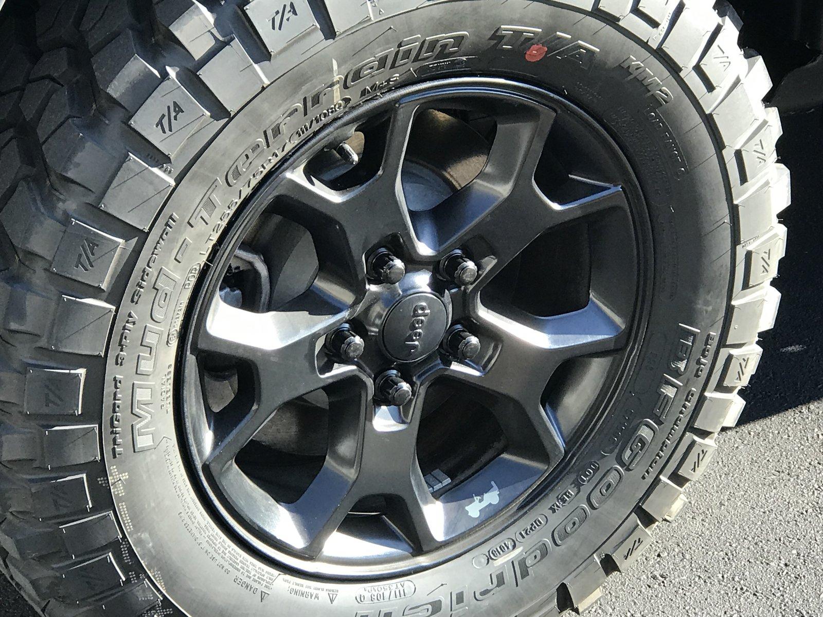

Thanks for all the info the black lugs look awesome, I also picked up the studs for the spare just need to install and find another single black lug. If anyone has a single they want to sell let me know.
Jeep Wrangler JL Locking lug nut size 20190126_190758777_iOS
Jeep Wrangler JL Locking lug nut size 20190126_190811521_iOS
