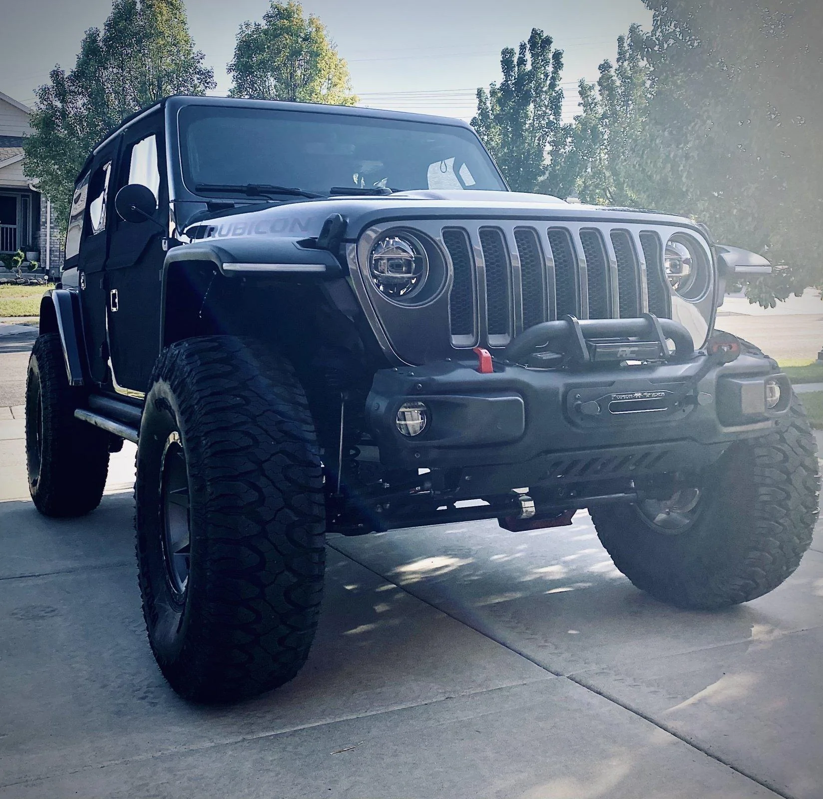

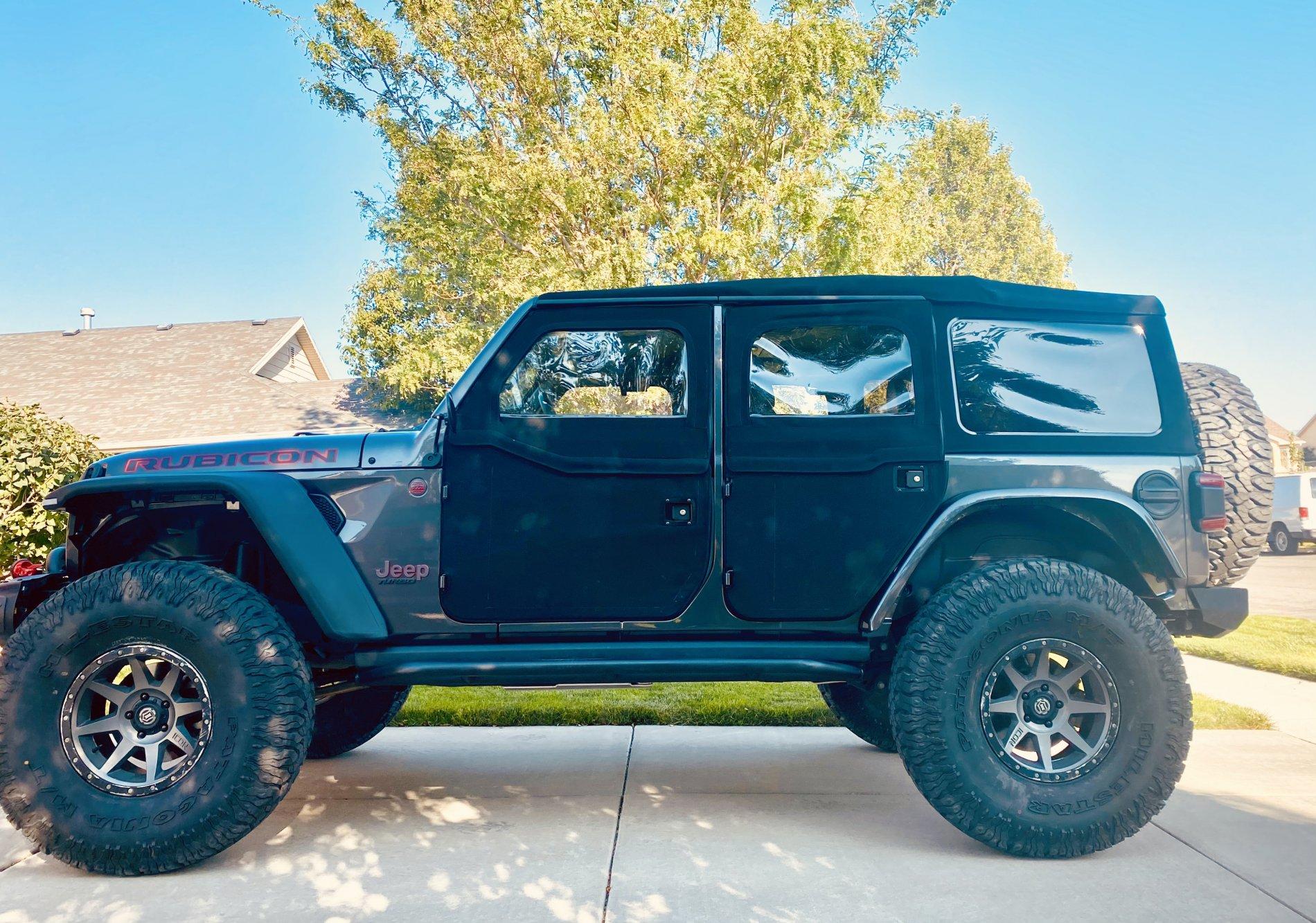

jason,
There is so much you can do with a JLU.
I Run a MC 3.5 game changer lift. Stock D44 with 40’s. I have upgraded the gears and axle shafts. 5.38 to give it more get up and go as I do drive on the freeway. I did need to trim the rear wheel area but just a little. Also separated the fenders for more room for the tires. I only wheel in Moab and sand hollow so only rock crawling no mud.
I too had a93 YJ before my JL and have no regrets, good luck with your build.

So all you did was replace the axle shafts to something stronger then? Or is there more to it than that? I’d certainly be willing to upgrade the D44’s! The Jeep is looking awesome!
I upgraded the axle shafts front and rear with the Dana chromoly’s and 1350 front ujoints. Also Dana hd ball joints. I have yet to truss the front axle. The front steering is all upgraded Steer Smart.
I’m not crazy with it, so far so good.

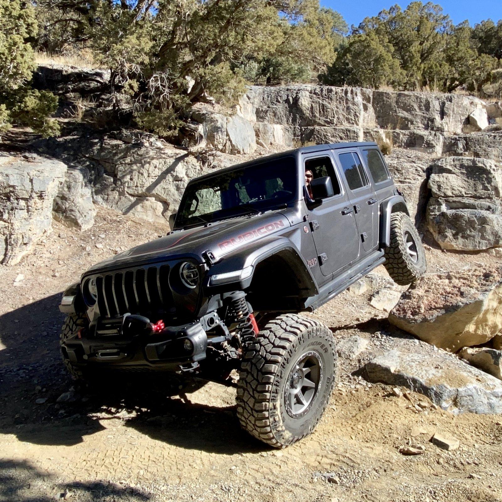

You just described my rig, lol check here to see.......:)
https://www.jlwranglerforums.com/forum/threads/crystal-rubi-build.61821/

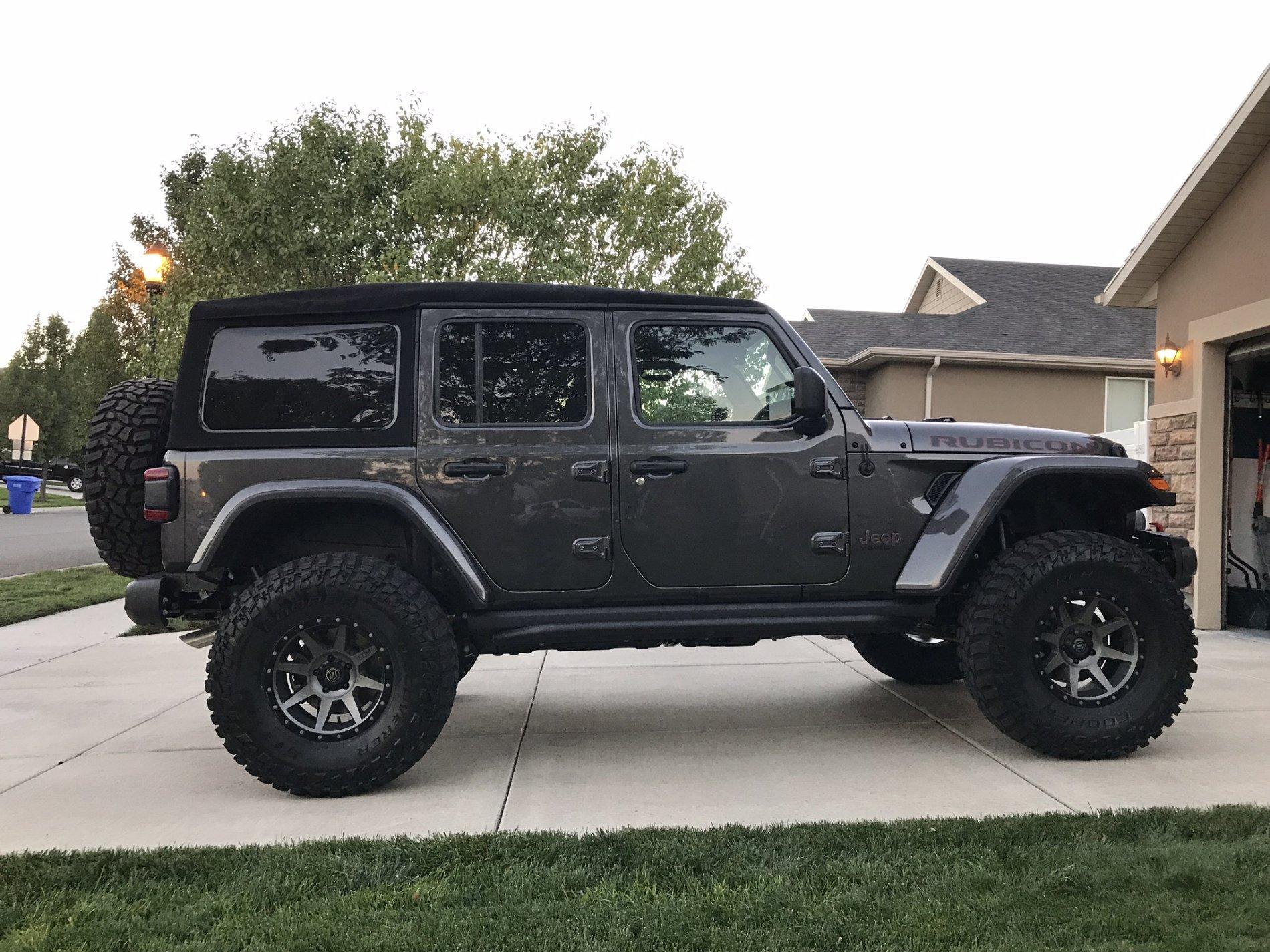

I was just in the garage and realized I can only get by with 37’s and a 3.5” lift (otherwise I would need to air down the tires to get in). Works out perfectly!
In regards to the Boggers I’ve always wanted I realized that they only come in 15” and 16.5” wheel size and that’s why I decided not to go with those for this build (was excited to get some good looking 20” or 22” (at least 18”) wheels for when I hit the grocery store up. Haha!
37’s are awesome had those for the first 30k. You are going to love your new jeep. Here’s mine with 37’s
