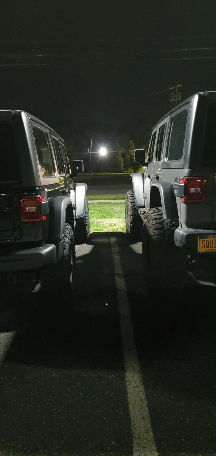

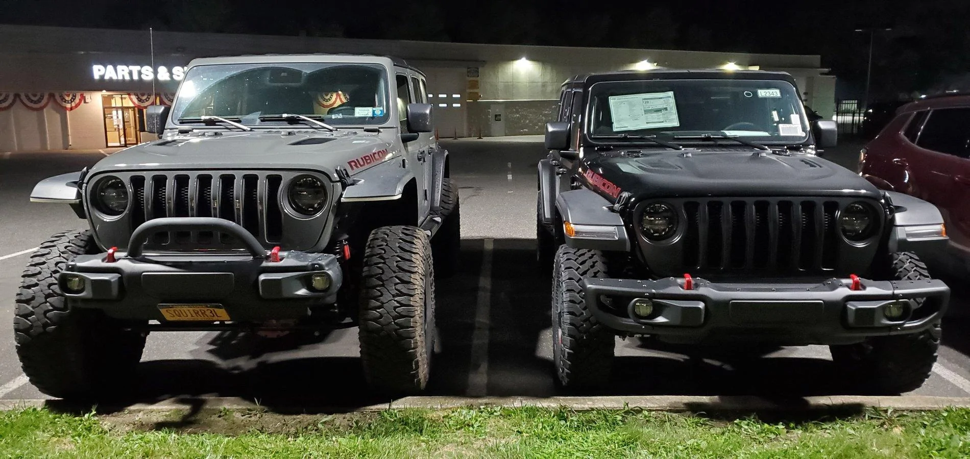

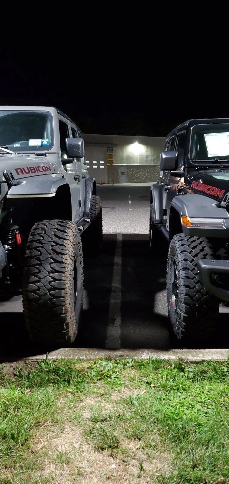

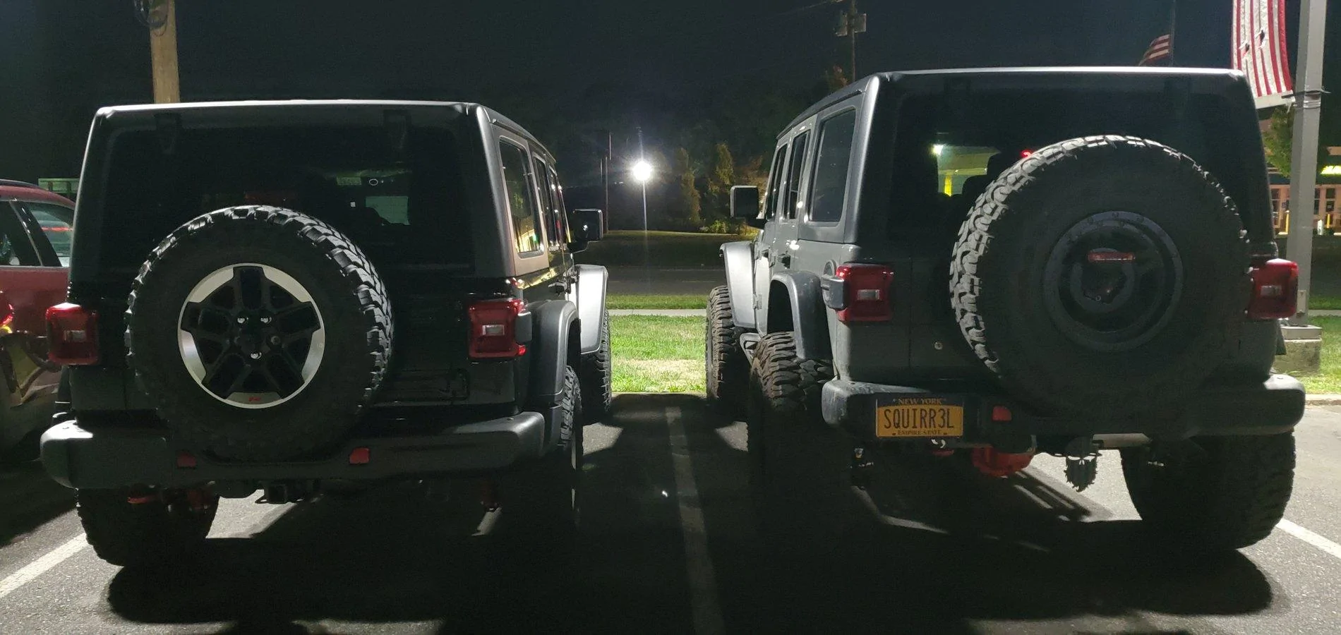

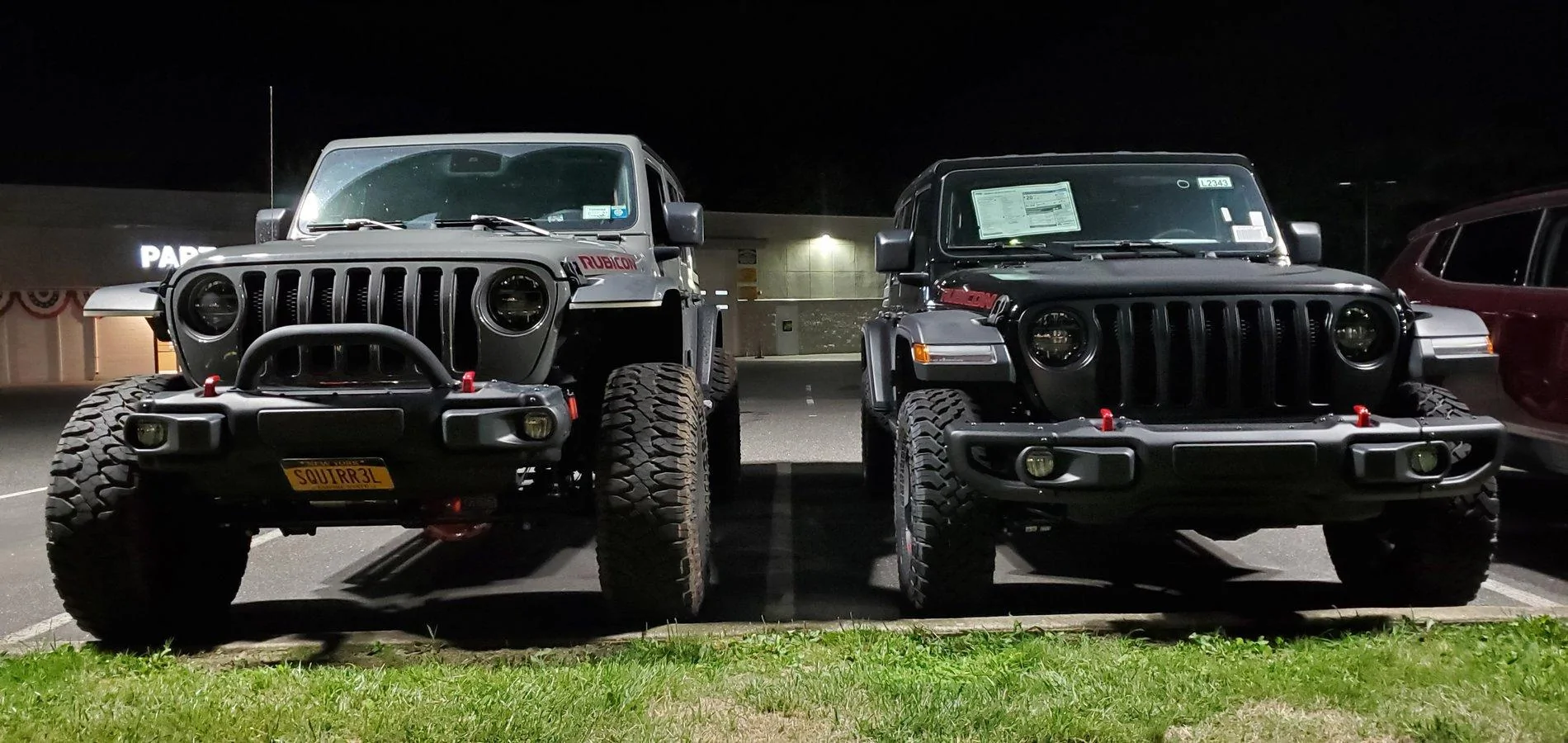

First Rubicon I've seen at a local dealer in quite some time. Spotted it while it for a late night therapy ride, and stopped to take some side by sides.

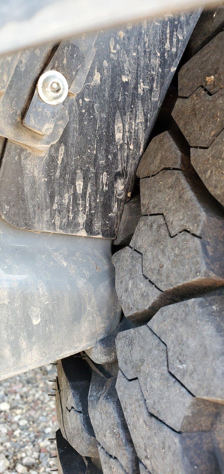

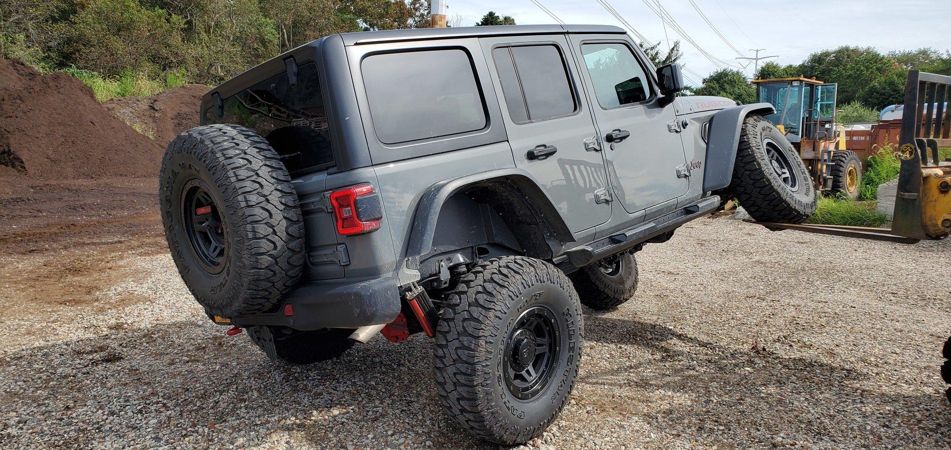

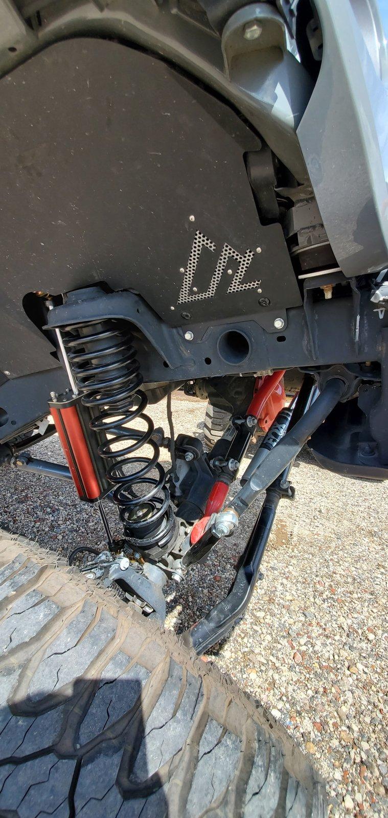

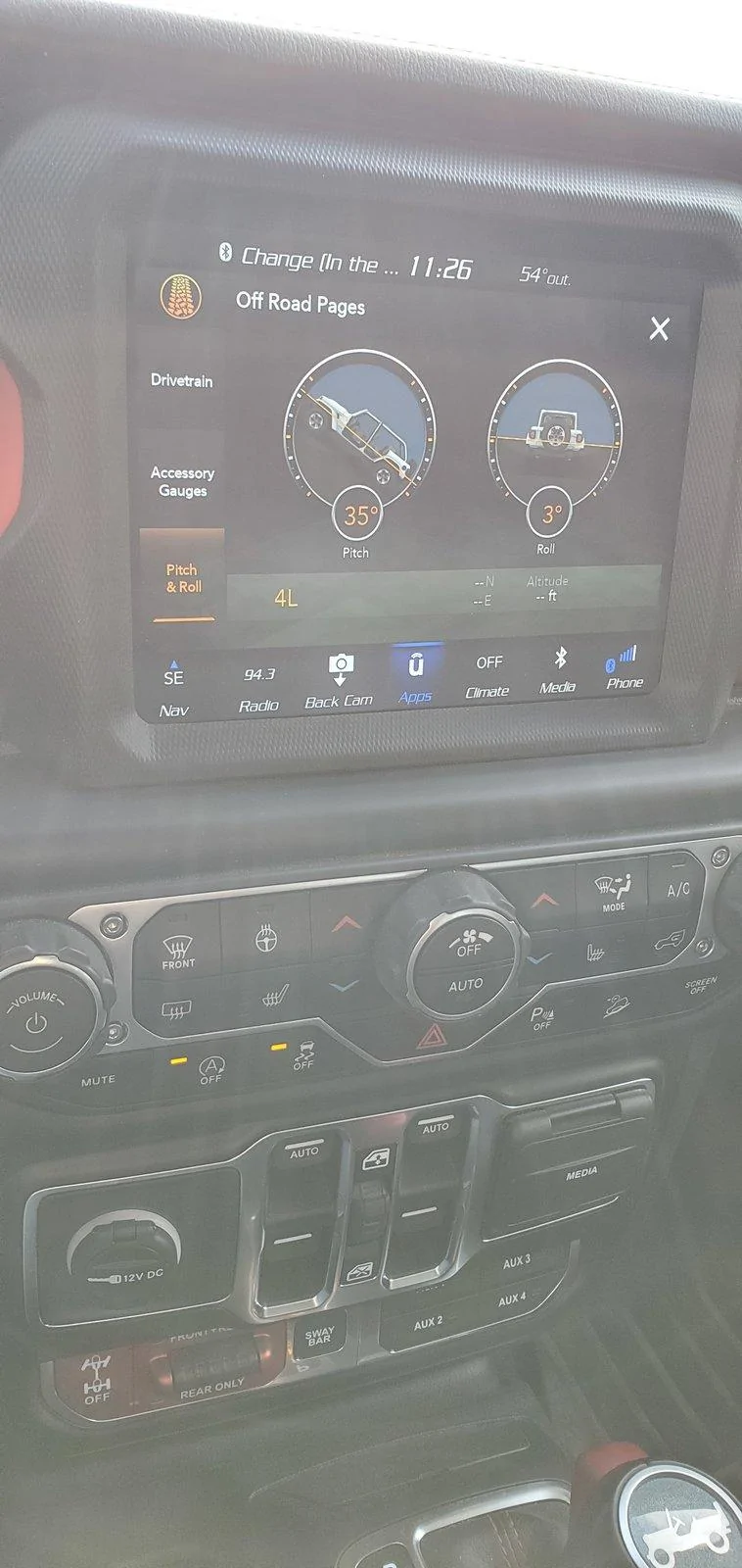

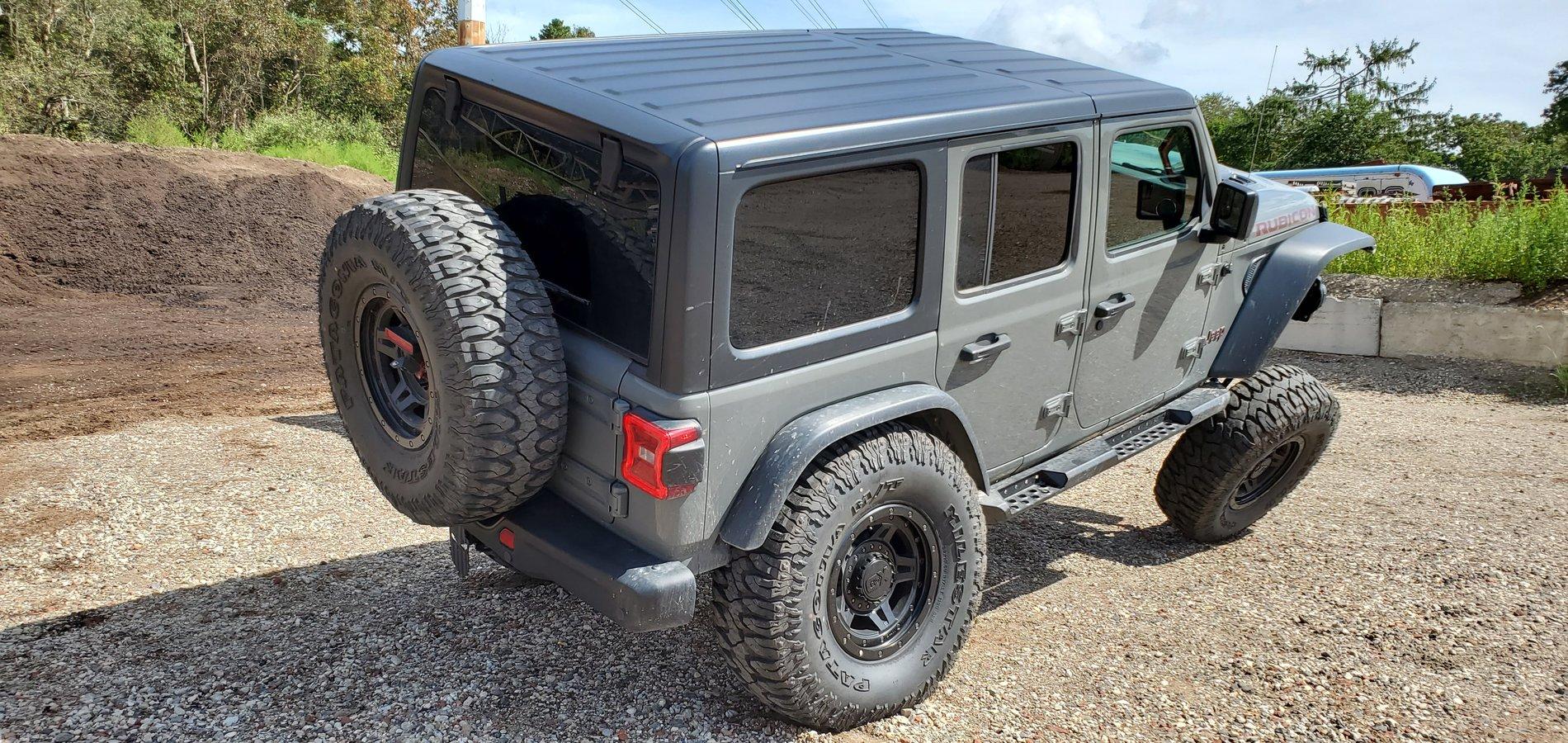

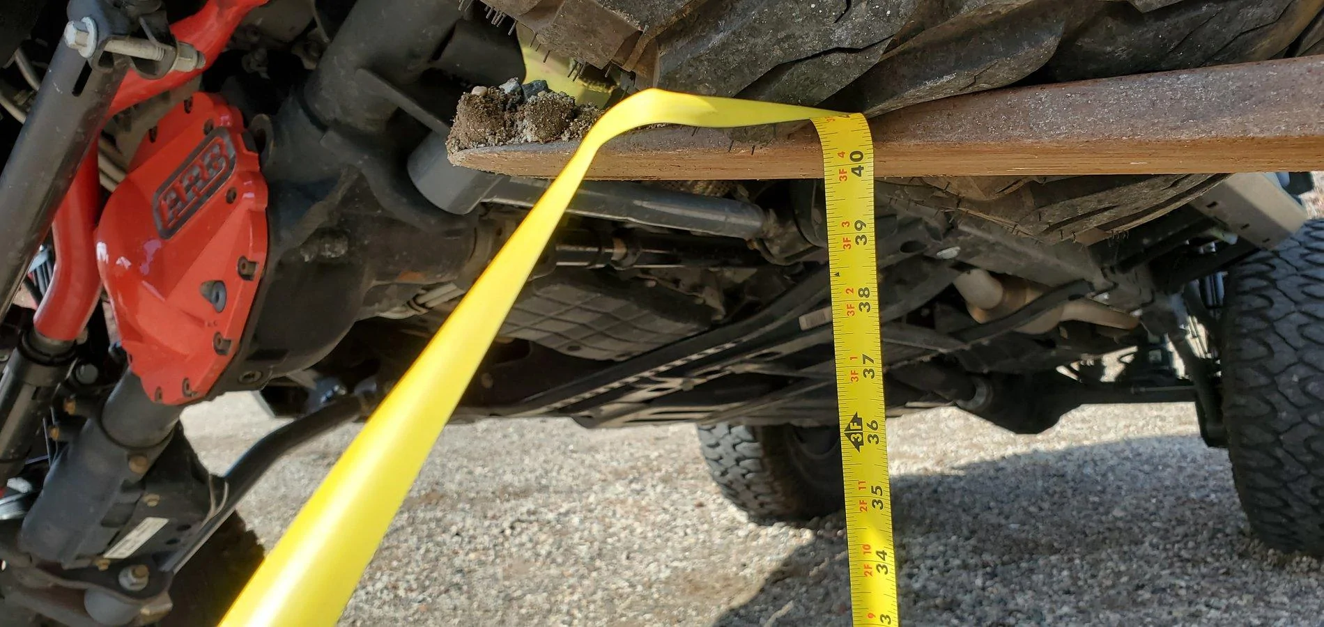

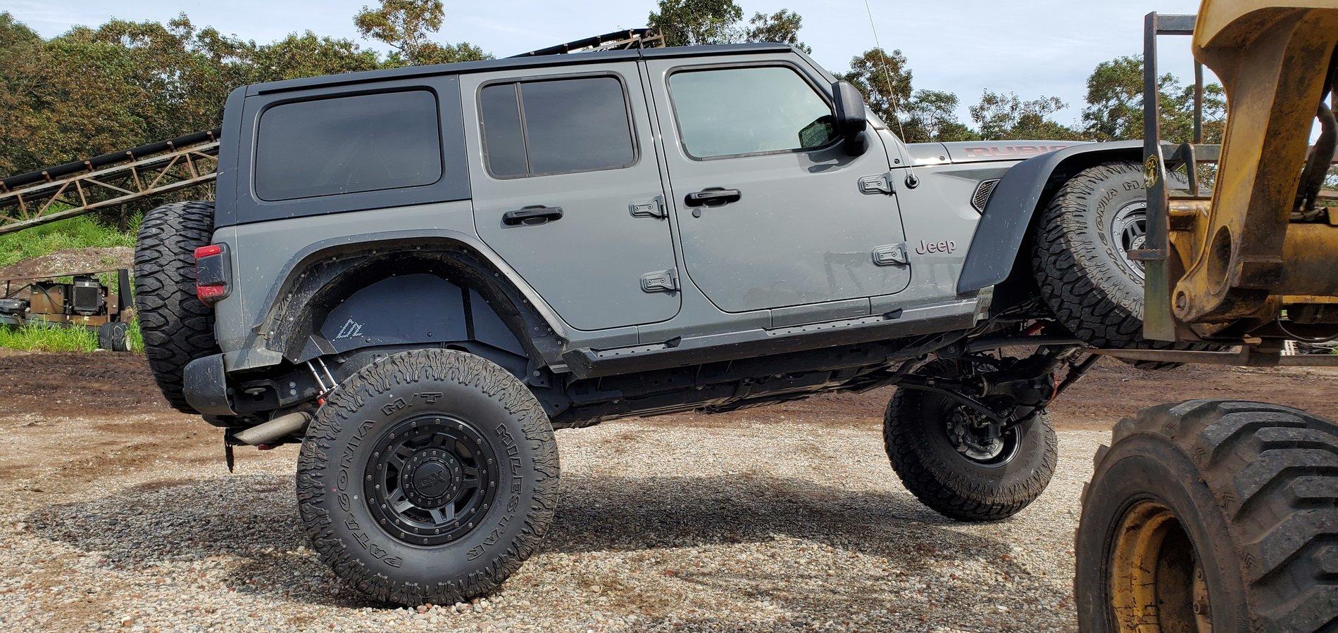

Started flex testing the new 3.5" lift. This is with 2" bump stop spacers all around and at 34psi for the street. I have to add 1 more inch up front, because the springs are starting to drop out of pocket. That will also keep the top dead center of the tire from rubbing the AAL liners. I should be able to turn to full lock without hitting the liners, after adding that inch. Only rub out back with the 2" bump stops, is at the rear pinch seam. I was surprised at how high she went. I couldn't unweight a second tire because the pinch seam was digging hard and the front sway links need to be extended. They were pulled straight. I should be able to get at least another couple inches of tire lift, once the rear can be fully stuffed.
I'll take more detailed pics after adding the front spacers, extending the front sway links, and trimming the pinch seam. I also needed more light under there to come through in the pics.

What am I seeing with the rear fenders? They look repositioned near the rear?
I like that the wheels give a "faux full floater hub" look on the rear axle ;)

Looks great brother........ you should get to at least 42”- 43” once you trim some fat in the rear. I maxed out at 43” before I lifted a wheel. The RK springs are still tight at full extension.
I think it’s the triple rate coils. Although they’re more like a dual rate, I can’t see where the third rate comes in unless it’s the ability to stay seated, lol.

Thanks man! I'm gonna start on those pinch dreams this weekend. It looks like the inner liner will need a tweaking as well. I also need limiting straps for the front, because the springs become fully unweighted and can be spun before the shock hits full extension. After the back gets trimmed, I'll have to see if it will also need straps. These shocks are crazy. They could definitely support a set of 4.5" springs.

Fenders are in the stock location, just chopped. For some reason the body cutout doesn't extend as far back as the fender opening.
The center caps covering the lugs gives the wheel a cleaner look. Plus, it's another time soaker to any would-be thieves.

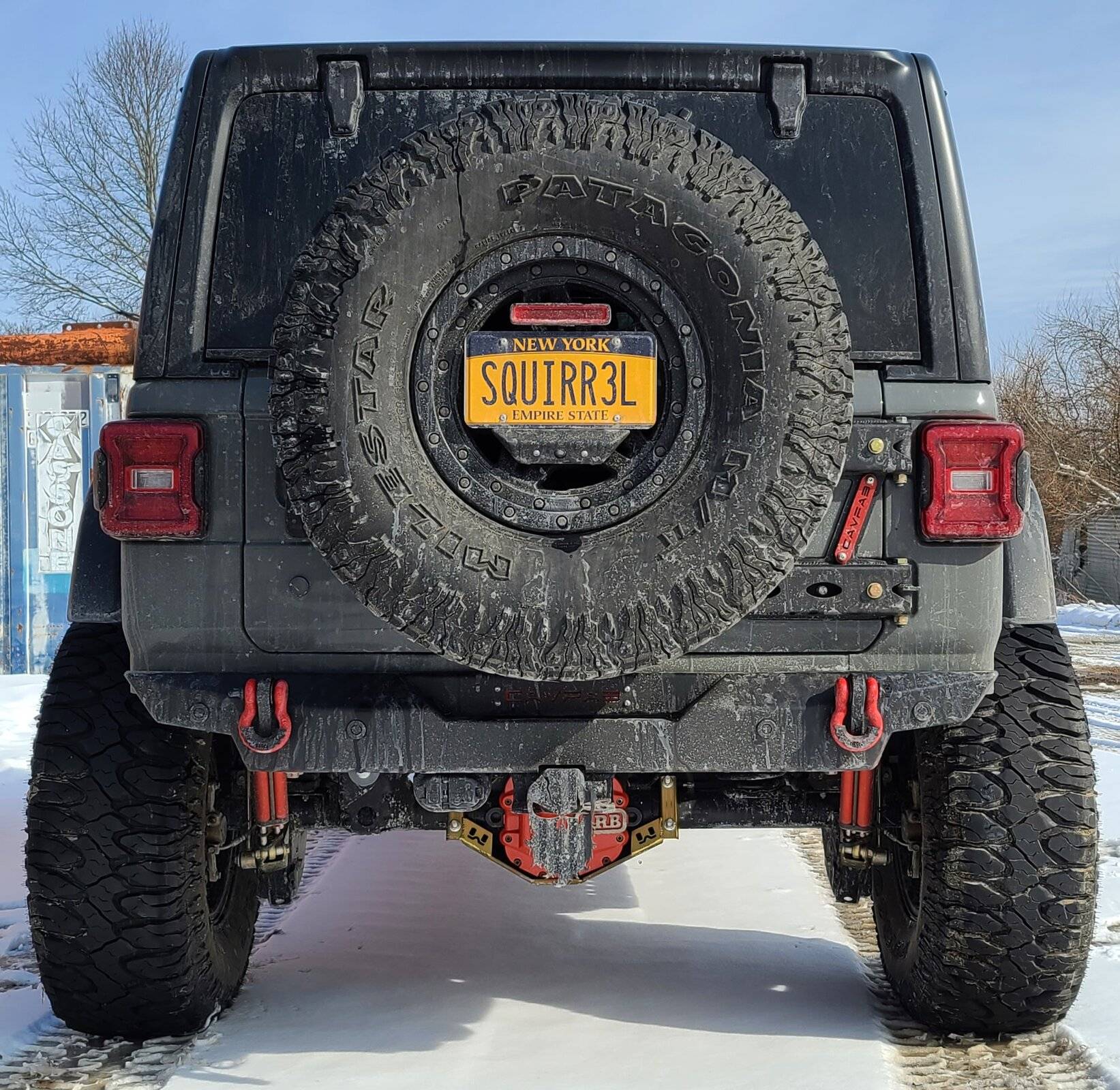

Finally making some more pushes over the last couple months:
- Got rid of the factory "trash can" and went with the Borla Touring Climber cat-back for added clearance, some weight loss, and a tasteful growl for the 2.0 turbo.

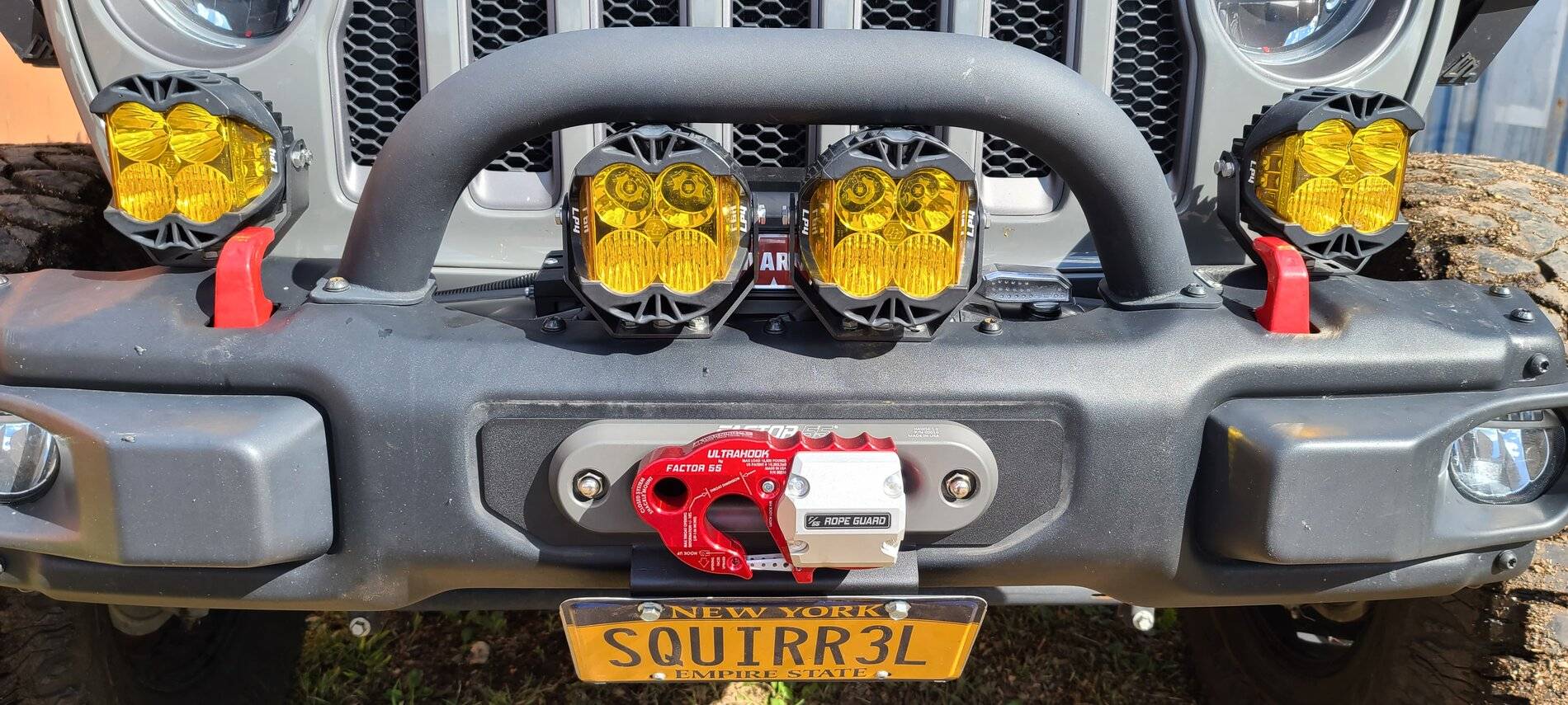

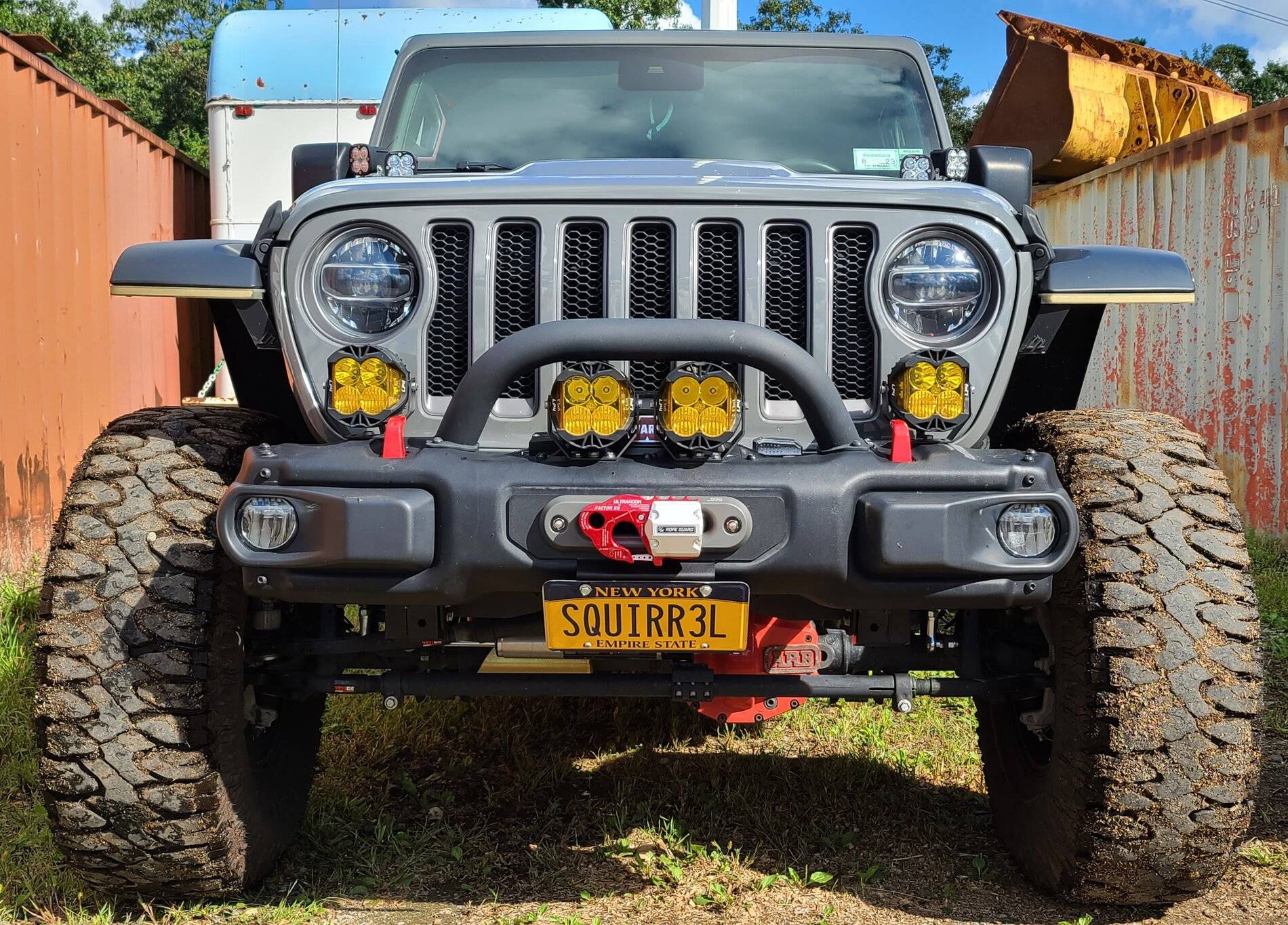

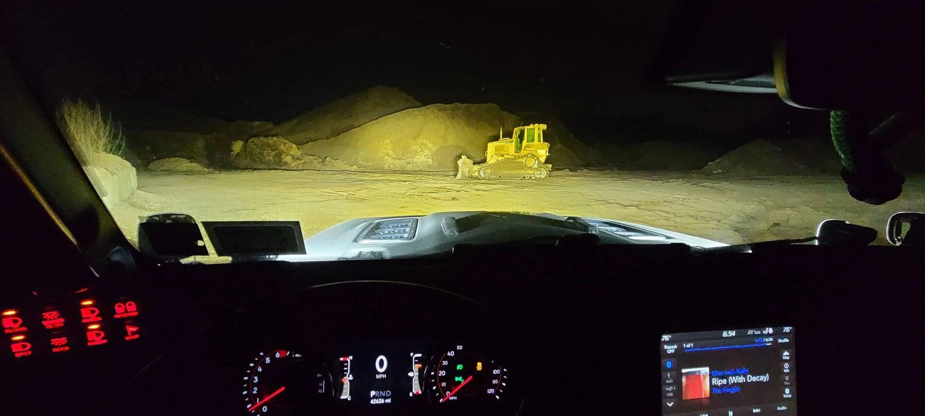

- Baja Designs amber LP4 Pros on the front bumper and a pair each of spot and flood Squadron Pros on the a-pillars.

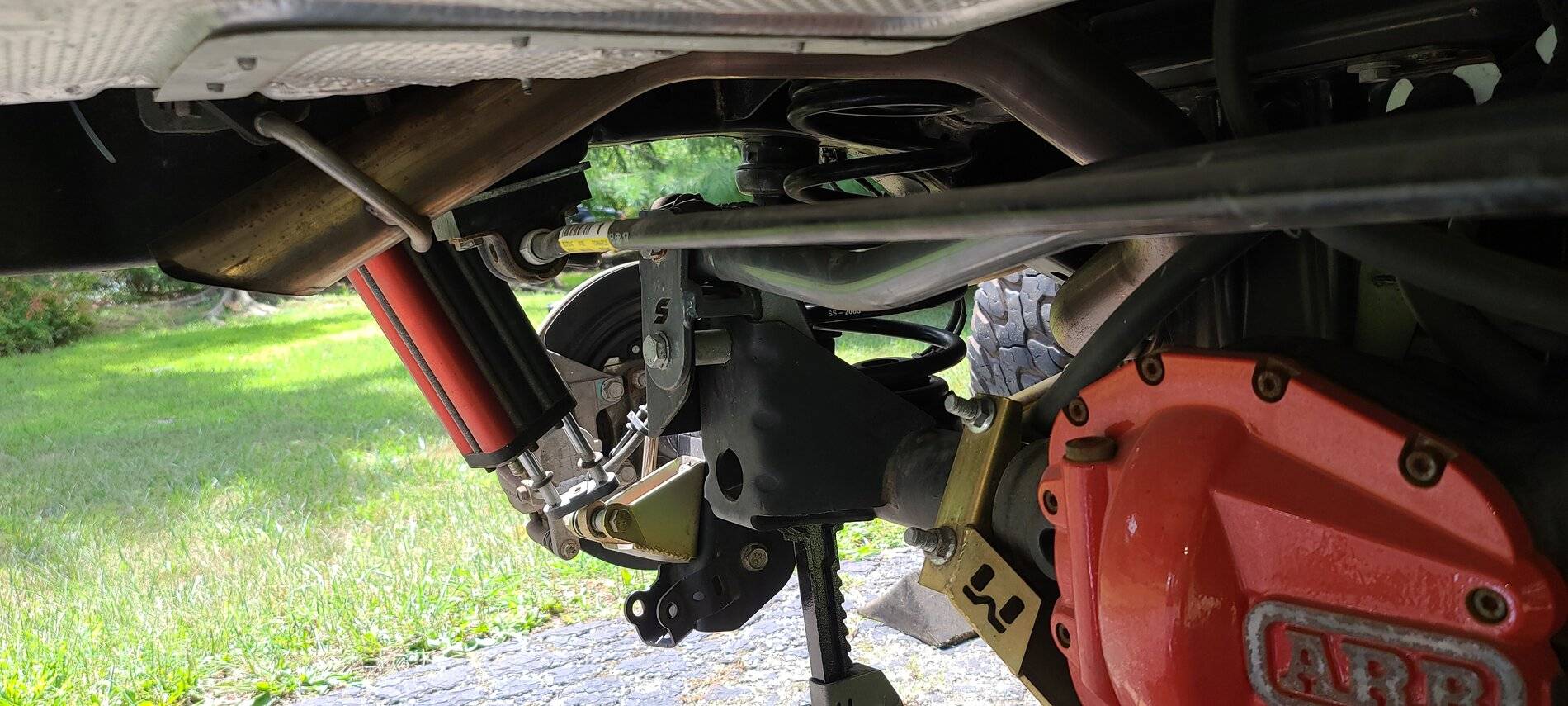

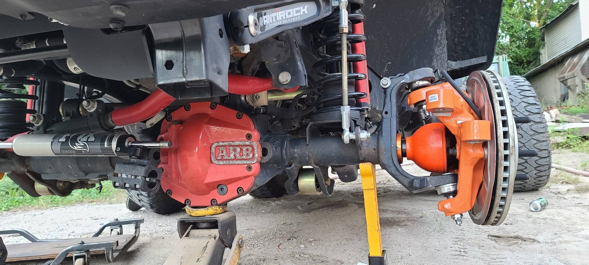

- The factory rear sway bar was hitting the bottom of the frame and the extended front links weren't long enough, so I went Antirock front and rear. Was able to ditch the lower front bumper skid along with the edisconnect sway motor, and used the tazer to avoid warnings from the sway motor being unplugged. That helped shed some weight to offset what I've added.

- Added a Warn Zeon 12s, mounting plate, and shut-off solenoid. Finished it off with a Factor55 Ultrahook and 1" fairlead. Side note: I'm hearing that Warn now owns Factor55.

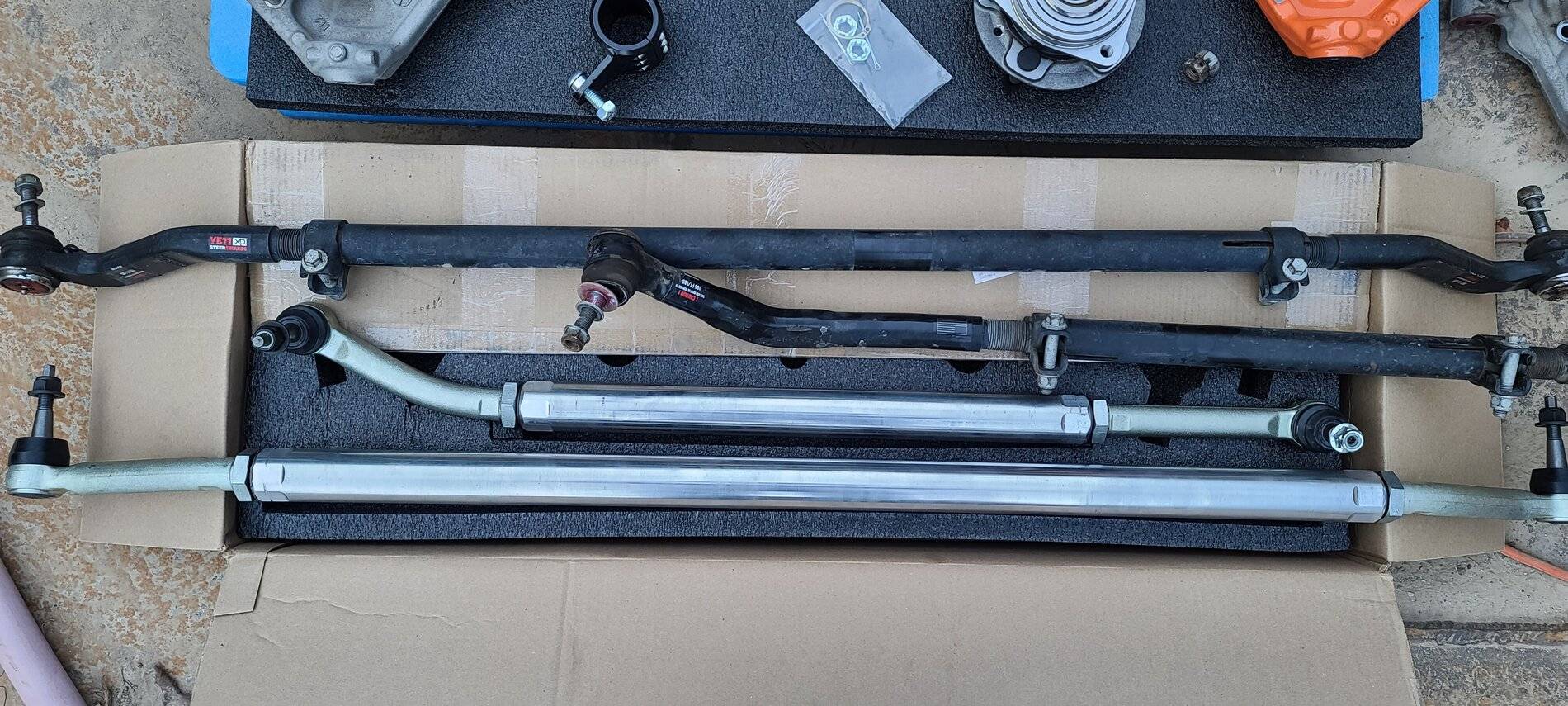

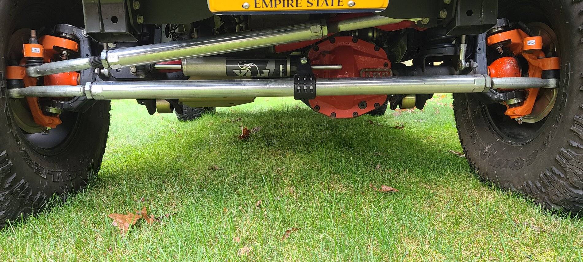

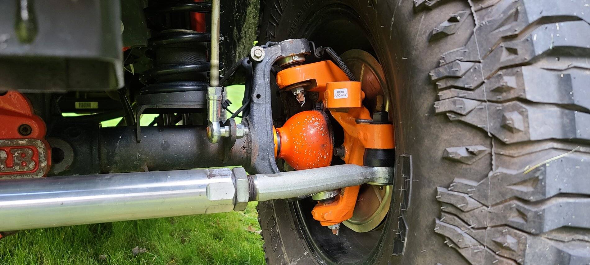

- A couple Saturdays back was a very long day. My buddy showed up to help by drinking beers and making it too easy for me to take too many breaks. I installed RCV axle shafts and outer housing seals, Reid Racing knuckles, Dynatrac HD ball joints, Moog hub assemblies, and RPM Performance 2.5 ton 2" aluminum tie rod and drag link along with a new clamp to mount the Fox TS stabilizer to the larger tie rod. I also wanted to add the SteerSmarts front track bar frame reinforcement and the Metalcloak front and rear track bars that have been sitting around, but it was already 4am by the time everything else was done and I still had a 50 mile ride home. Those will go on soon.
Jeep Wrangler JL The Road So Far... 20211002_104638
Jeep Wrangler JL The Road So Far... 20211002_104828
Jeep Wrangler JL The Road So Far... 20211002_105221
Jeep Wrangler JL The Road So Far... 20211002_174005
Jeep Wrangler JL The Road So Far... 20211013_132453
Jeep Wrangler JL The Road So Far... 20211013_132518
Jeep Wrangler JL The Road So Far... 20211013_132423
Jeep Wrangler JL The Road So Far... 20211013_132700
I previously had the SteerSmarts tie rod and drag link, which were great, but clocking all the various adjustment clamps to not hit anything was becoming tedious. The Metalcloak articulation is ridiculous and things hit that you'd previously think would never be an issue.

How long have you had that rpm steering on the shelf? They changed all their joints to apex designs
At least a few upwards of several months now. I thought I've recently seen some aluminum linkages that are blacked out. Is that the apex joints? What's the difference, if you don't mind feeding my curiosity?
