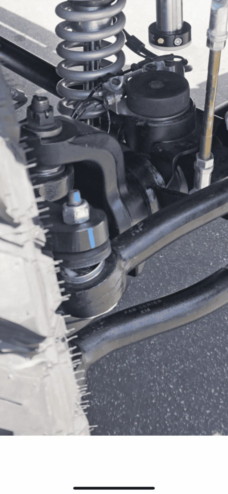

At least a few upwards of several months now. I thought I've recently seen some aluminum linkages that are blacked out. Is that the apex joints? What's the difference, if you don't mind feeding my curiosity?
The apex ends are black yeah, as far as difference i know they are a bit shorter and the knuckle end draglink has antiflop built into it. I saw the ends at the expo on sunday, they are really well built. And the apex guys are cool people. I dont know what brand or where the other ends you have on yours are from but i know they dont have anti flop, my cousin had the same ends on his.
Yeah, sorry, meant the ends not the bar. I can't recall the source of the ends, but they are the same as what Doetsch, Rusty’s, and others use. They are 1.25" forged. Maybe it's just a color difference?
I do like the idea of the antiflop on the drag link at the knuckle like you said. I had thought about robbing one from the tie rod when I was assembling, but decided to keep the tie rod balanced. Didn't want to experiment.
I'll have to look into getting my hands on the antiflop bushing to add to mine. Thanks for pointing that out! Seeing it flopped forward has been making my eye twitch. ?
Dont put the antiflop bushing on the knuckle end, it will put too much pressure on the joint on high articulation.
Jeep Wrangler JL The Road So Far... 0EB089E9-6737-4342-B229-8AE63A542DCA
It dont work very well lol. Someone did it on this one, different end, but same antiflop bushing
Ok, so I wasn't overthinking that. I was looking at the picture of mine and the drag link is already slightly pointed up at normal ride height. The rpm product page says antiflop excludes the pitman arm tre. I have to look at that side tomorrow.

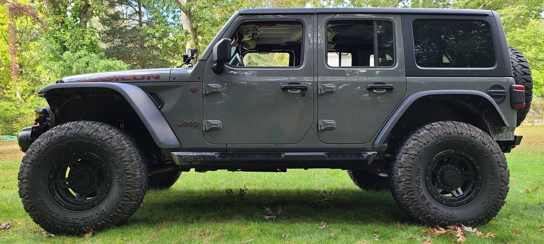

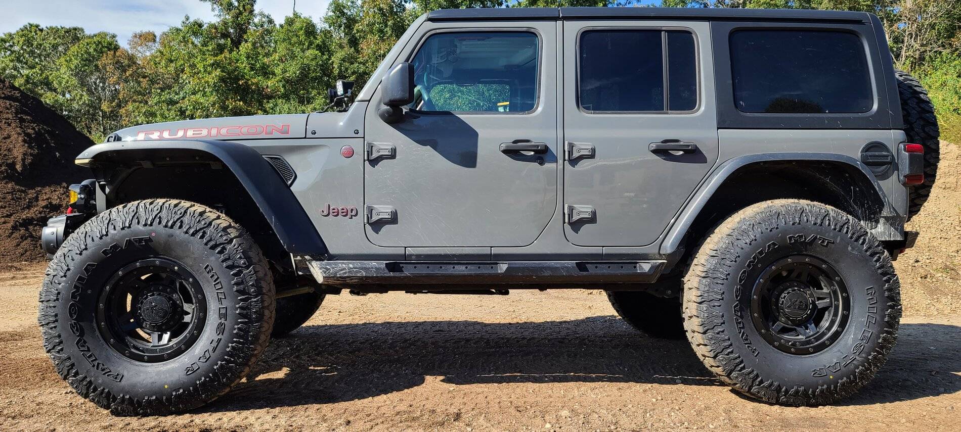

Swapped the 38's for a set of 40's today. It still has a lot of pep off the line and when passing on the highway and sees 8th with ease. But it does drop to 7th quicker than with the 38's. A regear wasn't even hitting the radar before, but it is now a blip on the due of the screen now. 4.88's may be in my future. But that's splitting hairs. It feels great!

I look forward to seeing my 4'10.75" wife climb up for the 1st time. I just walked her out to her car to head to work, and it looked like she can now walk right under the side view mirror.
Damn that looks great. They look mean on there. You keep making it taller and wife might be ordering you some RSEs for Xmas lol.
