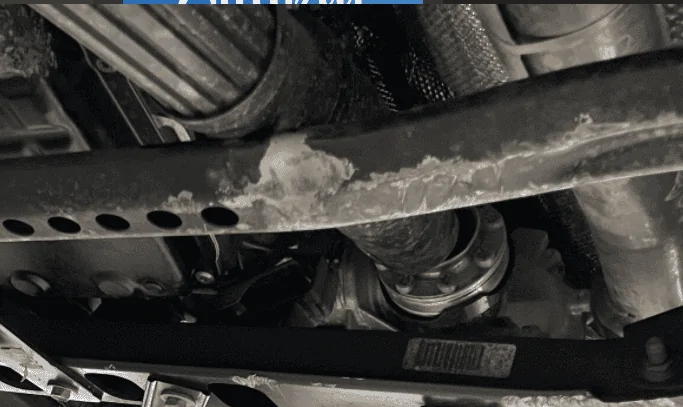

Driveshaft moves downward with the front axle. The driveshaft to trans skid bar clearance is actually a limiting factor in the amount of droop you can achieve.
That said, the stock skid bar definitely has saved my stock driveshaft. This hit bent the bar up about an inch in addition to the dent.
Holy crap, glad it saved it then. I figured it was moving but didn't know if they could put a plate there at the bottom end.

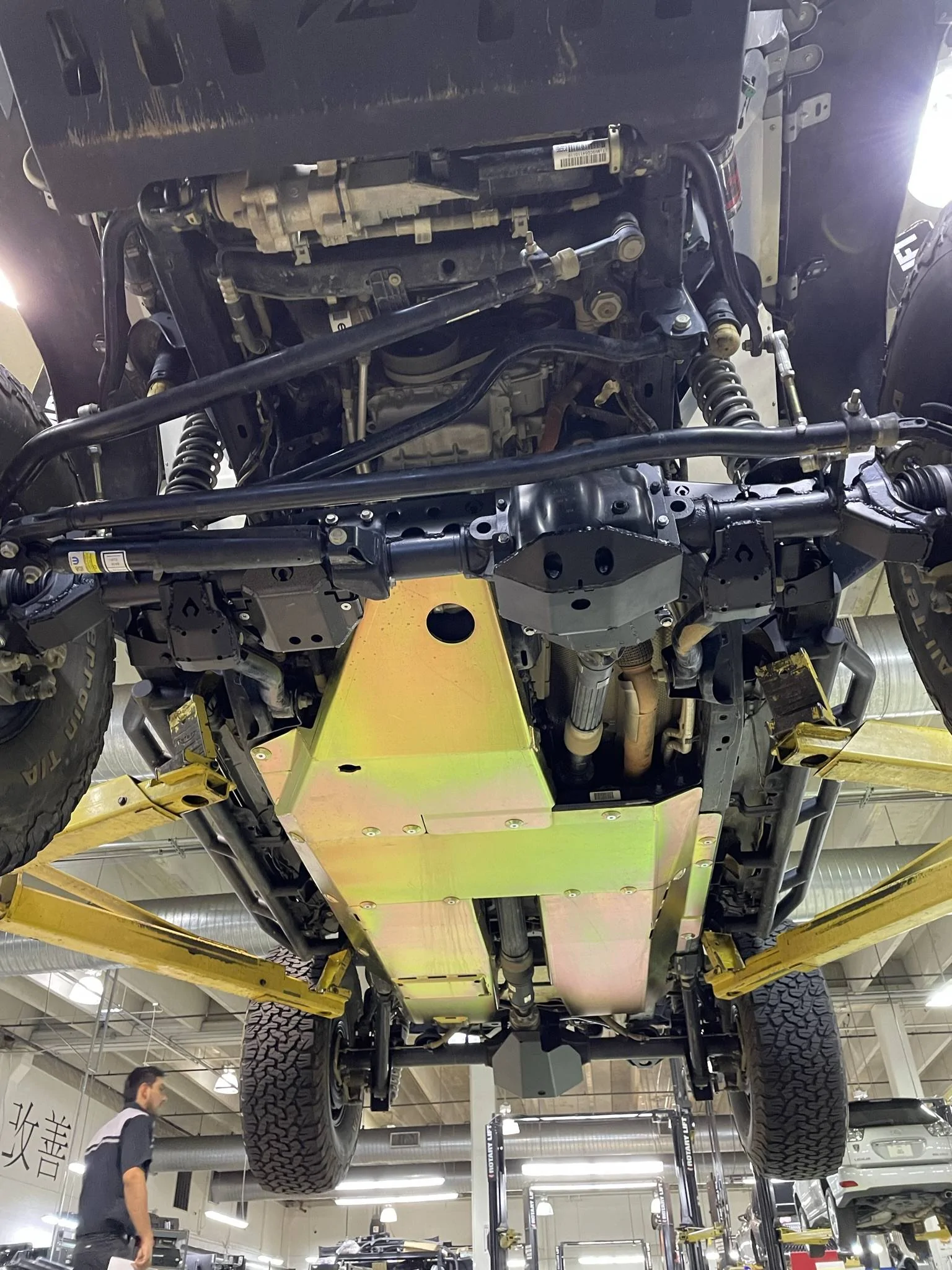

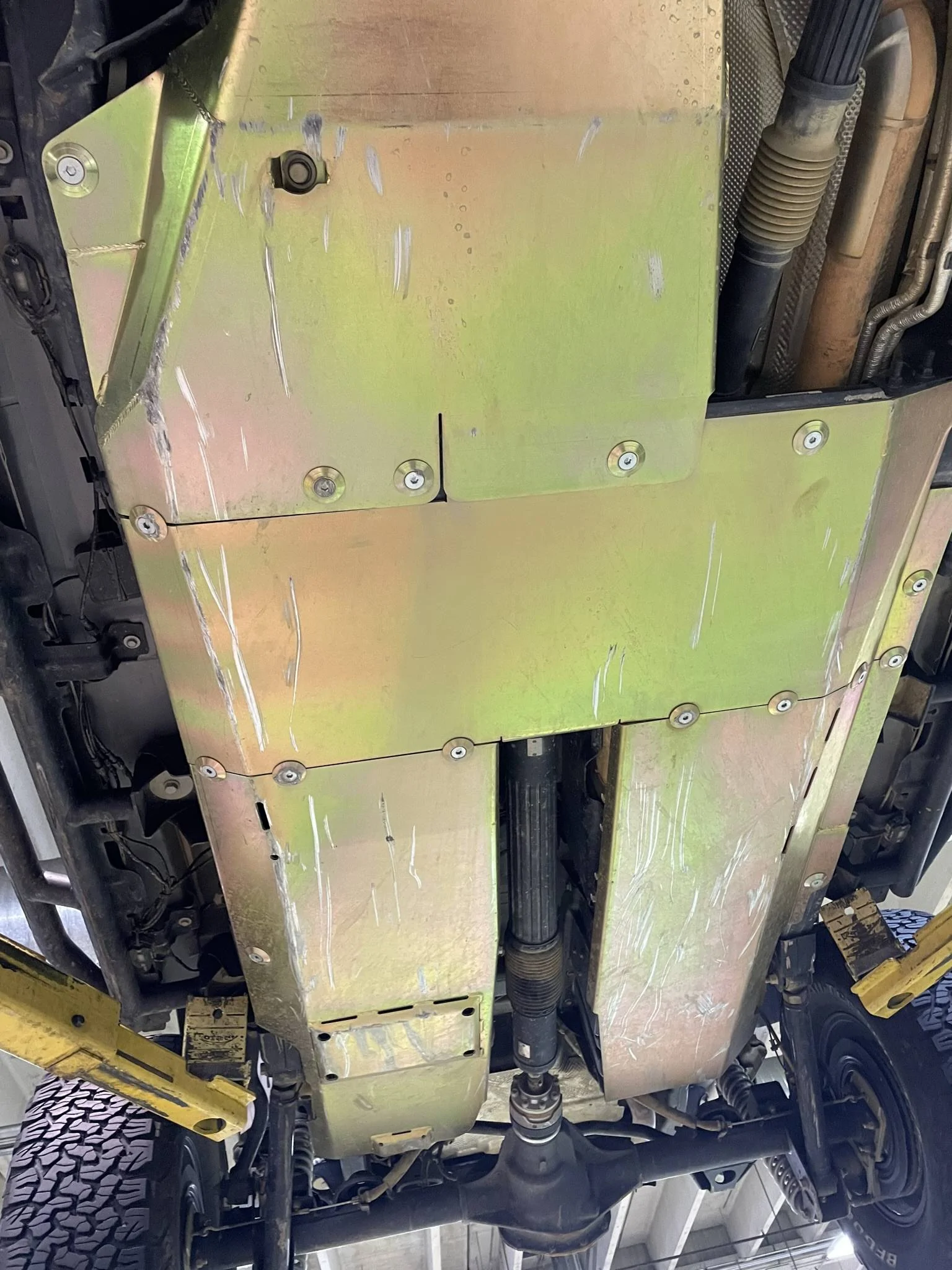

I can’t say enough good things about the metalcloak undercloak skids. They take a beating and cover a lot.
Jeep Wrangler JL Looking for advice on skid plates 79669DBA-C2B8-40D8-82FD-3A412C9CB6D8
Jeep Wrangler JL Looking for advice on skid plates 1EC483CA-3205-46D6-873F-18DE5D6B55E5
