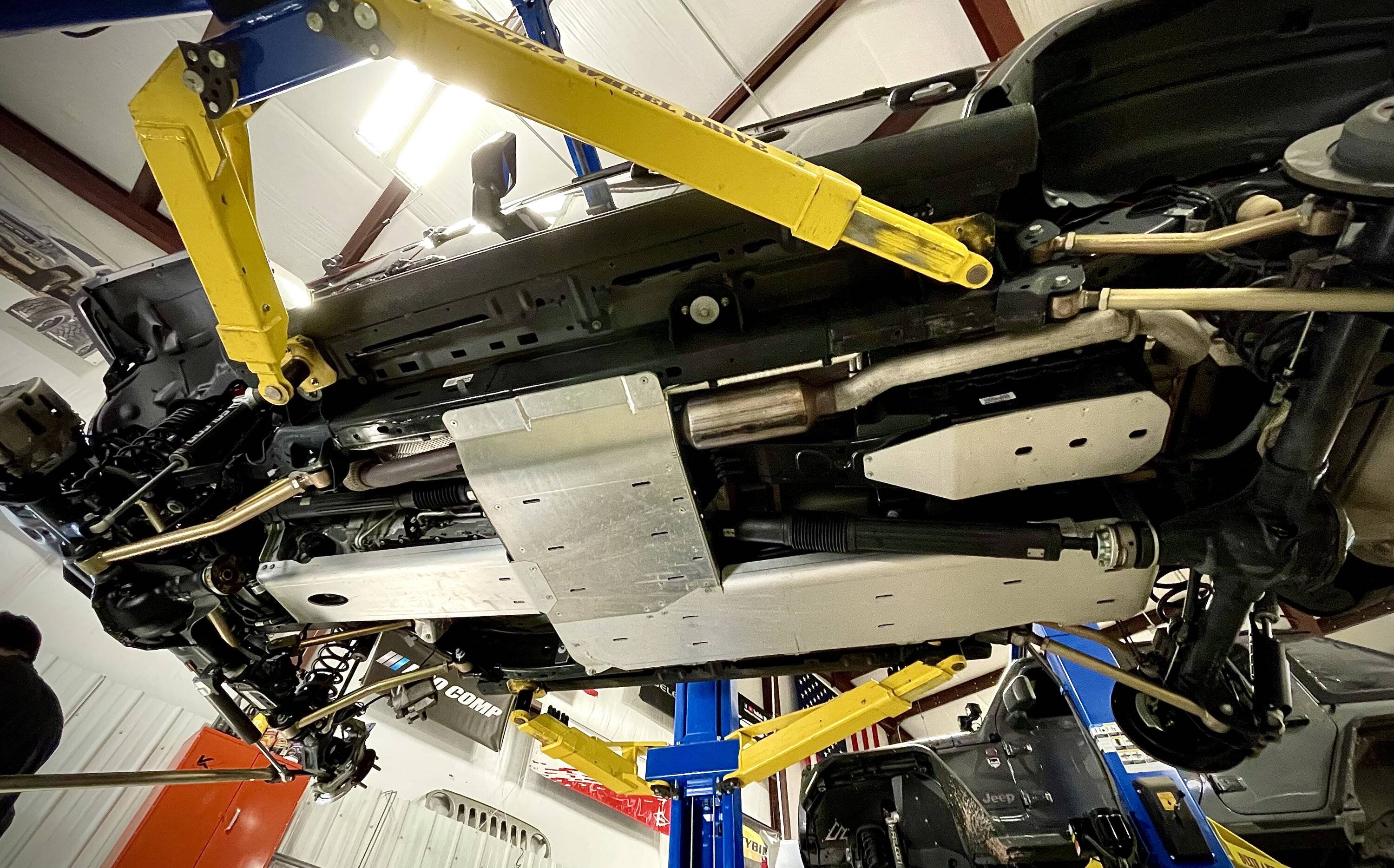

Artec Aluminum. Light weight and you'll actually gain about 3/4" of clearance compared to the factory skids.
Jeep Wrangler JL Looking for advice on skid plates Artec Skids
-Steven
