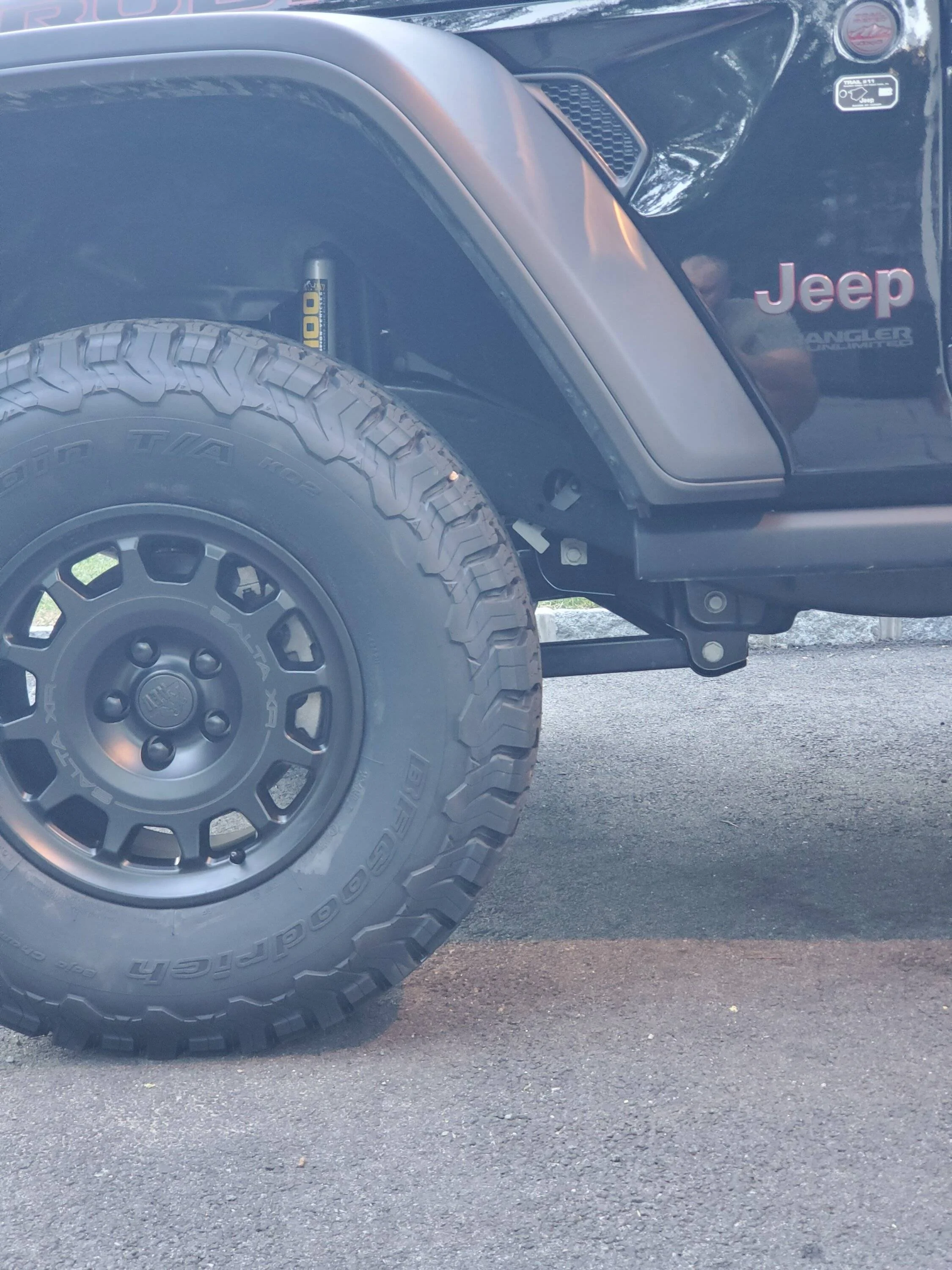

I was in the same boat as you about a year ago.
My JLUR is my daily driver and I overland, offroad around 6x a year.
I ended up with the AEV 2.5RT lift for ease of maintenance, load capacity, on road manners and ability to do my target level trails (ie no hard rock crawling)
Here's a pic of my front lca with the AEV drop bracket. Pretty parallel and this lift netted 3.5inches
Jeep Wrangler JL Long Arm vs Geometry Brackets 20220812_192137
For me it checks all those boxes.
Either way, good luck with your decision and keep us posted.
