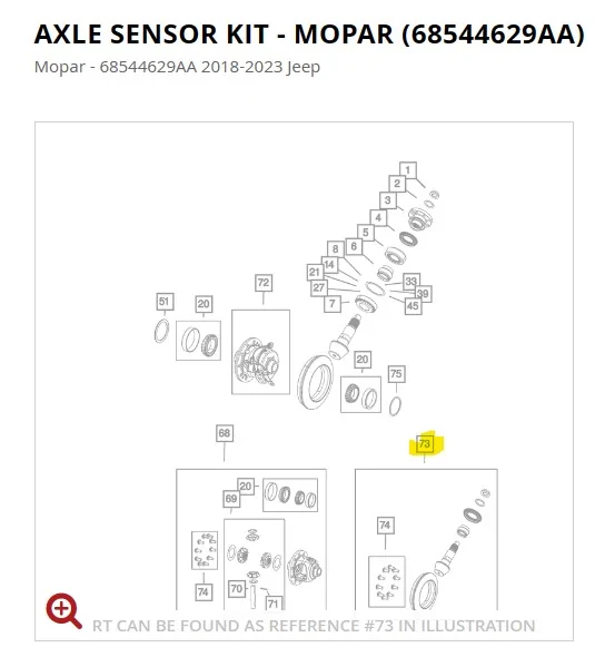

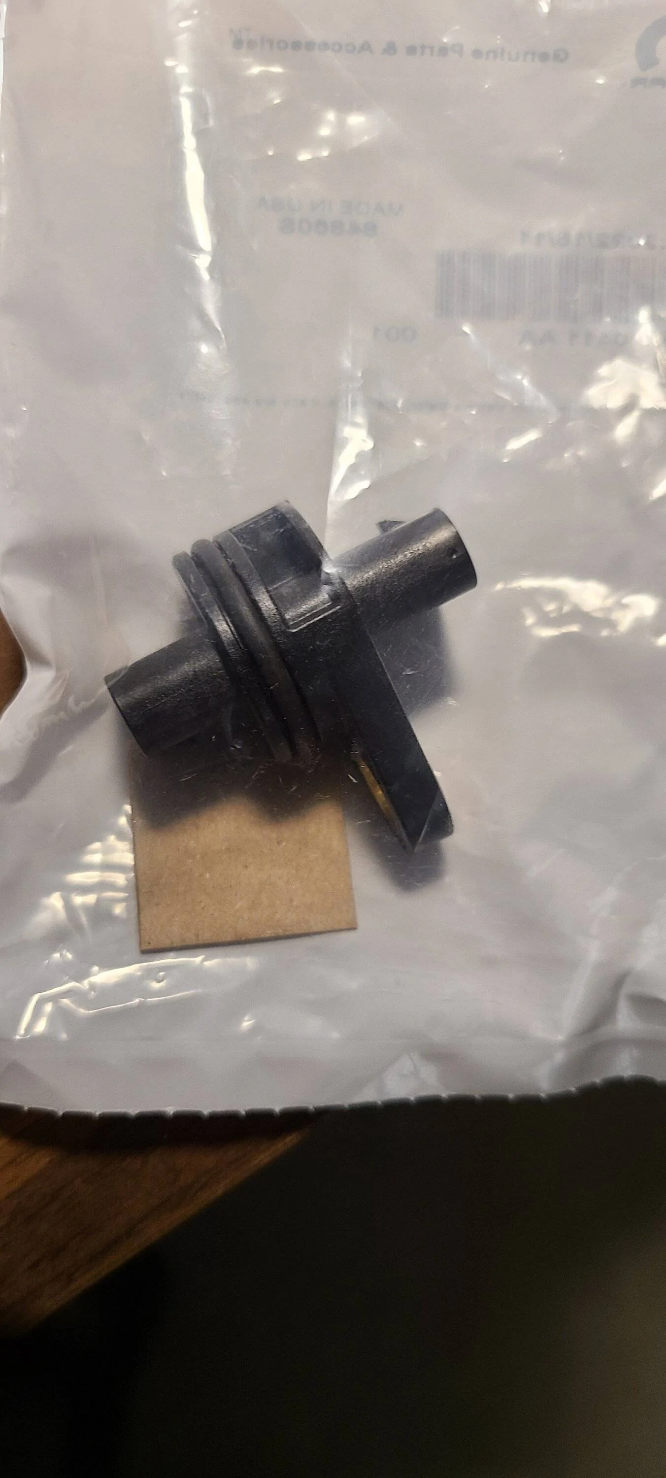

Greeting everyone, just trying to be pro-active since I haven't taken delivery of my 24 Willys I ordered. But when I searched the MOPAR web site for these Locking Position Sensors I got something that appears to be significantly different from OP's pictures. Did they change the format or did I just look up the wrong part number? Thanks
Locker position sensors are a Rubicon only part. Unless Jeep is putting electronic selectable lockers in Willys now.

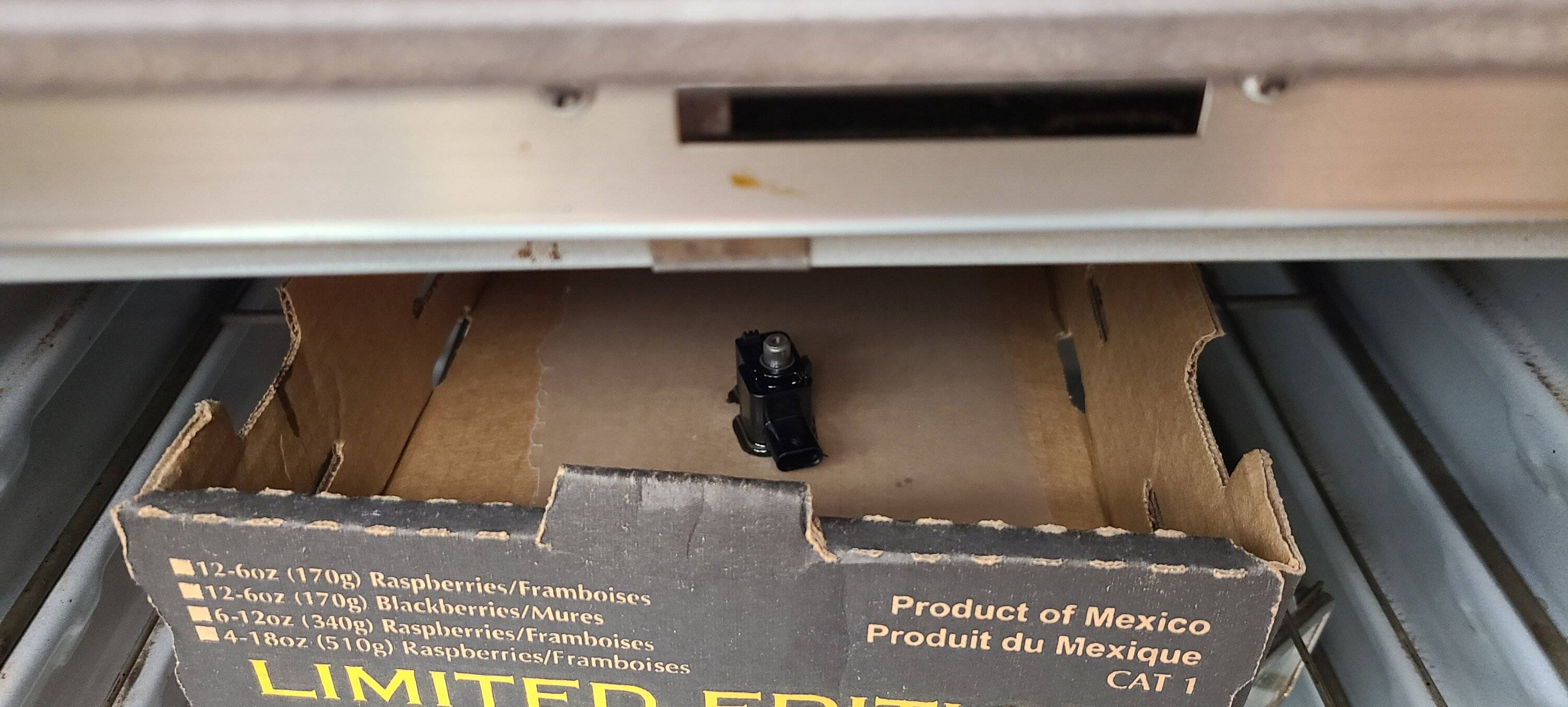

Jeep Wrangler JL Locker Position Sensor Potting - DANA 44 20230512_142724
So I remove the whole cap.

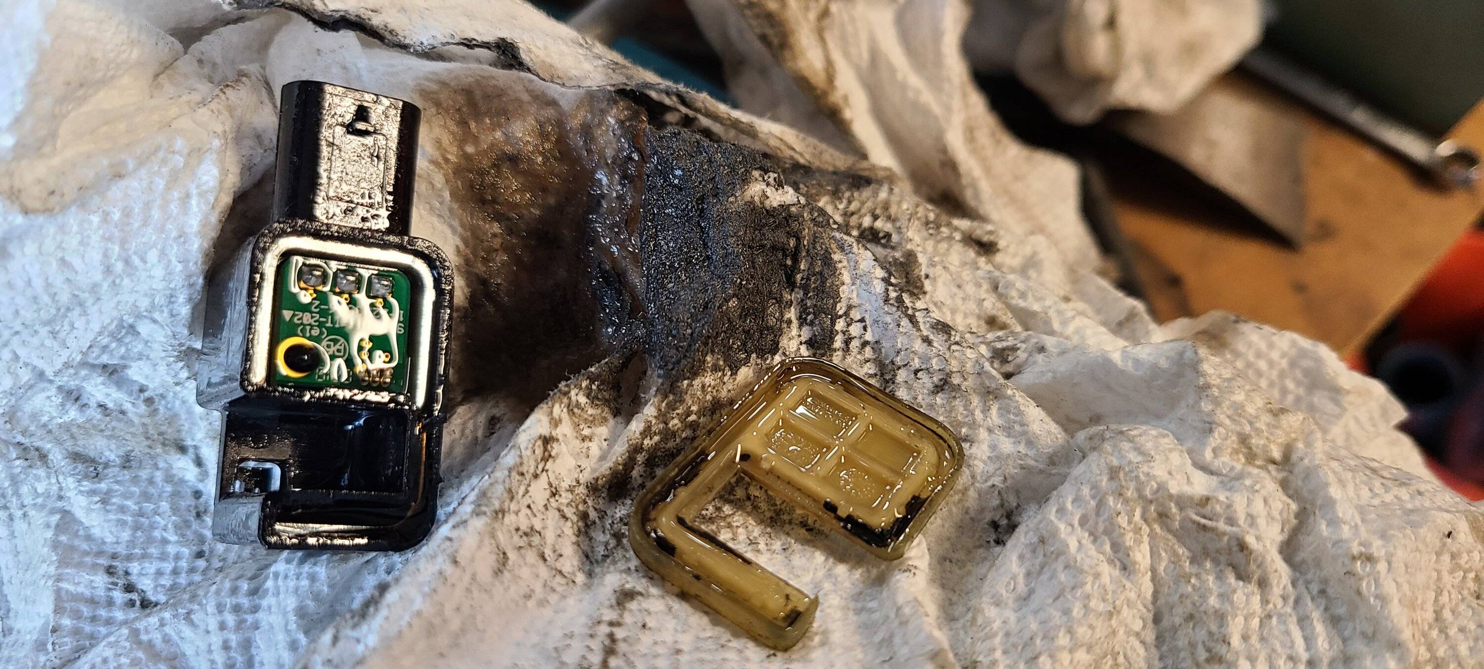

Jeep Wrangler JL Locker Position Sensor Potting - DANA 44 20230512_155410
Then hosed it out.

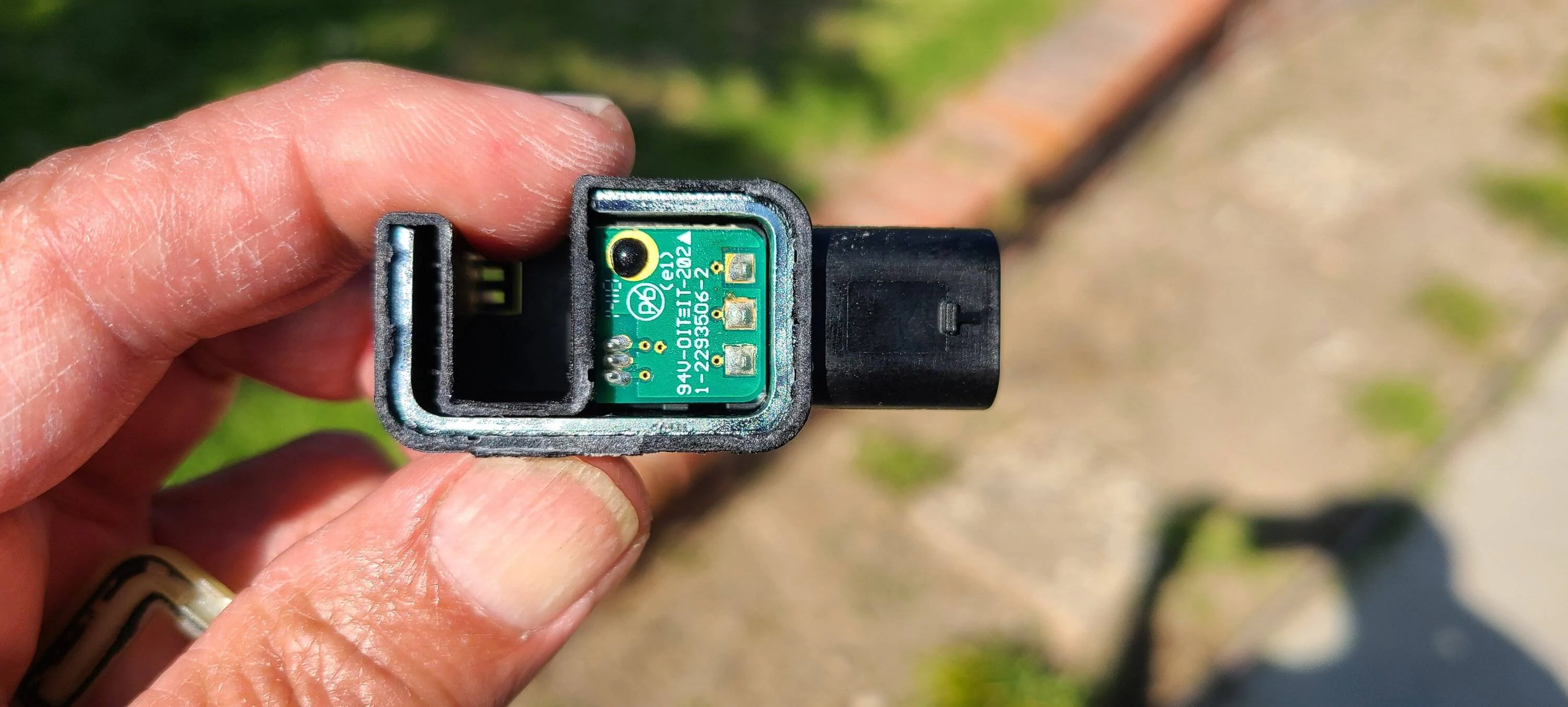

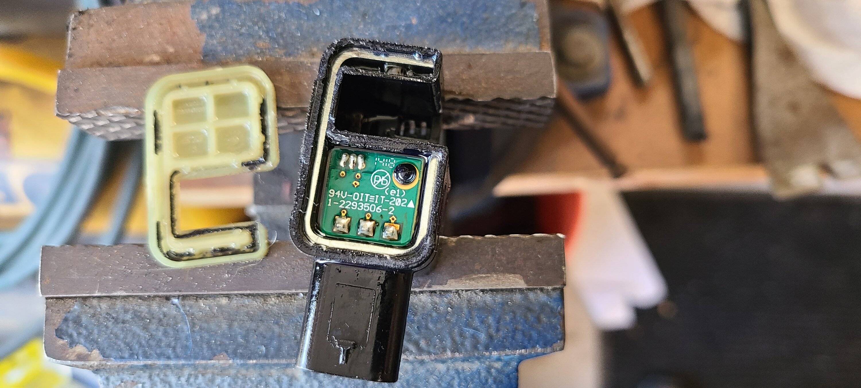

Jeep Wrangler JL Locker Position Sensor Potting - DANA 44 20230512_160315
Jeep Wrangler JL Locker Position Sensor Potting - DANA 44 20230512_154505
Jeep Wrangler JL Locker Position Sensor Potting - DANA 44 20230512_160437

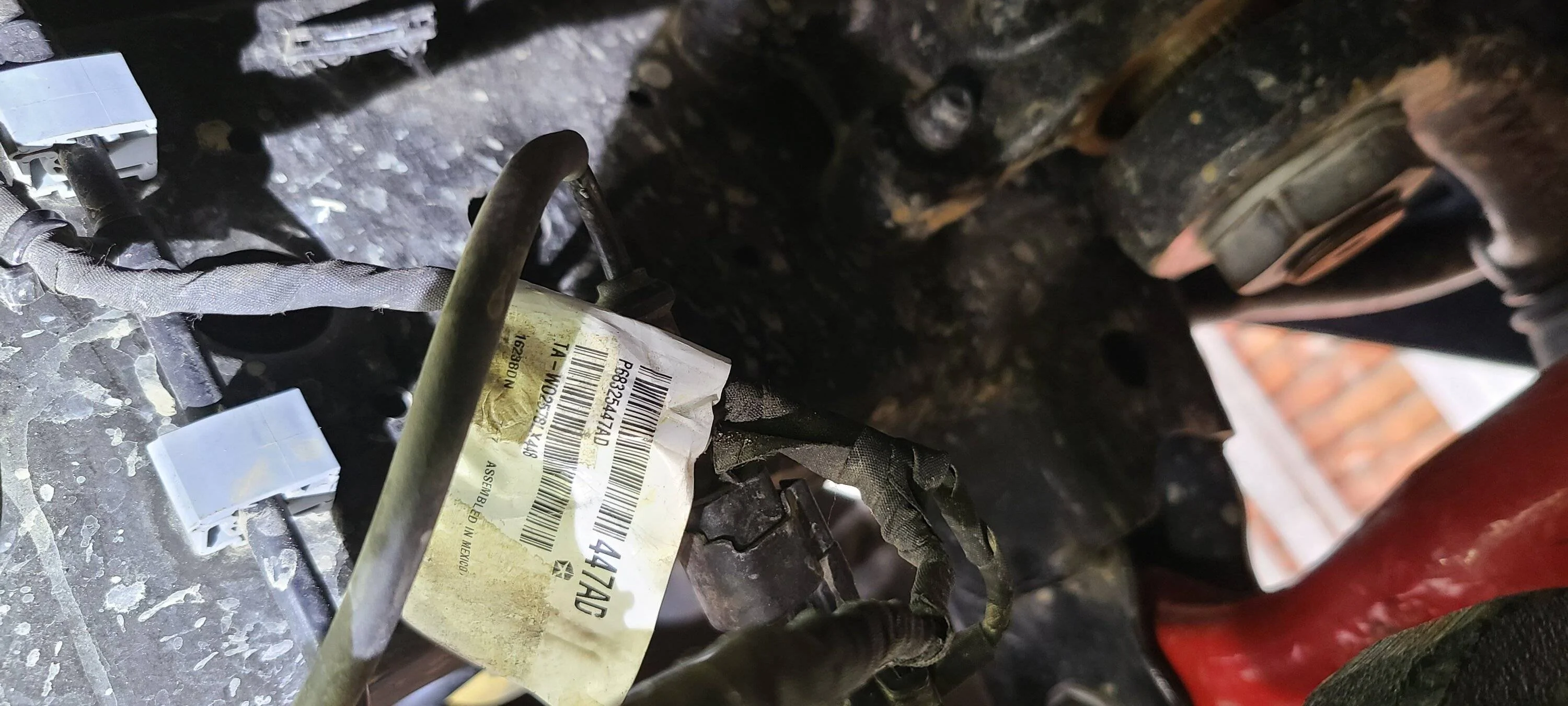

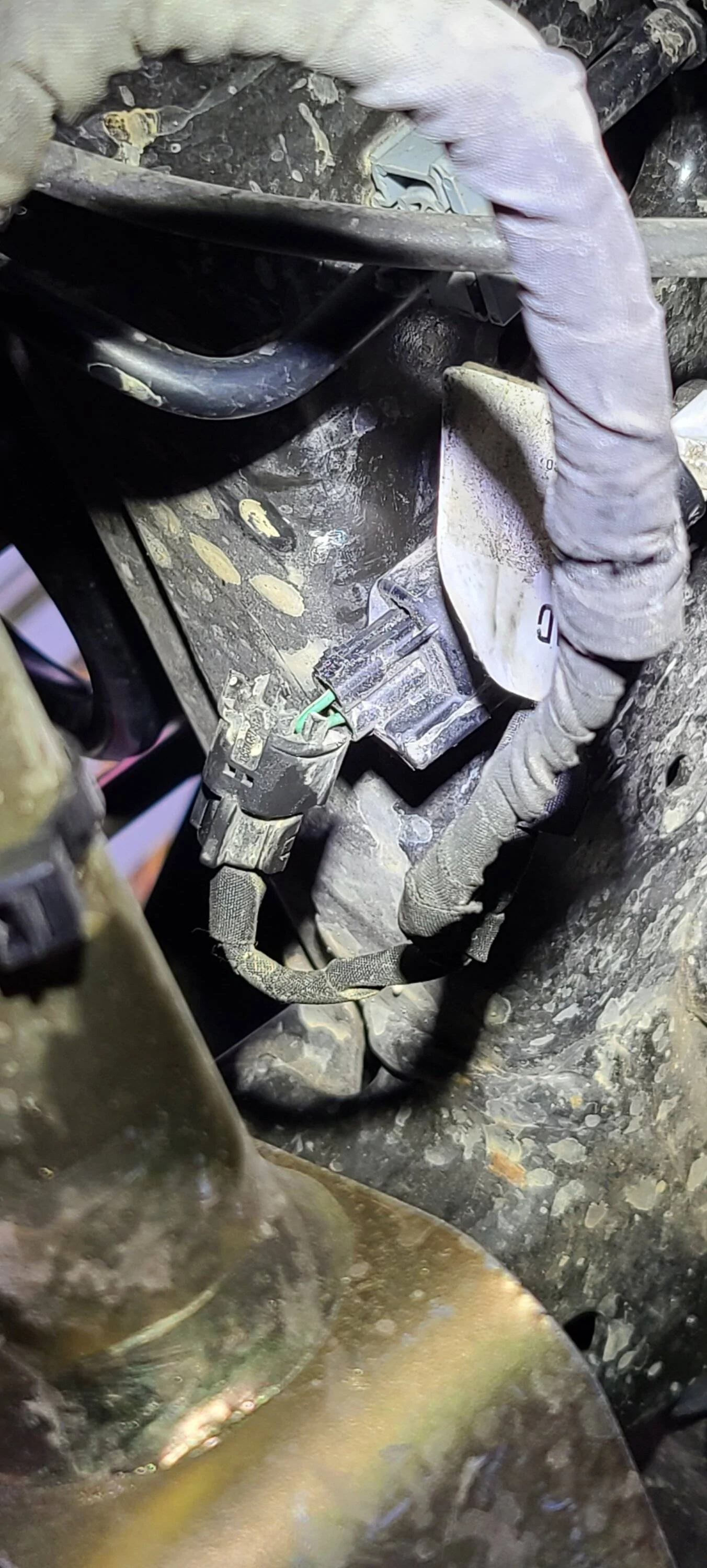

I couldn't stand it, so I went out and looked at the harness in my PJs this morning.
This is what I found. The harness looks repairable, but, it could be damaged along the length as well. I spotted a part number tag on it and went ahead and ordered the harness.

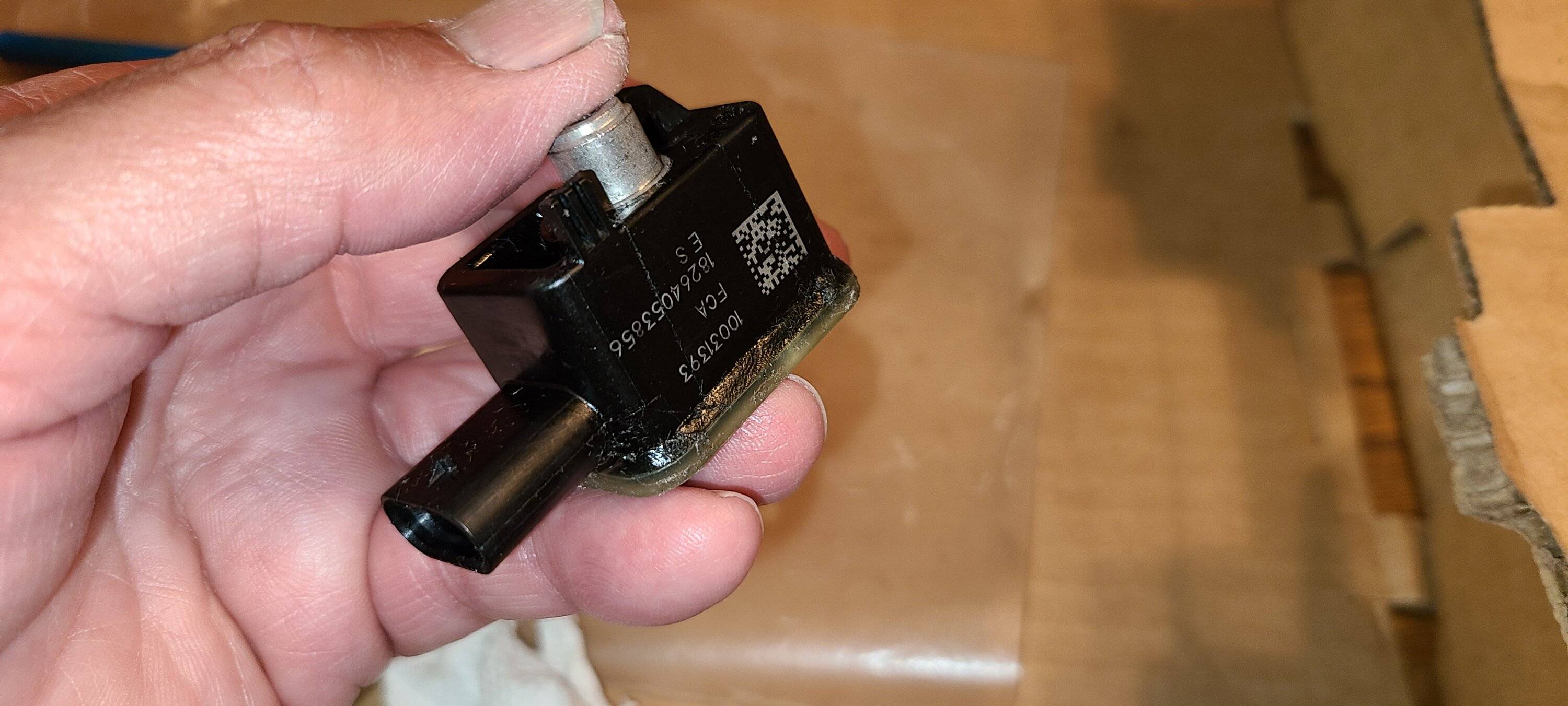

I opened the rear diff tonight and removed the sensor. It was completely full of gear oil. One tiny air bubble. Like the front sensor, I carefully tapped around the cover and removed it to clean inside as good as possible. I drilled an 1/8" hole in the bottom to clean under the circuit board and to facilitate potting it. After cleaning with contact cleaner, I warmed the oven to about 150f to to dry out condensation from the cleaner evaporation. I left it in the oven for maybe 15 mins. I'll also use the oven to cure the epoxy.

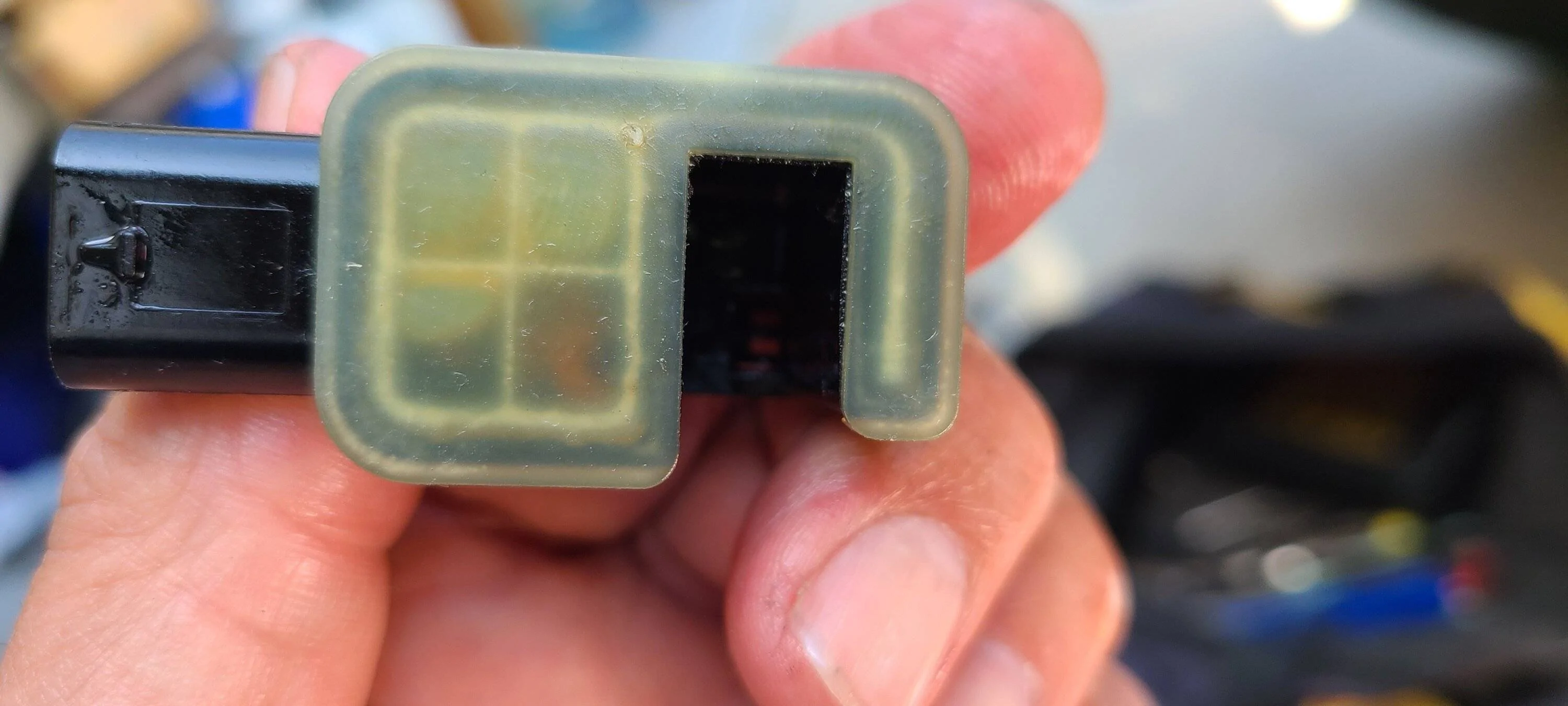

I didn't even bother to drill holes in the cover. I filled the small dog leg area from the cover side, then put the epoxy injector in the underside hole and filled it while holding the cover side up and level, until epoxy came up around the circuit board, then kept filling until it was bulging and about to overflow. Then I quickly put the cover on and flipped it cover side down on some wax paper on cardboard. The bottom cavity where the hole was drilled got filled and the whole thing went into the oven at 150f ish.
I'm just trying to keep it under 200f during the cure, not for the epoxy, but for the electronics. The epoxy would love a 2hr/250f cure, with ramp down steps to 150f for a few hours, and then to ambient.

After about 30 mins at 150f ish, it tacked up pretty well and I pulled it out to clean off the errant epoxy. An exacto knife and some brake cleaner on a paper towel worked well. I left the fillet that had formed around the cover lip. I concentrated on getting the areas where it had to register and the connector barrel and that slot where it goes around the other part on the coil. Then back in the oven at 150ish for a few hours. Maybe just leave it in there with the residual heat and the oven off, overnight.
