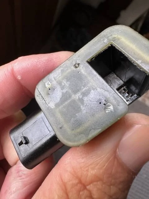

I ended up with a few tiny holes on the surface. Should I carve a little out a refill it?

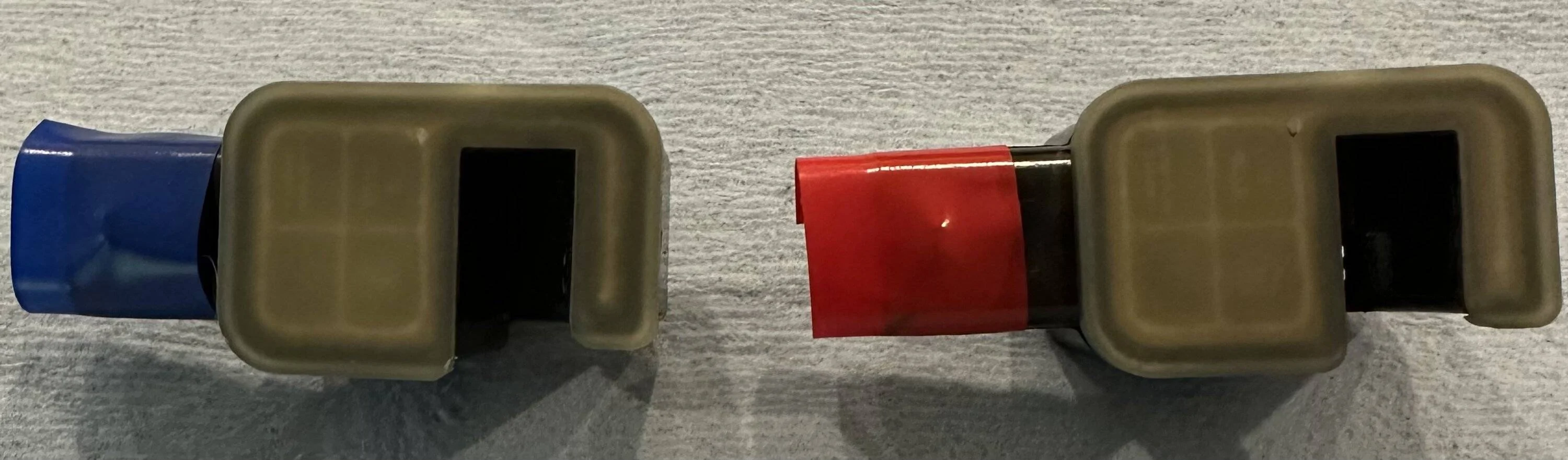

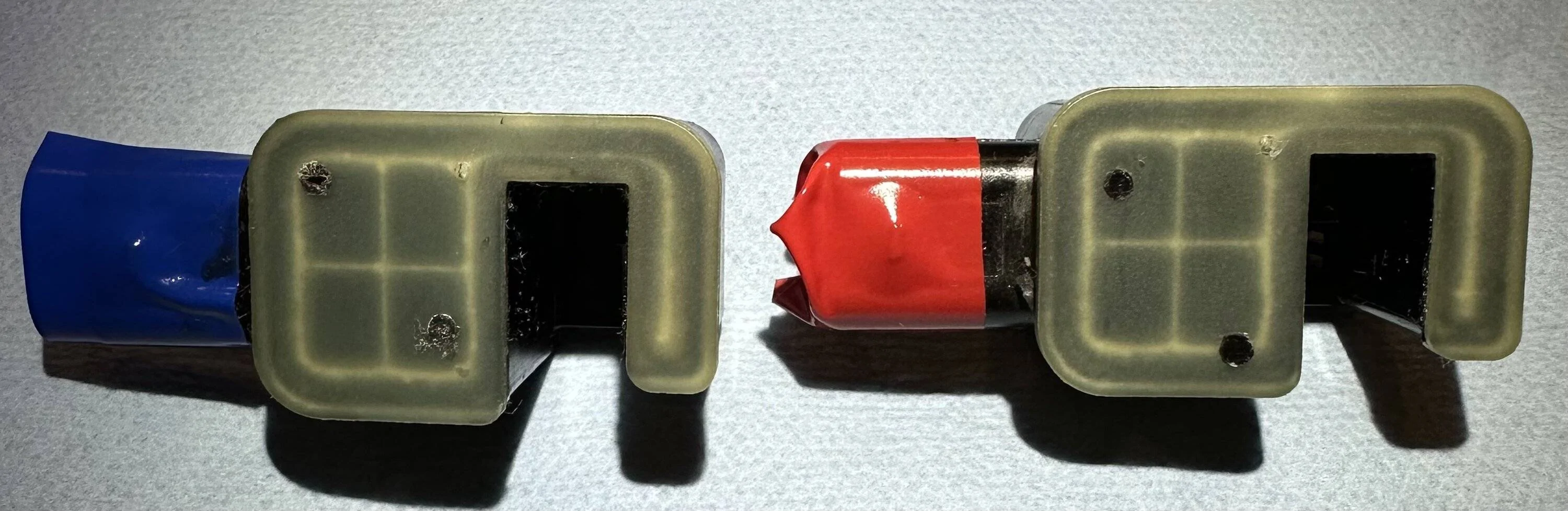

My ‘22 at 4,600 miles was completely free of oil in the sensors. This is a great mod/fix for peace of mind (thanks @chevymitchell). Glad to have it done. Ignore the red and blue tape on them, that’s just to satisfy my crazy out of control OCD so I can know which sensor came out of which differential.
