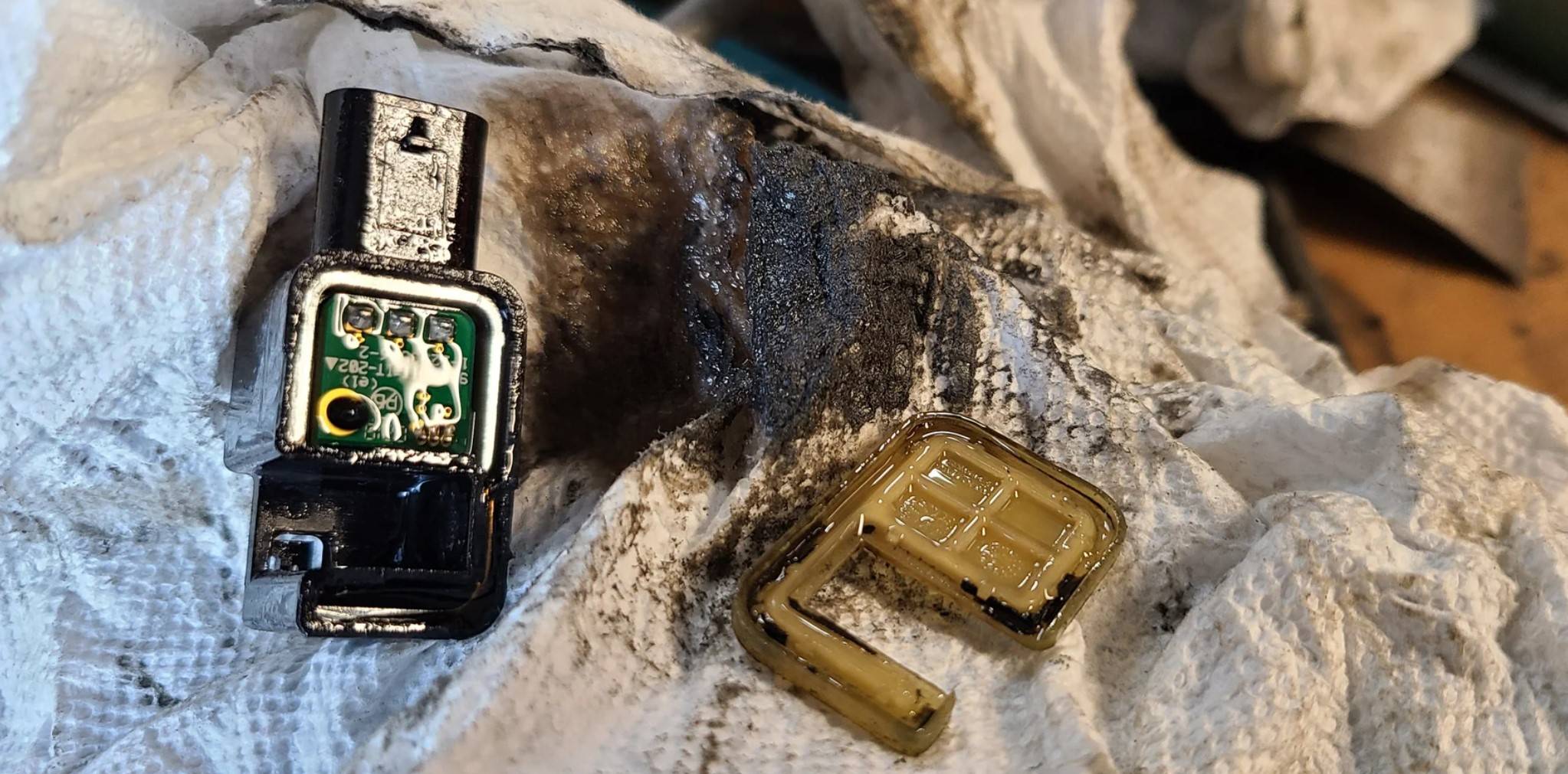

After having completely removed the white cover on both of my sensors, I think it helps with the cleaning/flushing. I used a little 4 oz hammer and a little stubby flat blade screwdriver to tap all around the edge of the cover. When you see the edge of the cover move a little, move on to another area and tap gently until you see that area lift, then keep going. A broken/cracked cover isn't the end of the world either. The epoxy potting will hold it together. With the potting, the cover is really optional. Filled to completely cover the circuitboard will provide all the protection necessary.
