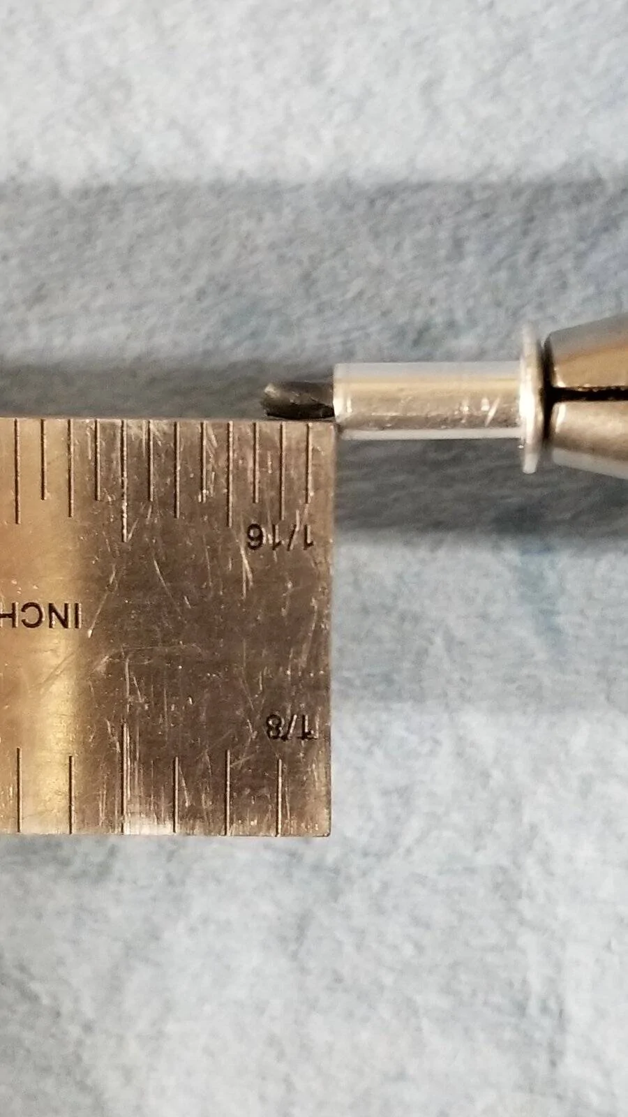

How thick would you say the plastic cover is - so we know how deep to set a drill stop.
Just a couple mils. There are several pictures throughout the thread that might be helpful for you, as well as, other comments on the thickness of the cover and what others have done to help mitigate any PCB damage.

Start short so you don't damage anything then if you don't go thru adjust just a tad deeper.
