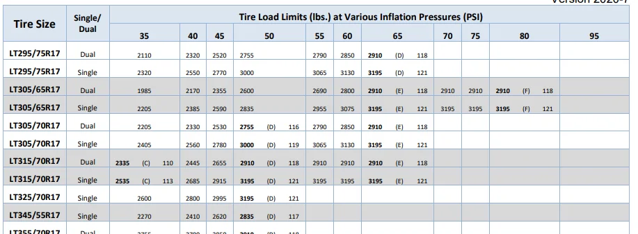

I keep looking for 35’s with a load C or D rating and it seems next to impossible. If I do go with 35’s it seems like all the tires are E rated and weigh around 70lbs.
I think (please feel free to educate me) a C rated tire will ride a bit smoother and deform better aired down with the weight of my Jeep. I want this. I currently have 315 falkin wildpeaks atw3 and they are E rated. If I air down to 20psi you can barely tell…I have to be closer to 15 to get deformation.
Also would really like some RT tires if I go 35. And my very short list is the radar renegades but again these are an E rated tire.
Toyo AT3: C rating available in 35" sizes and D rating available for 315/70R17
Toyo RT: C rating available for for 315/70R17 (but a max pressure of 35 lbs - not sure why so low)
Toyo RT Trail: D rating available for 315/70R17
The 35 psi is a part of the load rating. You can run the same PSI in the C and the D for the same load capacity.
