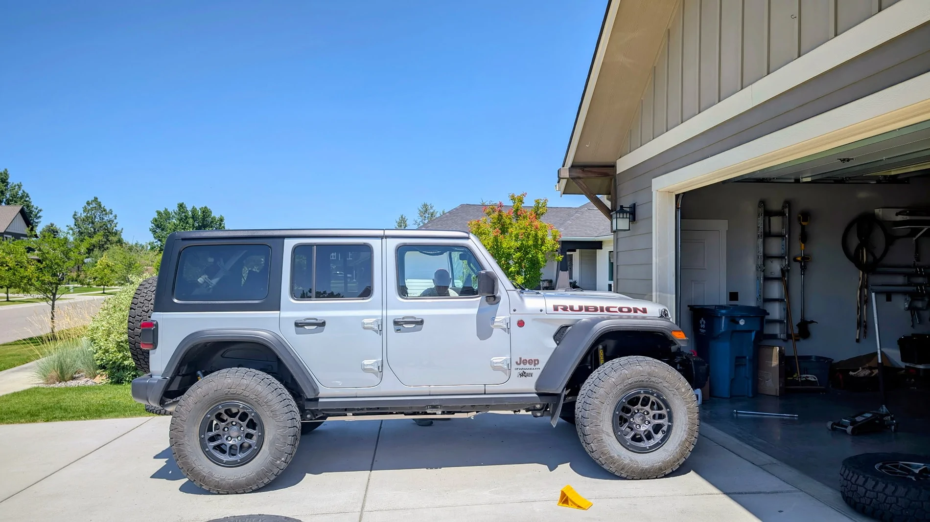

I think it looks kinda of goofy and needs 37’s.
Well…ain’t that the constant problem. Bet you get 37’s and in 2-5 years 38-39’s would be looking “more” fitting lol 😂

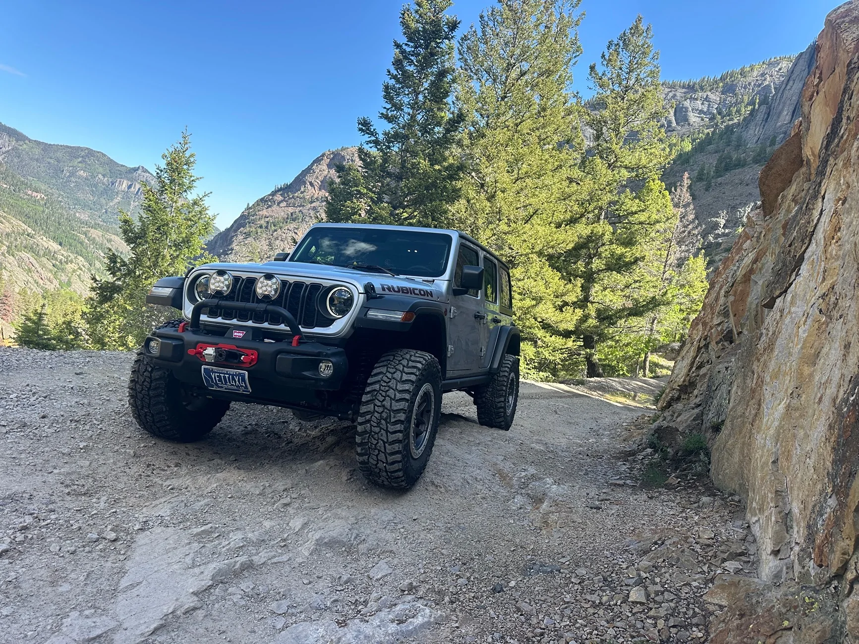

To the person that was certain you need a load range E, or at least a load range D tire for it to survive offroad, I don't think that is the case at all. When a tire manufacturer makes a 33" or 35" tire, what do you think they are making it for. I would think most of the people that buy those tires buy them for street use, with a few that buy them for offroad. When that same manufacturer makes a 40" or 42" tire, what do you think they are making that tire size for. I would think that almost every single person that is buying a 40" or 42" tire is buying them for offroad, but still a few buy them for street use.
Then look at the Toyo MT for example. 33" and 35" Toyo MTs are only available in load range E. 40" and 42" Toyo MTs are only available in load range C. So why would they build a tire size that is almost exclusively used for offroad in a load range rating that "won't survive offroad?" They wouldn't. A load range C Toyo MT is one tough tire. I've been using Toyo MTs for at least the last 20 years on numerous different vehicles, and I've never had a flat with a Toyo MT. I've had numerous flats with both BFG and Goodyear tires, the two weakest tires in the industry if you ask me.
I can add - been wheeling on C-range tires for over a decade, never been a problem. You don't need E's unless you suck at picking lines. C-range tires conform better too, which results in better traction in many situations.
I want to but I have had this dilemma for many years and always end up sticking with 35’s. I have 4.10’s and it works great with 35’s. I tried my buddy’s 37s and it was just ok. I have done moab trails and rubicon and dusy with 35’s and 2.5 lift. i just like the looks of 37’s better tho.
