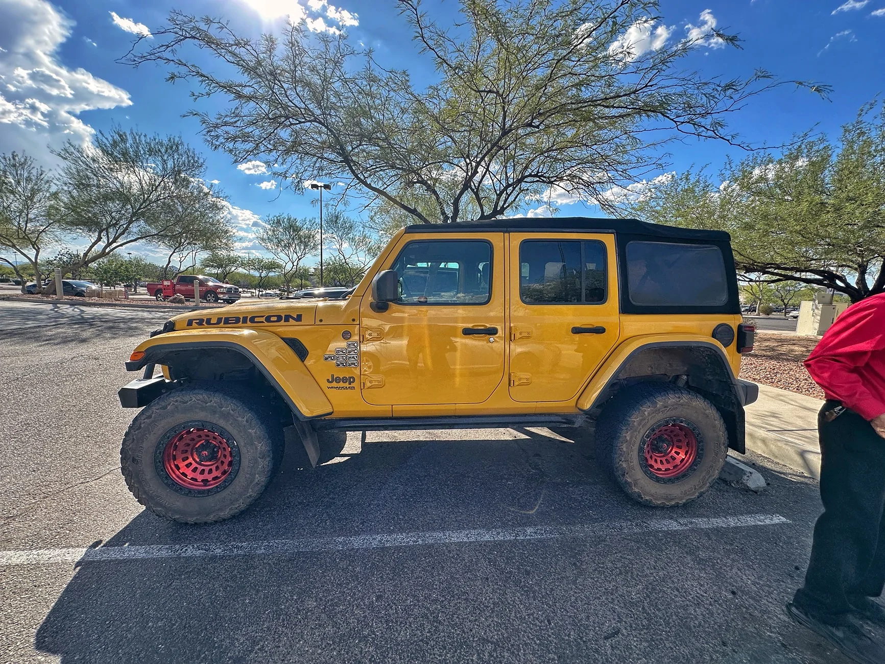

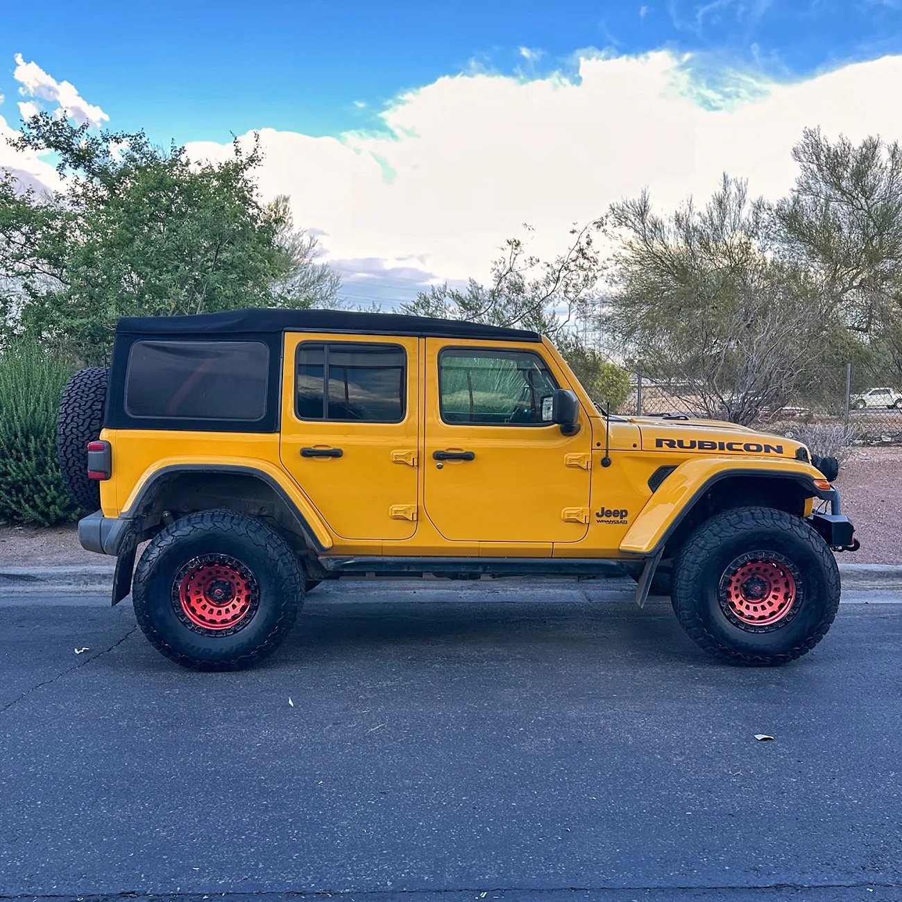

Here is the difference in 315/70R17 KO2s albeit with 77,000 miles on them (although the front tires have 7/32” thread still on them) and new 37x12.50R17 KO2s. I have a 3.5” Rock Krawler Xfactor No Limits lift. Photos are taken 1.5 hours apart outside Discount Tire.
Jeep Wrangler JL Load range C vs D vs E IMG_8329
Jeep Wrangler JL Load range C vs D vs E IMG_8331
