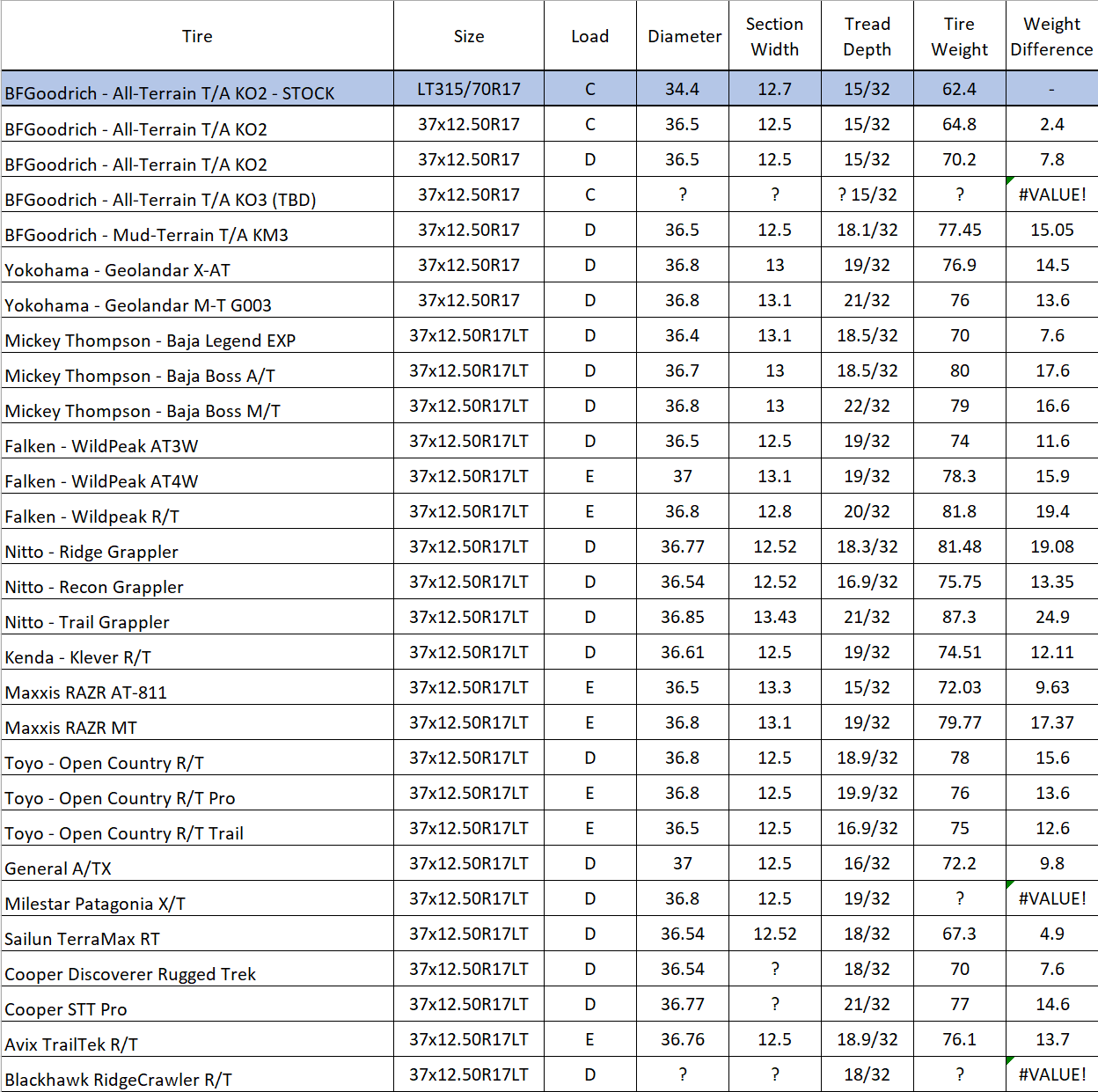

I’ve been looking at tires for a while now… I would like to move up to 37s once my KO2s wear out. I currently have a ‘24 Rubicon X with stock 315/70R17 and 4:88 gears. I’m wanting to go to an R/T tire. Not really interested in a M/T. I’m also weight conscious and want to keep it as light as possible. I’m not sure I want to stay with the KO2s either. They are rock magnets, and I drive a lot of gravel roads.
In my research, I’ve been compiling a list of tires and their weights. Most of these are A/T or R/T tires as those are what I’m more interested in. There are a few M/Ts there for comparisons.
Currently, the top of my list are the Toyo R/T Trail or R/T Pros.
Jeep Wrangler JL Load range C vs D vs E 1757968155960-e
What I find interesting is that there are several tires that are D rated that are heavier than others that are E rated. For instance:
  • Nitto Ridge Grapplers 37 D = ~81.5 lbs
  • Nitto Recon Grapplers 37 D = ~75.75 lbs
  • Toyo Open Country R/T Trail 37 E = ~75 lbs
I would venture to say that all 3 are virtually the same tire. Or at least have the same carcass. I’m guessing the Ridge Grapplers are heavier due to the deeper tread depth. So, the question is… Would you go with a heavier D rated tire? Or a lighter E rated tire?
It seems that more and more tire companies are upping their ply ratings. And does appear that most are catering to the HD truck crowd. Which is unfortunate...
I had Maxxis RAZR AT 37s that were D rated on my old Jeep. Now, that same tire can only be found as E rated. It appears that the specs are more/less the same. So how is it that D rated tire weighs in as much as the E rated tire?

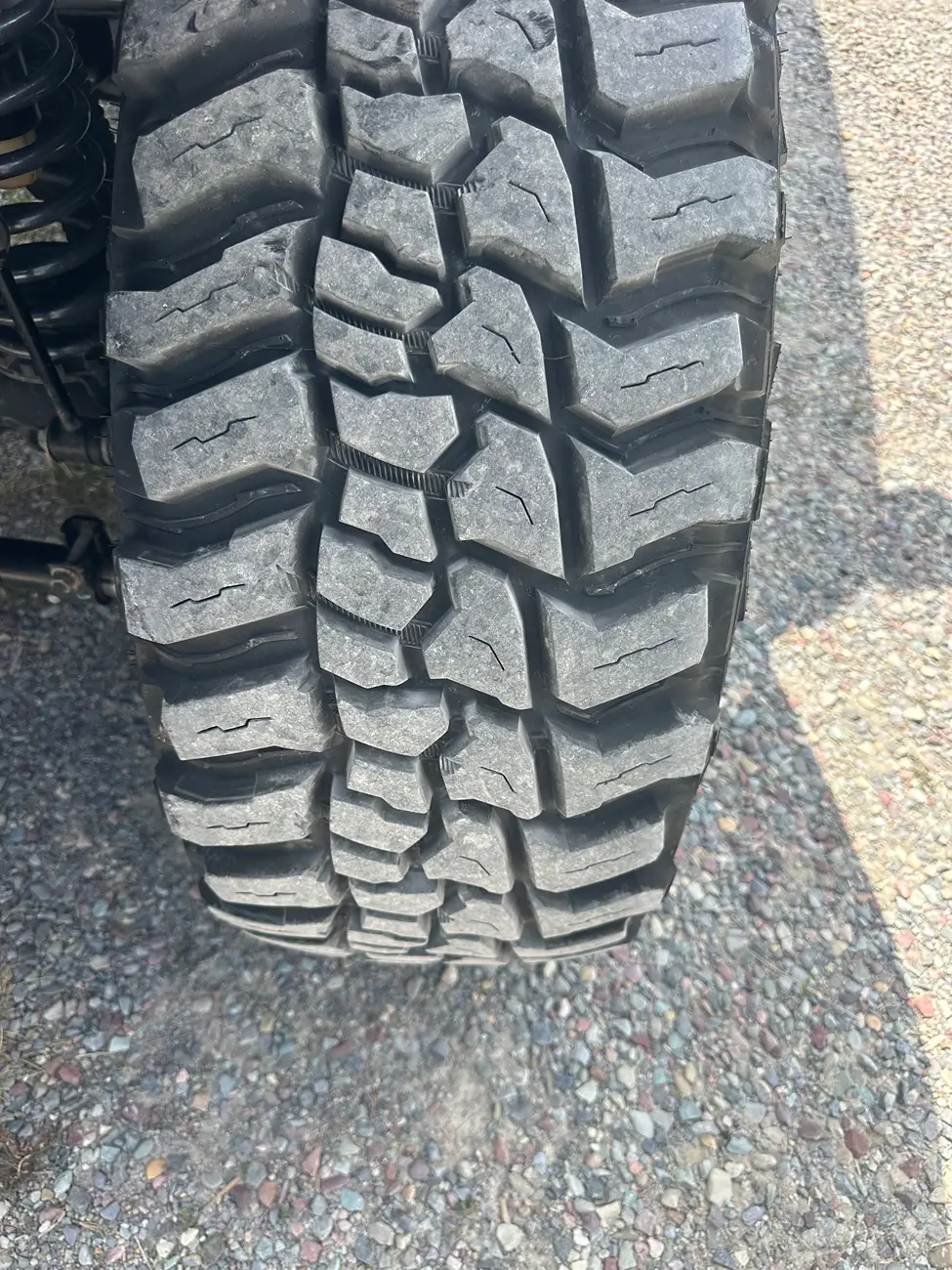

be sure you factor in the extra shipping charge. in small print the add $50 a tire for oversize shipping...which makes DT cheaper where I am at..DT has them at $419 vs $457 after shipping added...they actually weigh right at 71lbs on my accurate bike scale and measure 33.6" when mounted on the jeep at 28 psi....off the jeep are right at 34.7"

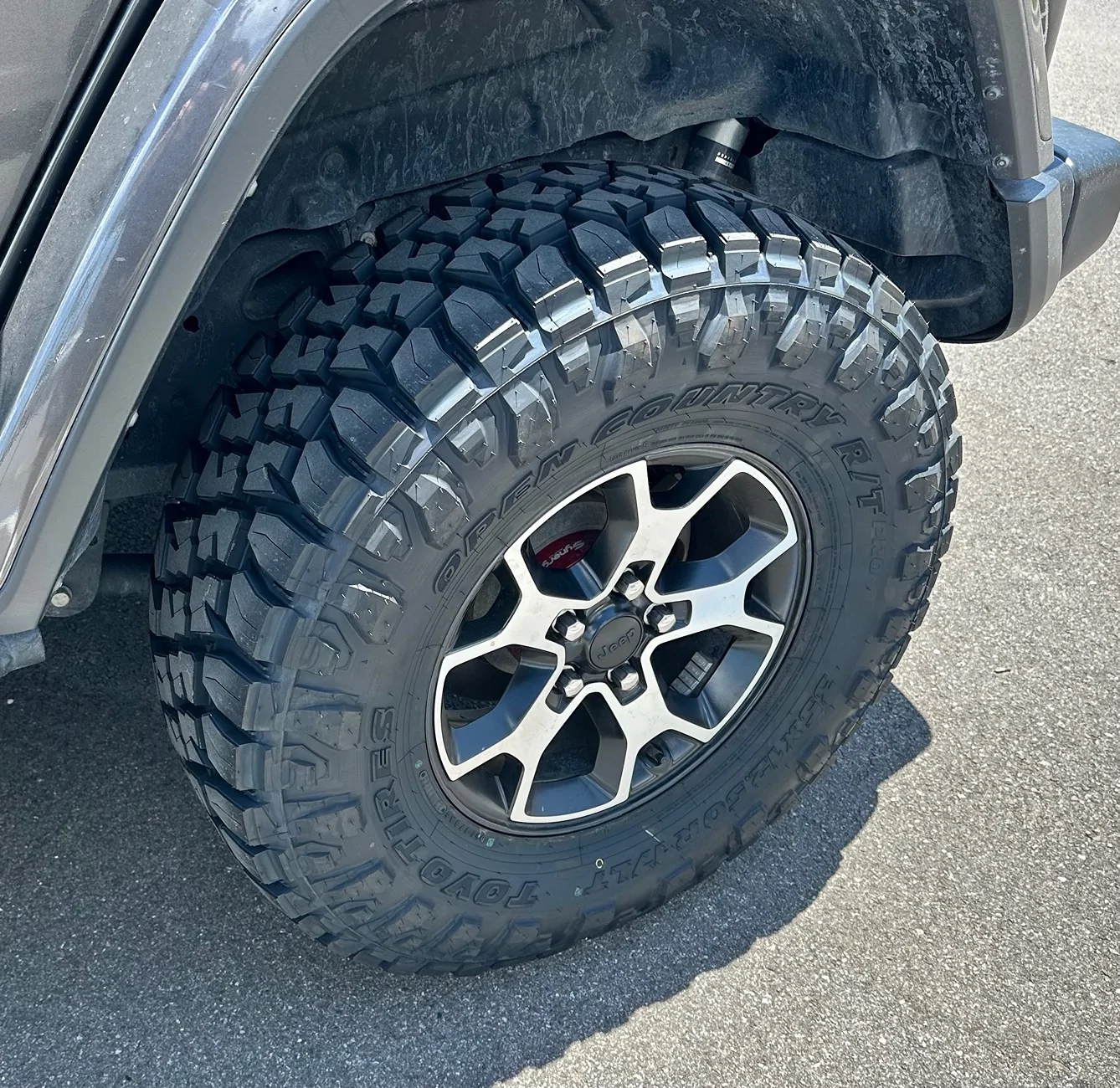

saw these the other day and took a photo...they look pretty nice (they are 18" tho)...that said my buddy bought a set and did not like them he said they really wandered...on his 2024 XR...
That's interesting. We have a set of Toyo RT Trail tires on my wife's Gladiator. I thought they were much better on road than the Nitto Trail Grappler's they replaced, with less wander and a lot less noise.
Same here. I’m about 22k into my Toyo OC RT Trails and love them.

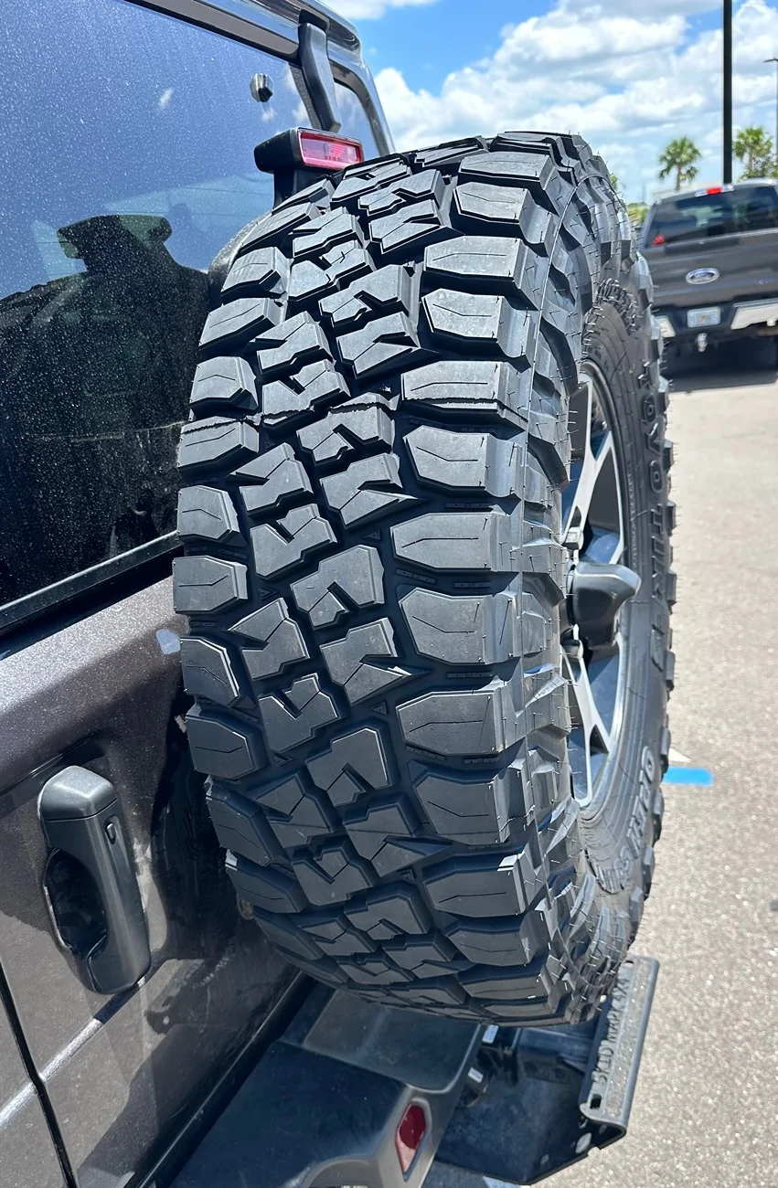

Chris, this is Toyo’s newest tire - the Open Country R/T Pro. It’s a hybrid MT, and they have a 45,000 mile warranty. I LOVE these tires! I do not know if they offer them in a lower load range, though (these are E-rated).
The pictured tire on my Jeep is 35x12.50R17, on the stock 7.5” rims.
I’m guessing you won’t find a more aggressive hybrid tire than these.
