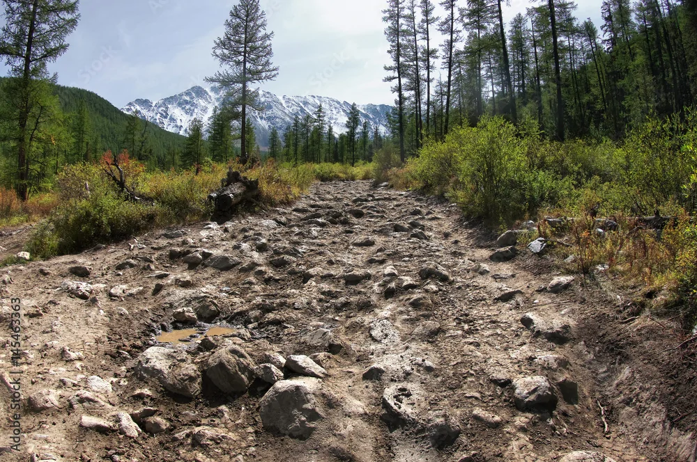

E rated tires are a complete waste on a JL....
I have 'E' rated tires on my Wrangler, because this is a typical day exploring for me. 'E' rated tires have a much thicker, multi-ply sidewall that can better stand up to these kind of conditions. 'C' rated tires get shredded on "roads" like this.
But if your Jeep is more of a Pavement Princess with only occasional forays into the country, then yeah, a soft tire is probably better for you.
...EDIT: To clarify, I see additional sidewall thickness as a good thing as someone who has torn multiple KO2 sidewalls on trail.

Jeep Wrangler JL Load range C vs D vs E RockyRoad

I have 'E' rated tires on my Wrangler, because this is a typical day exploring for me. 'E' rated tires have a much thicker, multi-ply sidewall that can better stand up to these kind of conditions. 'C' rated tires get shredded on roads like this.
Yep.
Yeah I wouldn’t say I’m a pavement princess but I’m not an all day everyday rock crawler either (mainly because I can’t afford it lol)

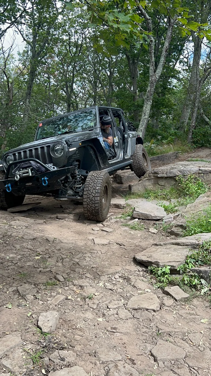

Jeep Wrangler JL Load range C vs D vs E IMG_4729
Jeep Wrangler JL Load range C vs D vs E IMG_0888
Nope. This is a common misconception. E-rated tires do not automatically have "thicker" sidewalls. If you actually look at the construction of different E-rated tires you will find that sidewall thickness and construction varies greatly. Furthermore, "thick" sidewalls do not equal "strong" sidewalls. As mentioned, the 10-ply sidewalls on Duratracs are weaker than many 5-ply sidewalls. This is due to advancement in material technology. Newer C-range tires are tougher than many old E-range tires.
Don't get me wrong, you may have had C-range tires in the past with "weak" sidewalls. The point is that you can't judge how "tough" a tire is by its load range. Load range is for carrying capacity and is achieved through many different methods that vary by manufacturer.
