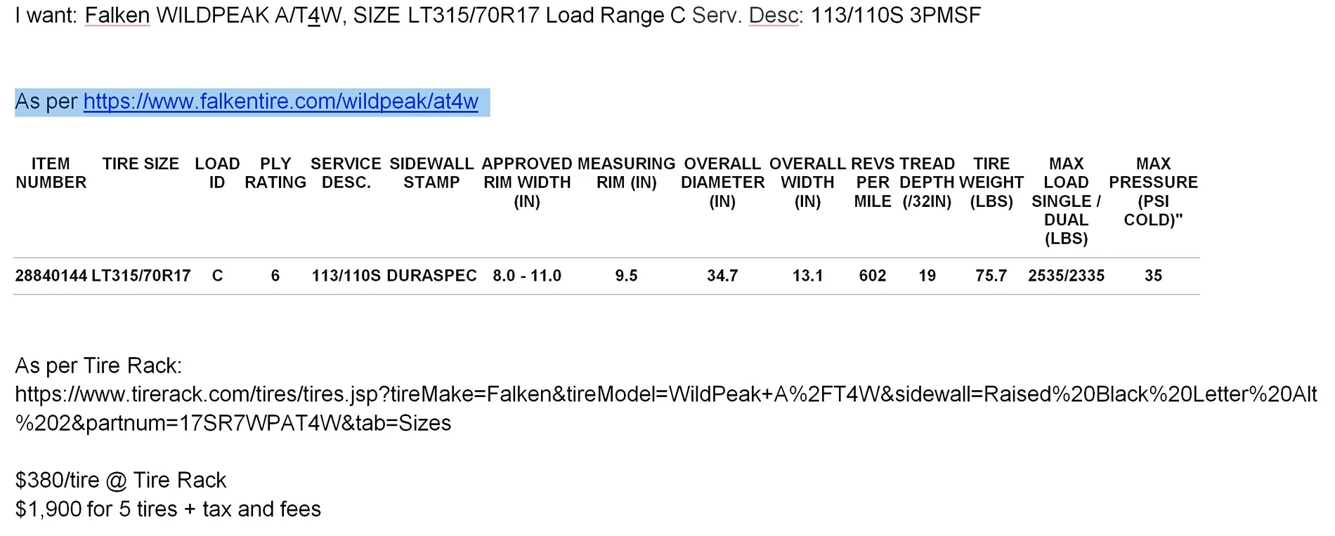

Here is what I am doing. (Loade range C) 75.7 pounds.
Jeep Wrangler JL Load range C vs D vs E tir

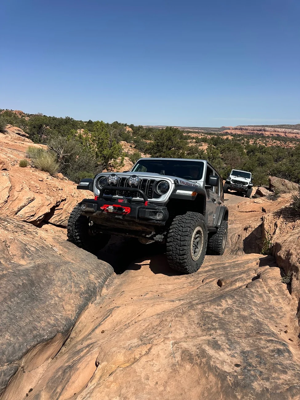

Great tires.
Jeep Wrangler JL Load range C vs D vs E IMG_8622
