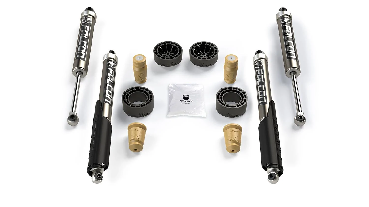

I’m going ST1 or ST2. That’s just me, I like Falcon. I’ve never heard of Rubi Express.
ST1:
Yummy
Im also thinking of going that direction . Which setup did you ended up with? the st1 or st2 do you have photo's
I still have not pulled the trigger lol sold my house and in a rental house while having a house built haha it’s been hectic to say the least! As soon as I get my family into this new house I’m getting the ST2 likely and putting it all on in my garage haha

I had the TeraFlex ST2 kit installed two weeks ago with the Falcon 3.3 quick adjust shocks, running 315/70/17 KM3 tires on 2019 JLUR very happy so far.
That looks fantastic! How is the ride so far, compared to stock (presumably on the softest setting for the Falcon shocks)? And did you change anything else, like adding an adjustable track bar, etc?
And did it come out to 2.5" of lift, or just below that given the winch?

So far the ride might be slightly stiffer than stock, but handles the bigger tires much better, on the washboards roads the ride at speed was awesome, there has been no front end droop, unlike my Landcruiser where i put a whole new steel bumper on along with the winch, I do not think adding the winch changed the weight difference as much because I used the stock bumper and saved some weight by taking the ends off, I did not measure before and after but it looks and feels to be about a 2.5" lift. Very happy so far
