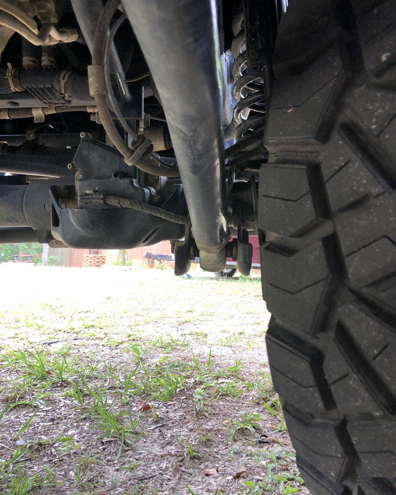

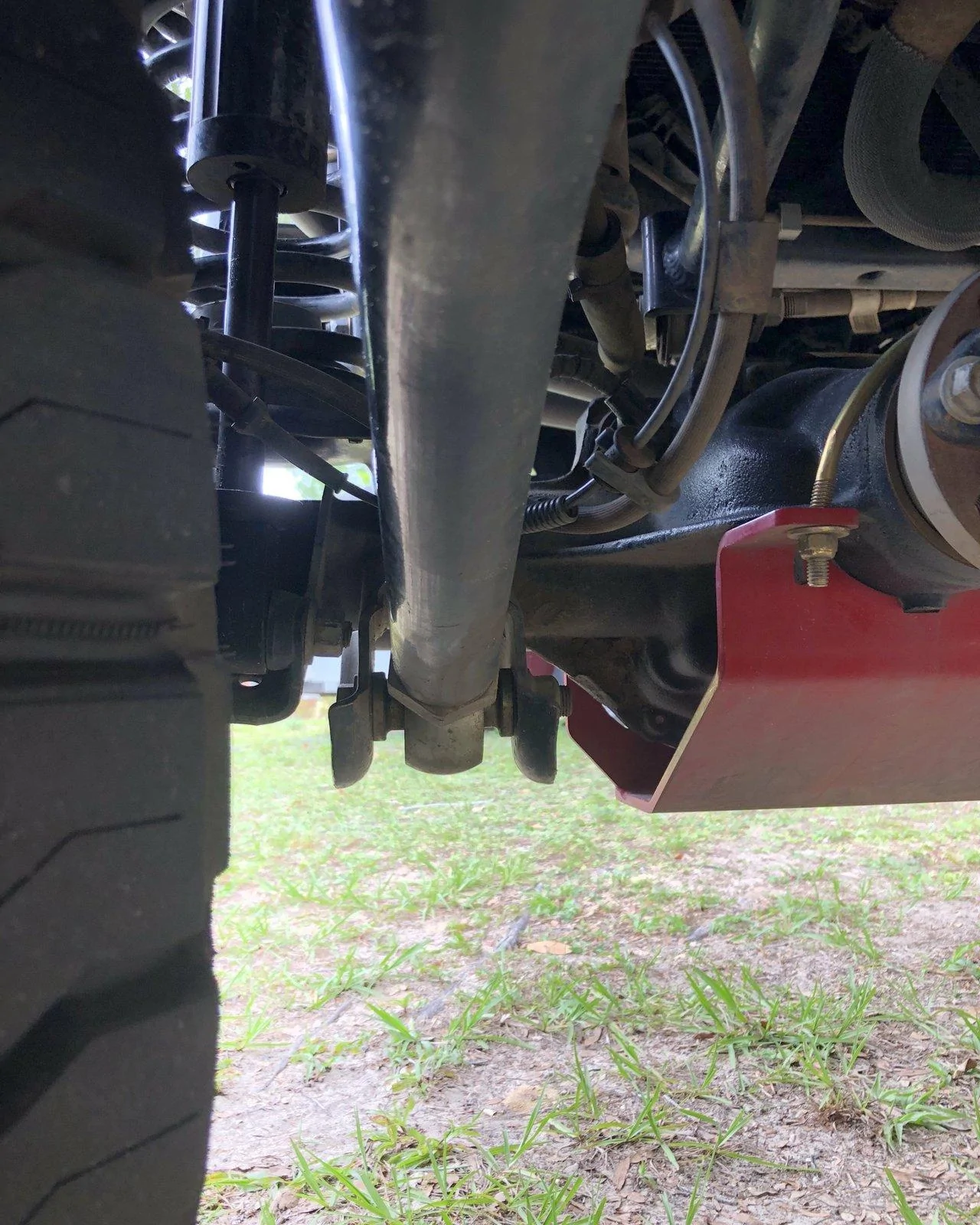

I’ve installed several of these kits, including mine and no rubbing issues,.... here’s turn to lock both sides...... do you have pic of yours?
Jeep Wrangler JL Lift kit advice, Rock Krawler a solid choice? 37B89007-2530-4DEB-8161-9925ED973BB3
Jeep Wrangler JL Lift kit advice, Rock Krawler a solid choice? 425F431C-7617-48BD-A173-CB4551D17C35

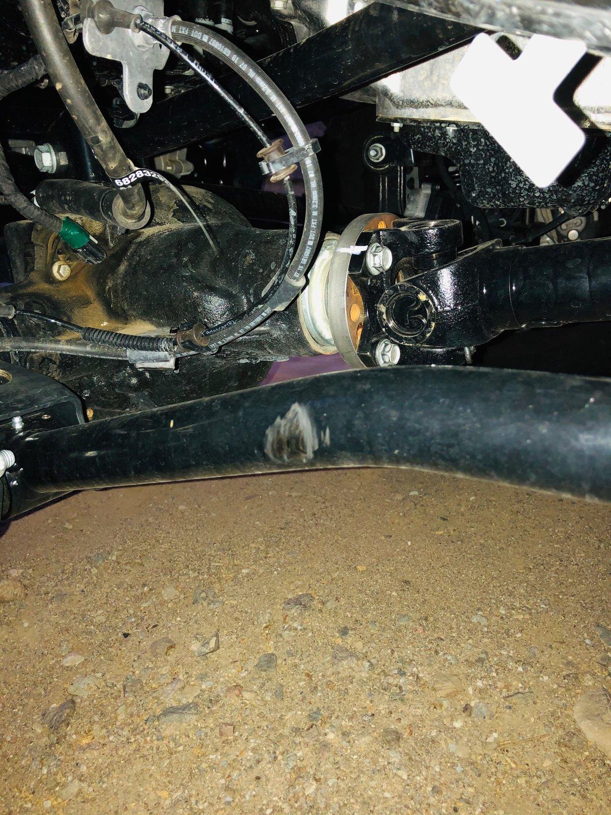

Are those the x factor arms? i have adventure series
Jeep Wrangler JL Lift kit advice, Rock Krawler a solid choice? IMG_1545
