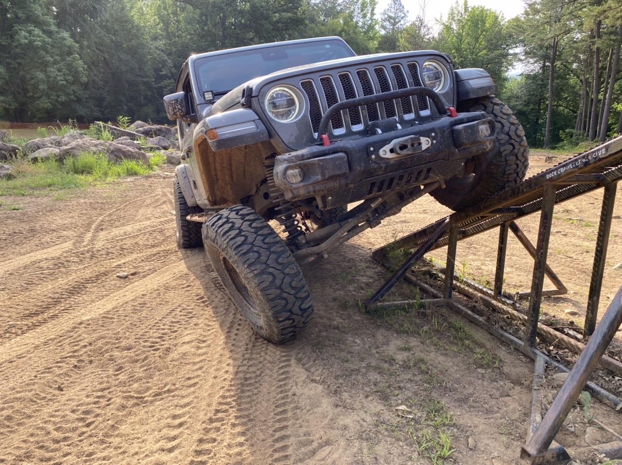

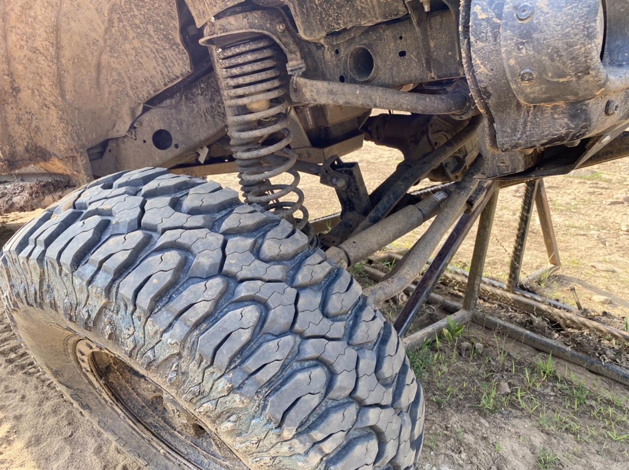

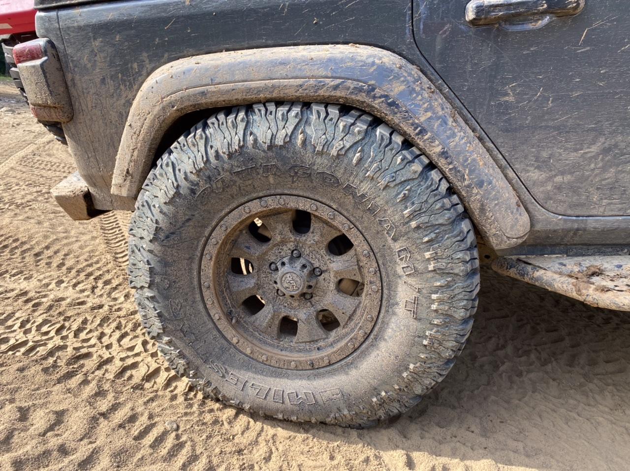

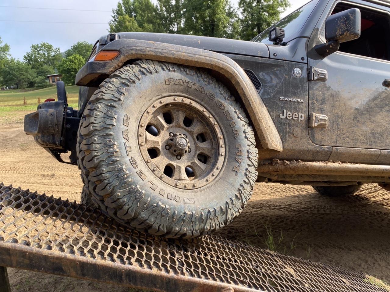

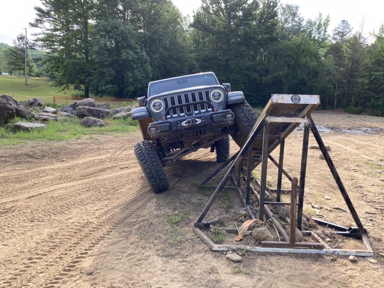

I finally really got to test my RK kit last weekend and am very happy with the performance. Did some fairly decent flexing and off-camber stuff and the suspension worked great. I have the Adventure Series 3.5”. I may get adjustable front LCAs at some point to dial in the caster a little more for better tracking on road but overall very pleased.
Got to test the flex on a ramp for the first time. Pretty good for a Sahara, I think.

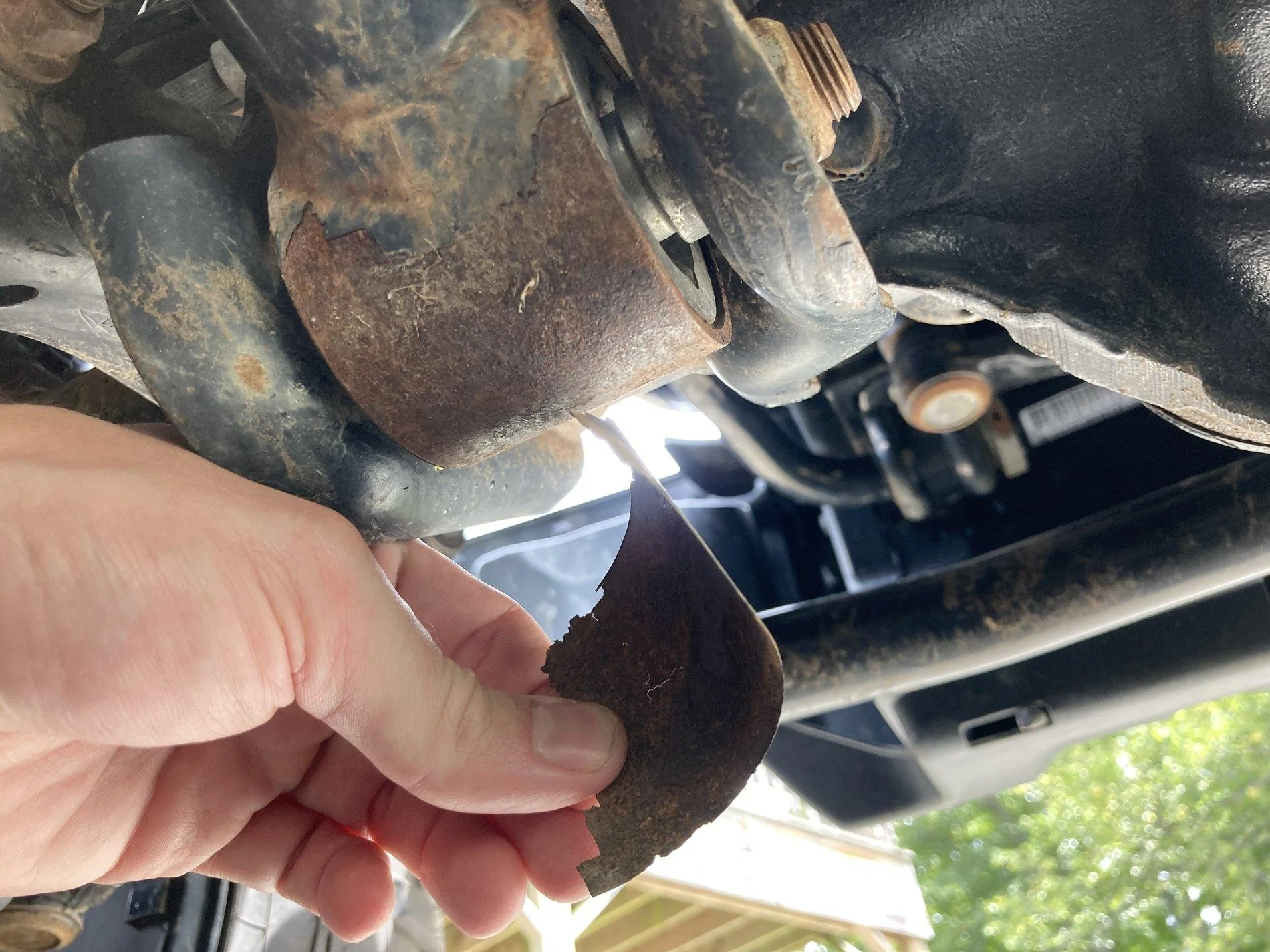

My powder coat is defective too. It’s been coming off in sheets on my LCA’s and track bar is bad too. Obv not much has changed despite you saying so, because my kit was bought last fall, 2019 and even in an email to me you stated you’ve been having grounding issues with the Powdercoat. I even see a lot of reviews and posts about powder coating issues from just about every year all the way back to 2013...what decade are you guys going to handle this? Yes, you warranty parts but that doesn’t negate all the hassle and most importantly all the time involved switching stuff out. Time’s the only thing we can’t get more of.
People coming to this thread from search, keep in mind my jeeps a 2020 and this thing hardly saw any winter whatsoever because I was driving something else most the winter. The Jeep basically sat.
There are better kits out there friends. I wish I made a better decision. Hopefully you guys are smart and buy elsewhere.

Chase, these are the arms that we warrantied for you, correct?
For sure, did you even bother to read? Just letting people know about your ongoing powder coating issues. That’s what these forums are here for. I wish I had known about it prior to getting a kit.

This is Adam.
As a short glimpse of the history in powder coating in RK, In August 2018 we hired an outside company to evaluate our processes. Based on their recommendations, we changed prep procedure, prep chemicals, primer, sprayer brands, powder manufacturer, application processes, cook temperature and cook times.
The challenge here is that each individual piece must be grounded when being sprayed. If, for some reason, the powder coater did not complete the circuit or the grounding rod was not completing the circuit at the time of spray, you end up with a result like what you had and was the reason we promptly replaced yours.

No one posted your name out of spite, the photos are simply the same photos you used when you sent them to us so I thought it best to address you directly.

I realize things happen... hopefully you’ll get it all under control. Until then I’m entitled to share my experience. That’s what these forums are for, to help one another. Until then though, please don’t be posting that the coating you have now is far superior etc. I and others I found from just a quick search have been having significant issues lately. You posted here in June 2020 that everything was all overhauled on 2018 and everything is far superior. How bad was it back then if it’s far superior now?

Your frame and every piece of hardware under your jeep is rusting just as badly as the control arms, I don't think any powder coat is going last in the conditions you are in.

All the process don't matter if the ground circuit did not make contact which is evident in yours. What you have is absolutely not the norm.
