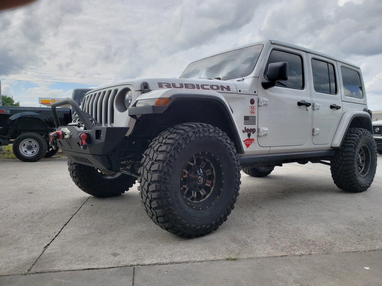

I just did RK 2.5 adventure series and love it so far
Can we get a pic with rig level and a shot from the side? Also are those 37’s? Also which Adventure series number did you do?
That looks perfect from the first pic.
