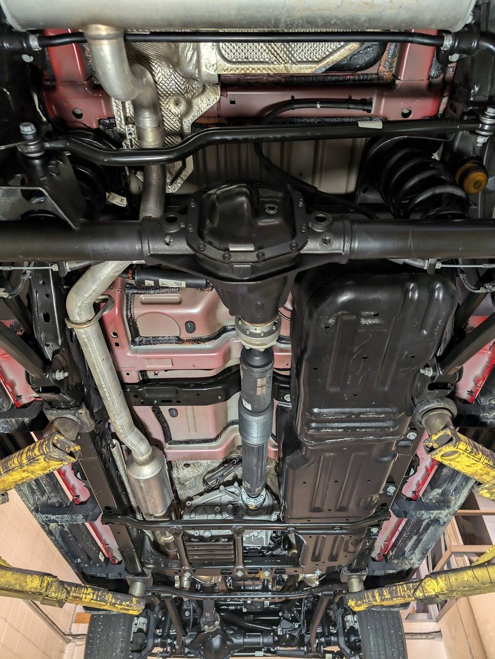

So anyway it turns out its not so easy to remove unless you like harsh chemicals all over the place where rubber exists, and so what you need is magic in the form of dry-ice coldness that freezes the crap off so it flakes off and......well magic! Now lets be clear... I'm not going to pretend i know what im talking about here. All I know is that the guy got rid of it then covered it with wax WHICH I DID RESEARCH BEFOREHAND THANKS FOR ASKING. GEEZ.

Nope, you were right. The bottom was dry ice blasted. I should have been more clear - theres a single company in my city that does it and I had to wait about a month just to get in. He says he has to deal with this all the time and his front waiting room is basically a museum of rusted out car frame pieces with rubber on the other side.
Whole process to remove it then apply the wax took 2 days. Paid 200 to put on the rubber, 150 in beer to drown out the regret after realizing my mistake, and around 1500 for the removal/wax application. Eating mac and cheese for the next while but it was worth it. Not worried at all anymore about rusting out the bottom and the wax is said to last about 10 - 15 years.

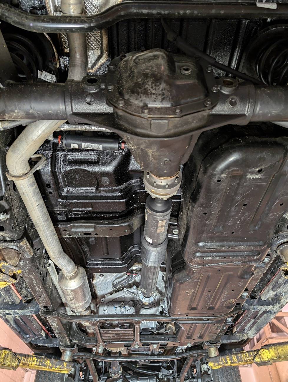

I had my jeep treated by Rustless rides in Ohio applied a undercoating made by NHOU sprayed into the frame rails, the inner fenders he even took the brake lights out and sprayed the inside of the rear panels. I watched the whole process very impressive.
