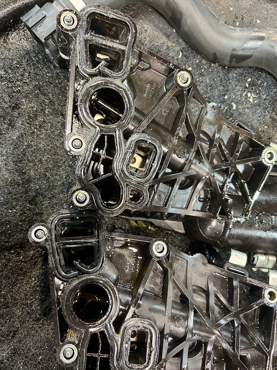

This is what a cracked housing looks like. The pentatstar housing never does this.

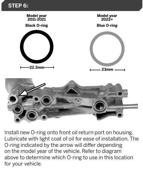

The Dorman kit comes with two different o-rings for the front seal. Are you sure you used the right o-ring in this location?
I don’t know about the Dorman, but the factory part has both o-ring sizes included. One red, one black. Instructions and picture printed out very large and stuck right to the top of it.

You most likely missed removing the old gaskets, or failed to verify your new housing has gaskets, or failed to properly install said gaskets. Or just didn't tighten it properly. Same shit.
You need to repeat the repair. I'd strongly suggest buying an OEM new housing over the Dorman. The design was updated to prevent this failure in the future. They leak from the o-rings under it, not the housing themselves. Originally dealers were replacing entire housings as the gaskets weren't available separately, which led to the myth of cracked housings. There's an o-ring kit available, but since they've just outright updated the housing and gasket design we're back to just recommending entire coolers again which helps proliferate the myth even longer.

I installed it twice following the torque specs given in the instructions with the dorman unit and checked with the OEM torque specs and it is still leaking.
I may try to reinstall the OEM housing with a new set of o-rings. I bought a set of felpro o-rings for the dorman housing because I saw some folks had problems with the ones dorman supplied. I am going to see if those will fix the old housing
