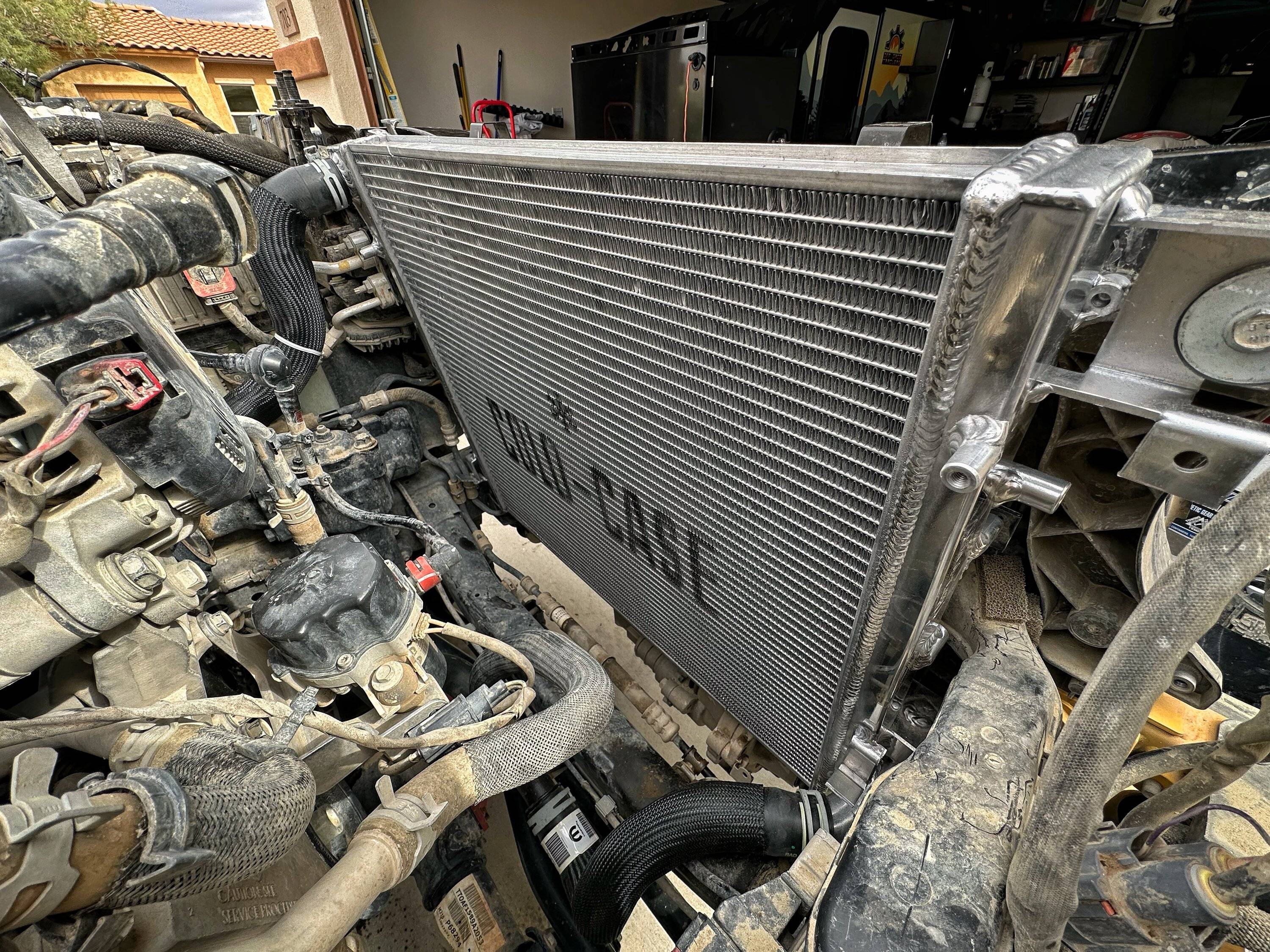

I just received the Cold Case and it came well packaged, completely secured in a custom white foam enclosure inside a cardboard box. When I pulled the Cold Case out for inspection, everything looked to be well made with quality welds. I will be using new factory rubber mounting isolators and not reusing the ones on the OEM radiator and of course making sure everything fits properly without binding or forcing. Installation will be late July when I install the Edelbrock Supercharger...

I installed the Cold Case radiator on October 23, 2022. The installation was very straightforward and it all went back together just like using an OEM replacement. This was the weekend before pulling our trailer 600 miles each way to attend the Moab Jeep Jamboree. The radiator did its job and I saw an average of a 10˚ or more reduction in coolant temp. When running the AC and coming to a stop the coolant temp falls quickly to 185˚ or less until it settles at 194˚. I have the 6-speed manual and now have almost 20,000 miles using the Cold Case radiator and recommend it highly.

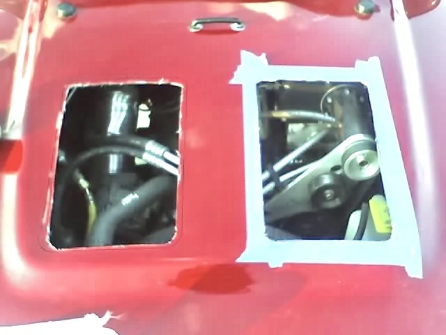

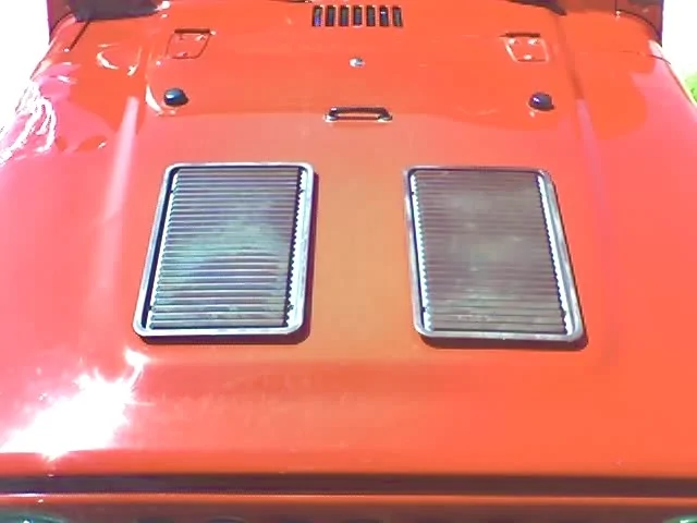

When I got my puffer installed I found out I could NOT even drive up the on ramp and run with the traffic my pre-det was so bad. By the time summper go there I could barely drive any over 40 mph.
Mitigation:
Some research at FCA led me to a 7-blade fan from 5-blade...I think it was from a truck or something with my same engine. WOW, that helped BUT still not at highway speeds.
More Chrysler research led me to an old model of car that had a Supercharger and it had hood vents. Found a set on E bay and BINGO problem solved.
No need for a colder thermostat.
Take note of where I put the hood vents, forward just aft of the radiator and over the nose of the SC.
NOTE I experimented with vent placement by using wool knitting thread at various places on the hood and seeing how it reacted to speed. What was found was mounted forward, by just behind the radiator and over the hollow between the radiator and engine block and over the nose of the SC.
My temp never changed after that, it dead on and to show how well it performed. I was asked to test a Warn Winch, it was called the Power Plant, it combined a 12k winch and an OBA system, but it was BIG and sat in front of the radiator. Warn told they believed that had designed it to flow enough air fo the Jeep. Well, I lived in Scottsdale AZ, where street temps in Friday rush hour 5 pm traffic hit 130s+. So I drove into downtown Phonix and sat in traffic with the engine idling and AC full on...not a problem, the temp gage never changed and I 2 temp gages one OEM and the other was one I bought for the test.
COST:
7 blade OEM fan about $45 bucks or so
Chrysler OEM Hood vents about $40 bucks

Going to agree that hood vents are the #1 way to keep the jeep cool. My 16 had the factory hard rock hood vents and the engine bay was just cooler. Never even had to replace the filter housing gaskets on it. You should feel the massive amount of heat escaping from my alfa's vent once I turn it off. It's substantial.
Did you leave the OEM 195F thermostat in?
