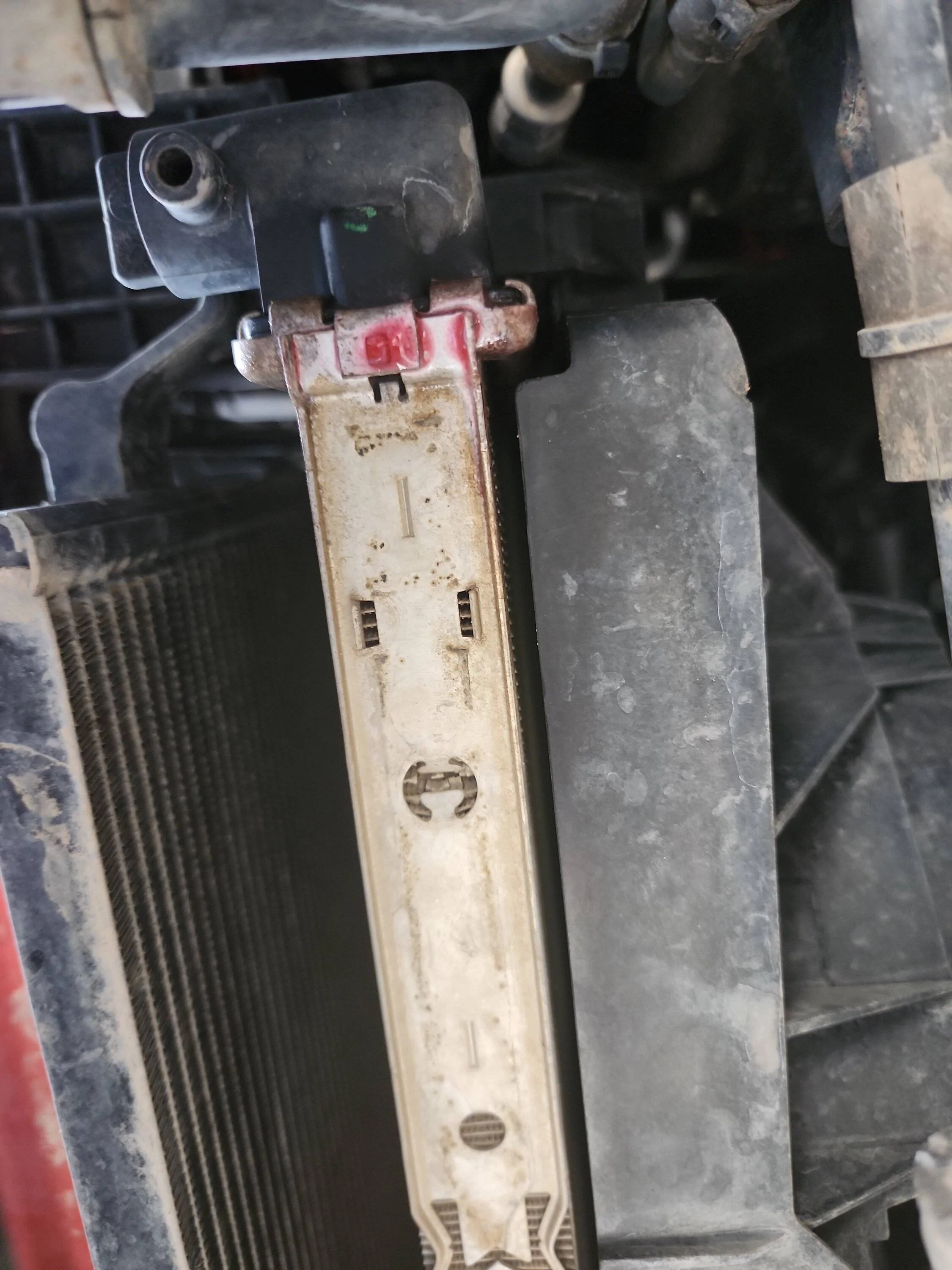

I've been trying to track down a slow coolant leak for the past 2 months, and today I finally saw a spot on the driveway.
It looks like the leak is coming from the radiator. I can see an active drip from the drivers side lower corner of it (image below).
My question is, for a driveway repair; Is it worth the hassle, or should I pay a bit extra and just let a fully equipped shop do it?
I'm pretty handy and do all my own suspension and electrical work, but the last time I swapped a radiator out was 20+ years ago on a '97 TJ 4-banger and you could almost stand up in that engine bay... the JLs are a bit more cramped. :)

It seems that when draining coolant, it spills over a wide area, and is tough to contain all of it.
To eliminate this, use an inexpensive concrete mixing tray from Home Depot to catch it..
https://www.homedepot.com/p/Plasgad-20-9-Gal-Black-Large-PVC-Concrete-Mixing-Tub-887102C/205451585
Thanks for the tip. I'll plan on it.
I've got a Mishimoto coming in as a direct replacement. Griffin doesn't seem to have any past 2017 for direct fits.
I'll plan for a 6hr job and a few beers. ?

Appreciate all the tips. I did try to burp the system post install, just because I'm used to doing that on older vehicles. I didn't really have any way of knowing if the system had purged any air left in it to be honest though.
I let her run and topped it off when needed over the course of a good 30 minutes. That was 1 week ago, and I've had to add a little bit here and there as I drive it.
Since then, I've just watched the Temps whilst driving for both Coolant and Oil. Each stay between 200 and 220 (i.e. within range) on a low 70 degree day with stop and go driving.
There's been no more active leaks and the Mishimoto radiator was an easy drop-in unit. The OEM radiator was leaking slowly down the entire driver's side edge. So, it was 100% time to replace it.
