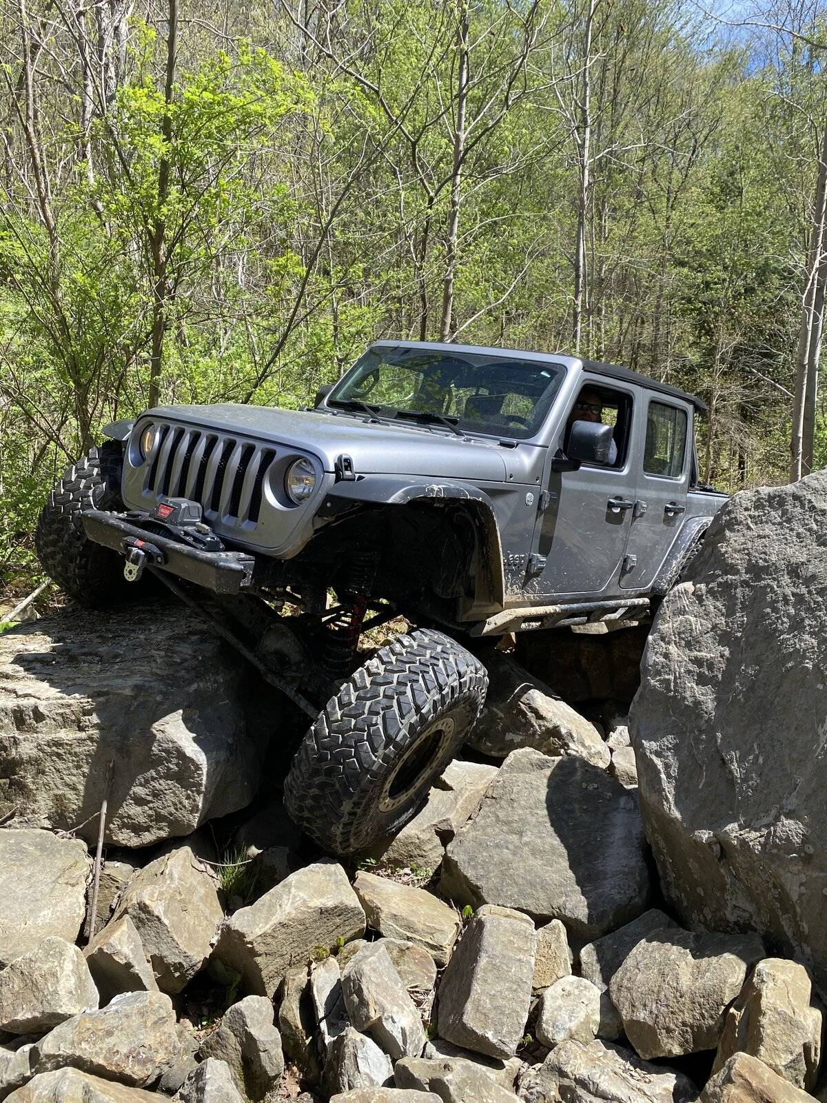

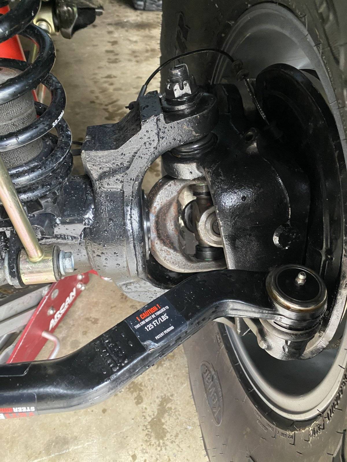

I did 08 Superduty front with 02 14bolt rear . 4.88s ,arbs and 1550 ujoints . All factory systems are working with stock front and rear jl sensors .

Running all sensors to the rear. Running auto lockers Detroit and grizzly and everything works well. Now if I get on the throttle around a tight turn the abs light will flash.

Factory booster works great and jl brake lines fit on the banjo bolts for the one ton swap.
