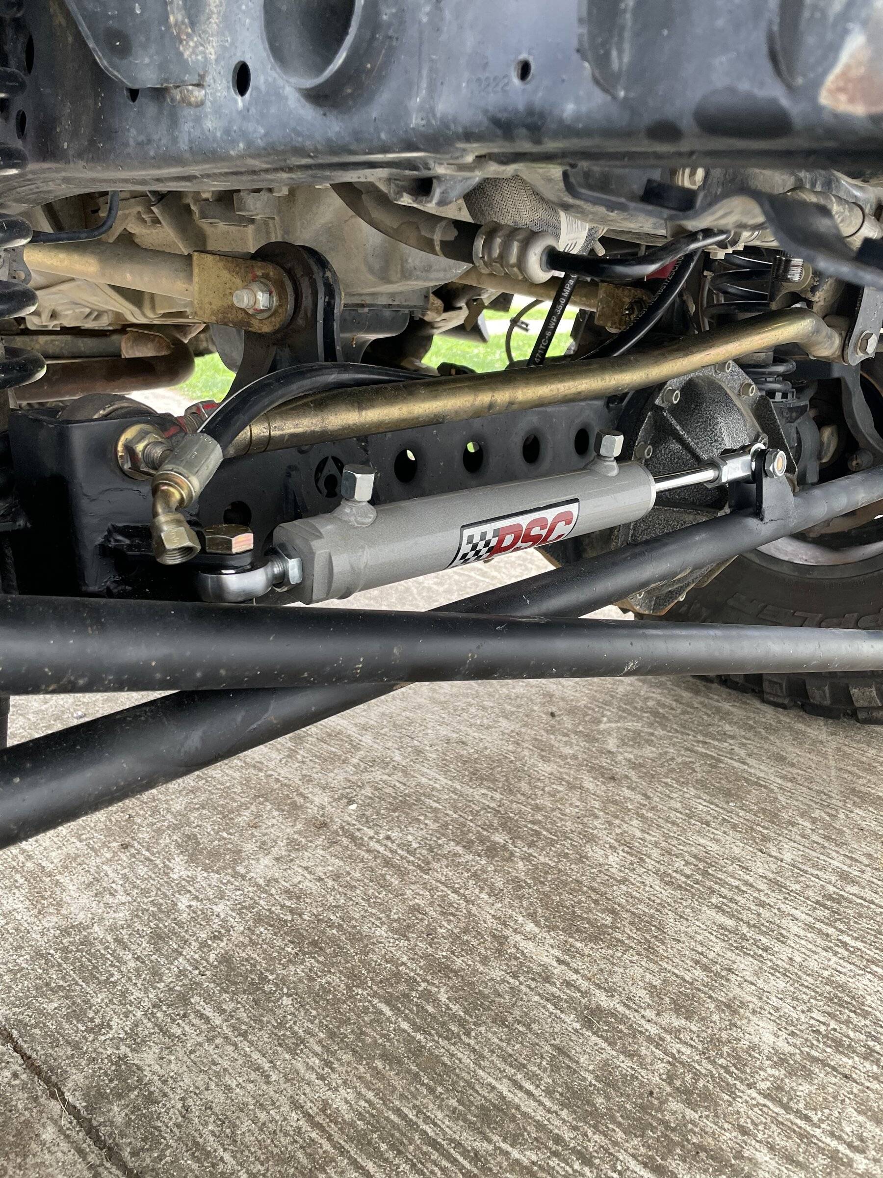

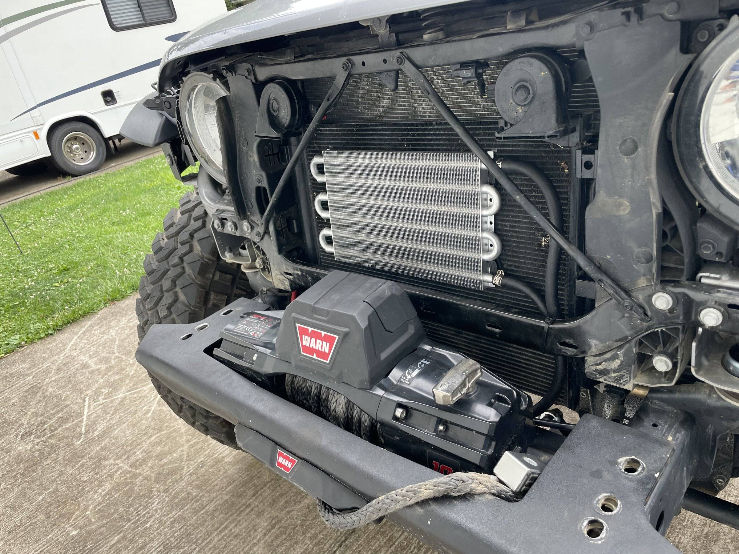

I’ll be doing a DIY post for power steering cooler and Hydro assist soon. Just to help with the new axle and tire weight.

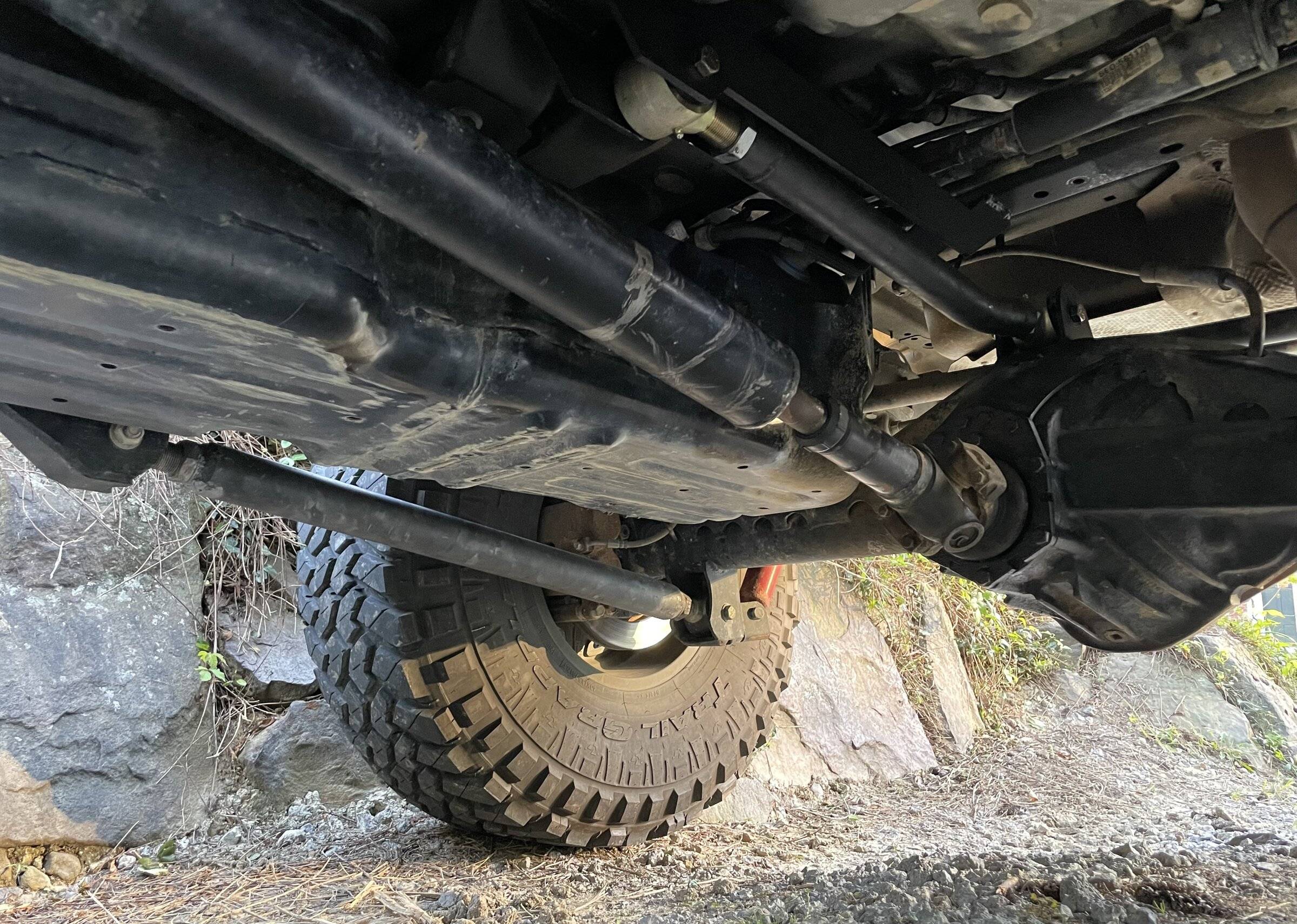

I am running sensors to the rear. Depends what axles you run for this.

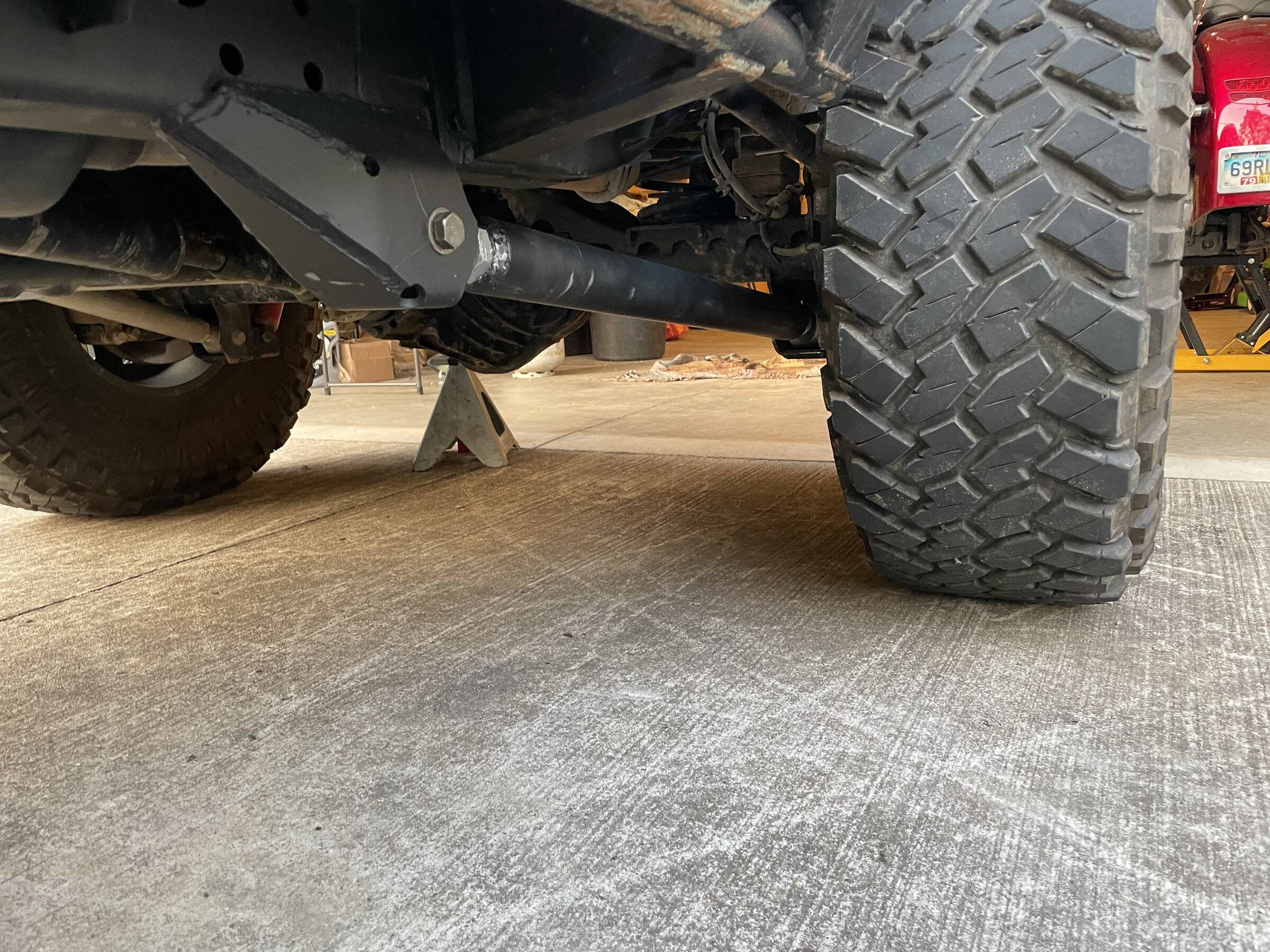

Control arms can be left in the factory positions or moved if you go with a long arm kit. I used artec trusses which keeps the ability to use factory mounting positions

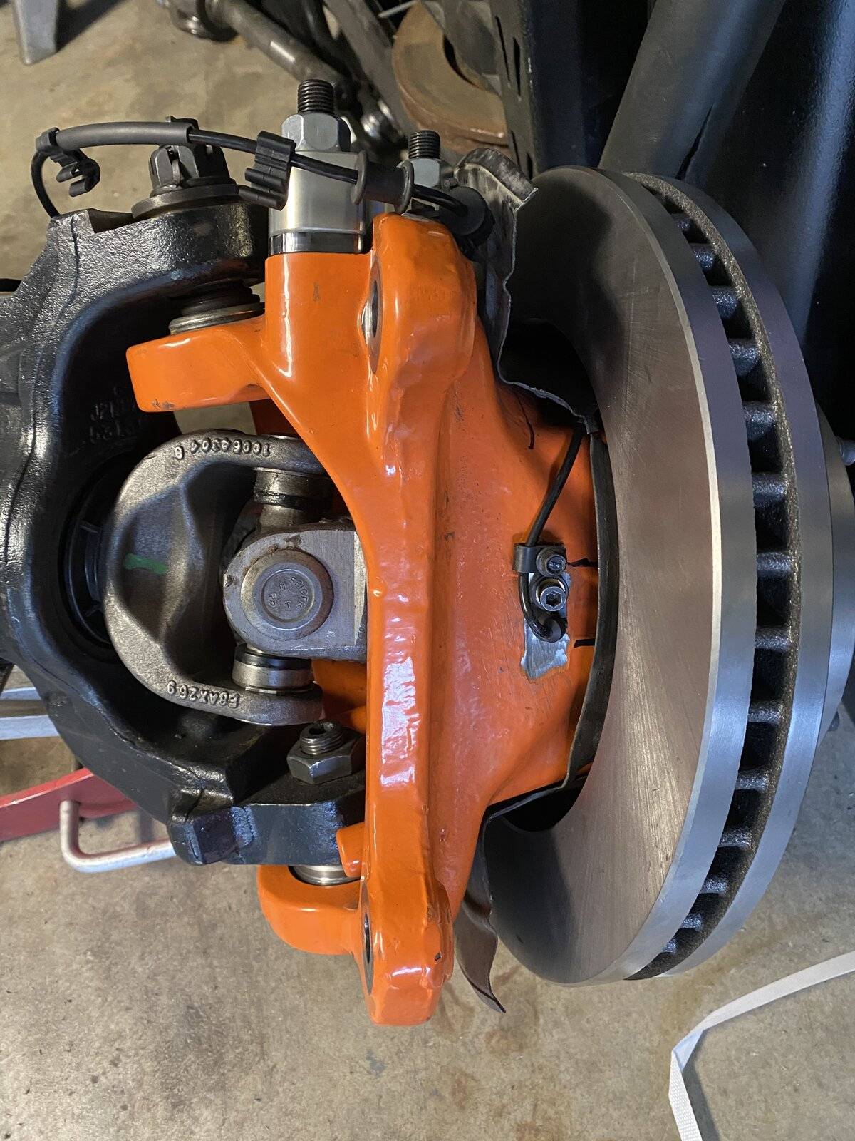

Are you running the artec super unit bearings to get 52tooth on the front 60? Looking at doing this myself (sd60/14b) but I’m getting a lot of conflicting info with the abs and tone rings.
I talked to Tom at Artec last night and he said even with 52tooth tone rings front and rear the JL’s aren’t like the JK’s where you can just use dodge sensors up front and everything works, it still lights up like a Christmas tree.
I’d like to get started on a set of axles here but I’m really stumped on how to approach this. I absolutely want to keep the abs/traction systems working (mainly for cruise control), and just need a solution that works
52 ring front and rear with 8x6.5 lug

jl sensor needs speed and direction. I have 8k miles on mine with zero abs issues .

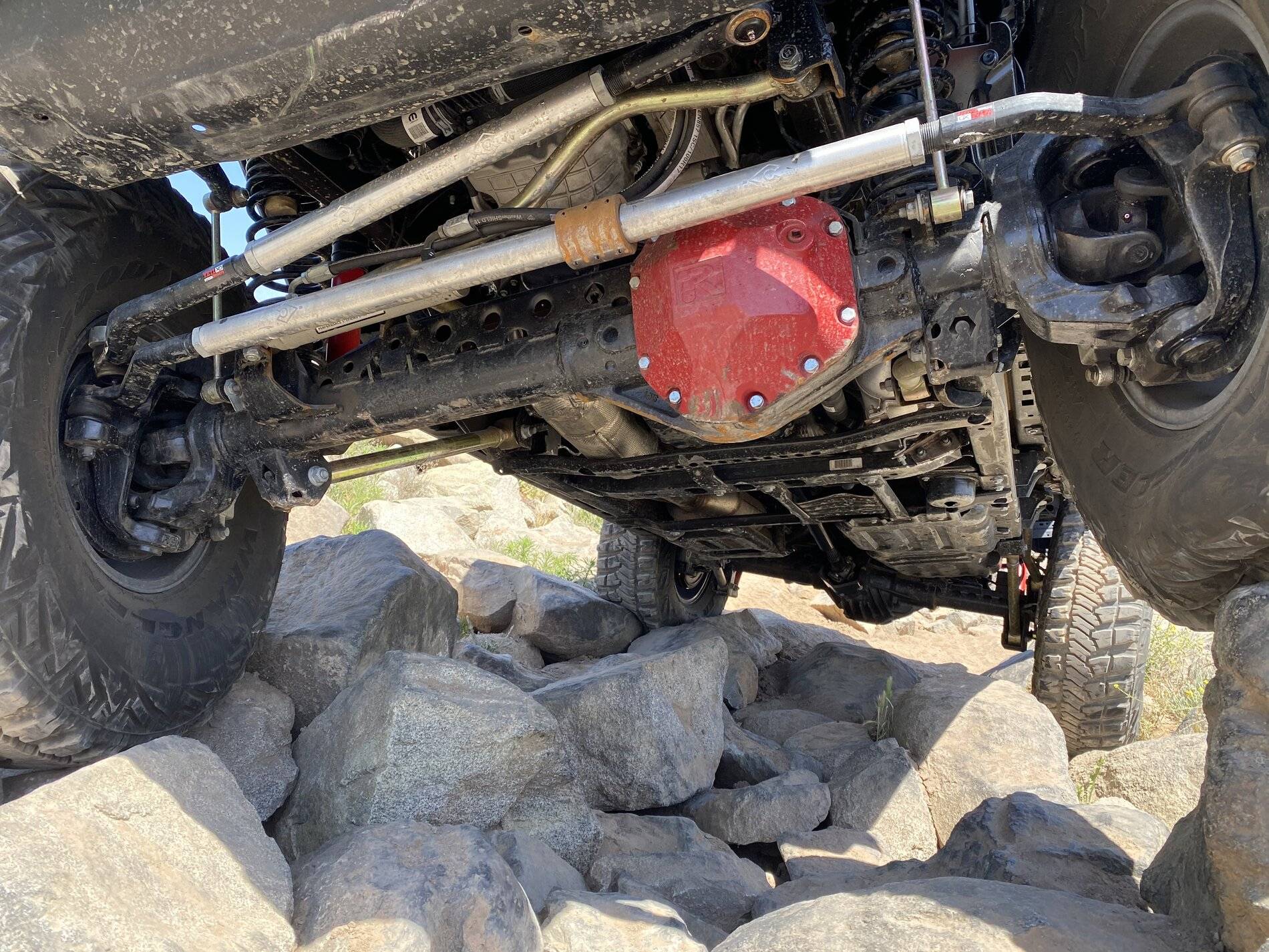

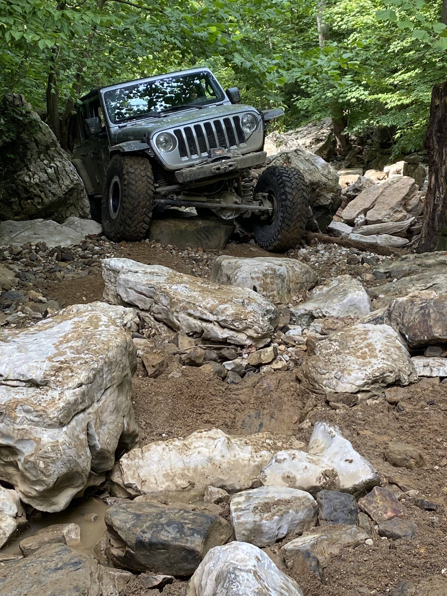

This is the first time ever building an off road vehicle and I have done the gears, bearings, welded the trusses, DIY steering, tone rings, control arms, three link front and rear and now 14 inch coilovers. Lots of research take your time it will come together. Drives 90 mph down the highway and survived some trail beatings. Best mod so far was the Hydro assist steering.
