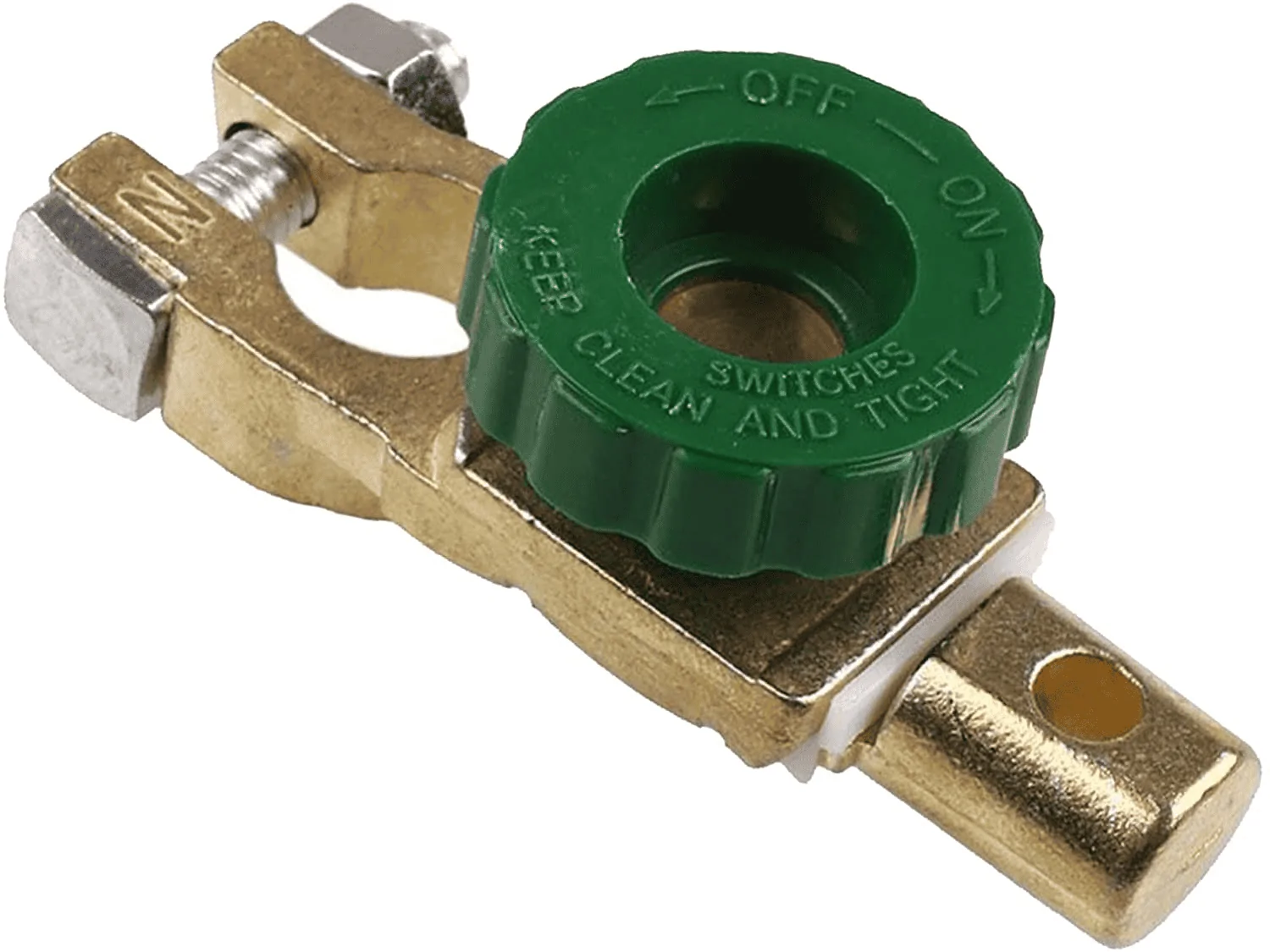

It does require some prep, like cabling that addresses the clearance issues you describe in the PDC. I have some wing nuts on the high amp fuses, carefully torqued to a position that no two wing nuts could touch and make unwanted connections--thereby eliminating the need for a wrench at the PDC.
Yeah, some cable with an eyelit and one end and ability to connect a jumper cable at the other would probably be advised for the positive side of the connection.
One of these could handle the negative side so no tools are required.
