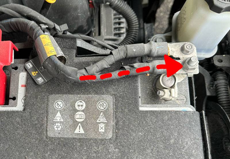

I jumped my 2019 3.6 twice with a portable jump starter, no aux disconnection required. Both batteries tested bad and were replaced quickly, but I'm not sure if I can guarantee a jump pack will work every time in all situations. It worked on mine when I needed it... Audew branded 1500A pack.I've been reading through all these threads preparing for the inevitable day when my Jeep doesn't start due to the batteries.
From what I've read, it's possible to jump start a newer than 2018 JL with a dead aux battery with a jump pack, but you need to "separate out the two batteries". Is removing the aux battery's negative cable all it takes, or does fuse F42 need to be pulled (or the N1/N2 jumper installed) as well?
Also, I just want to make sure, is this the negative cable for the aux battery?
Finally, is it possible to reconnect the aux battery while the Jeep is running?
