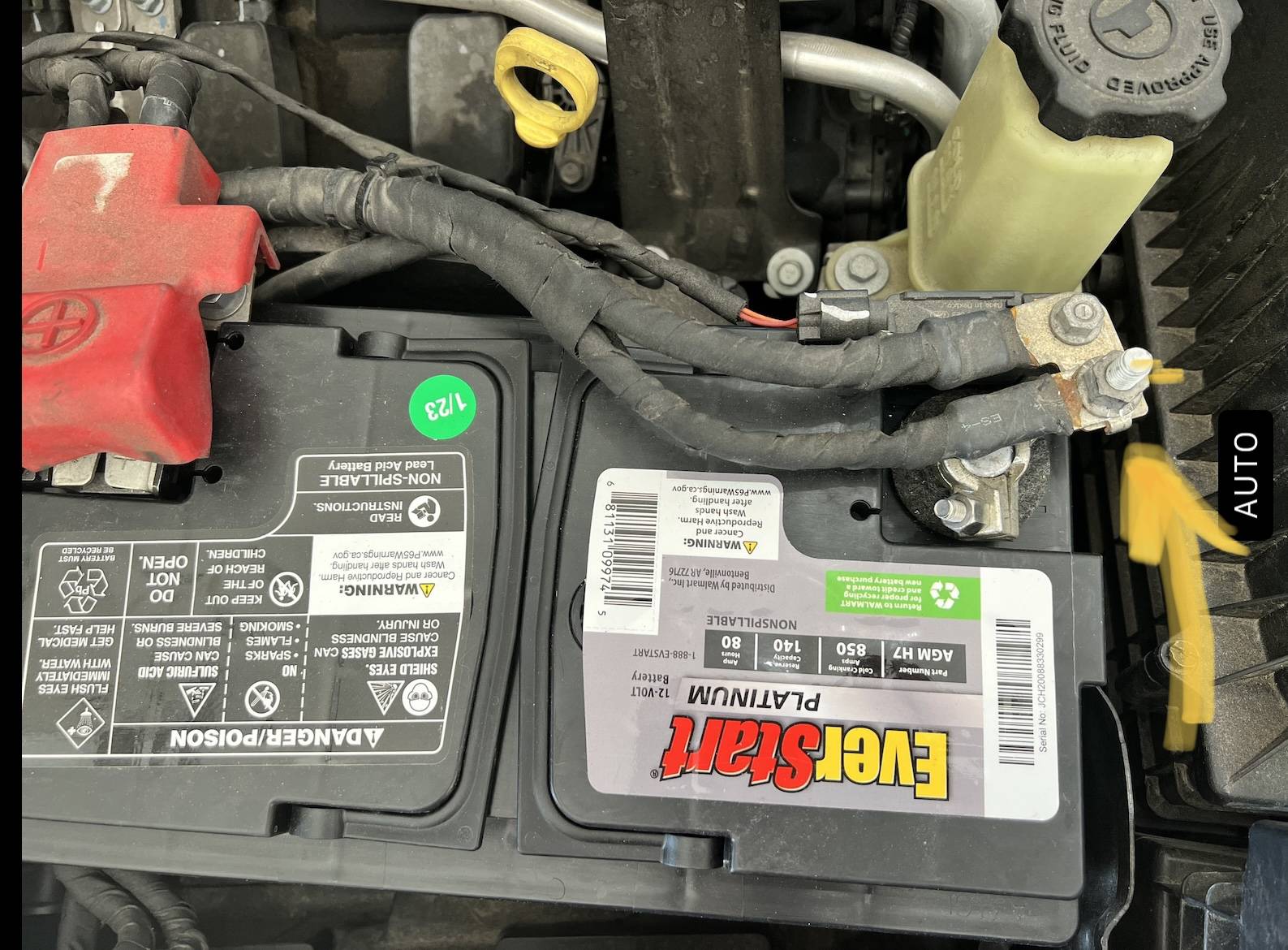

Can someone please confirm my photo below… yellow arrow is pointing at Aux Neg? Almost looked soldered closed? Sorry for the Noob question and thank you all for all the insights on this topic.

Aux negative is always the smaller diameter cable of the two cables attached to the Main's neg side. You got it.

Yes E-4 smaller diameter cable.
