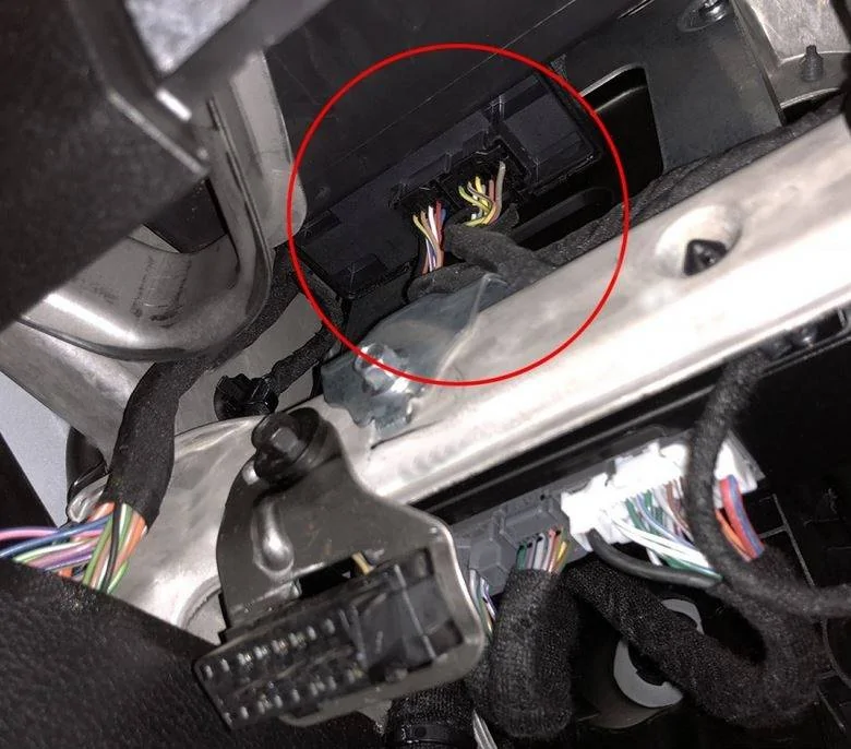

@LSJKU I'm not one to be pedantic for its sake alone, but to make sure that I'm on the "same page" as those I talk to.
With this said, I believe that your SGW extension cable
Jeep Wrangler JL JSCAN 1762700881896-5r
is plugged into your security gateway, circled below
Jeep Wrangler JL JSCAN 1762700932585-vy

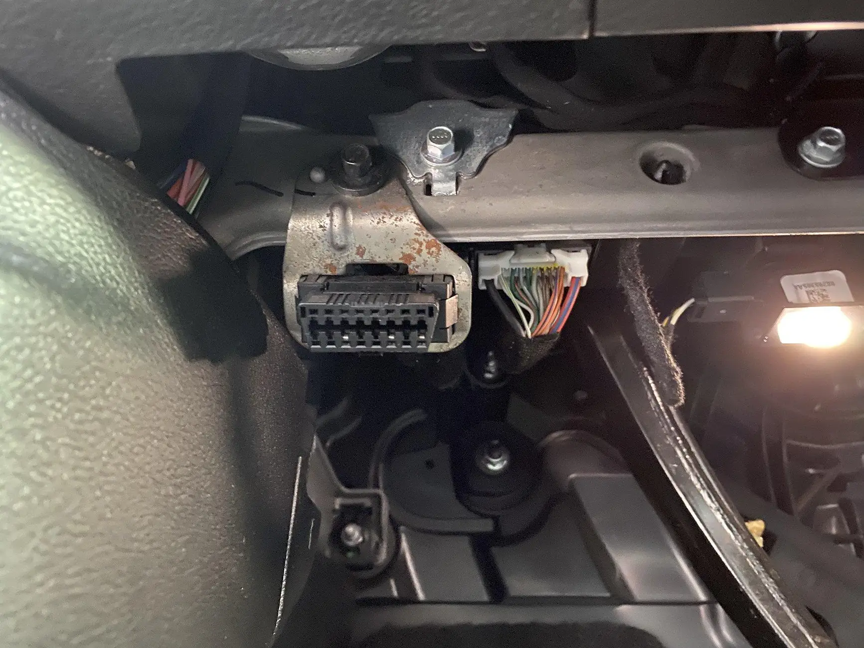

behind the steering wheel, as its 12 and 8 pin connectors don't fit the standard 16 pin connector of an ODB 2 port found by your left knee as shown in either the above photo (not circled) or below photo:
Jeep Wrangler JL JSCAN 1762701063524-gm
I would encourage you to unmarry your Tazer, physically disconnect it, and attached the 12 and 8 pin cables that are freed from this process back into the SGW extension cord prior to a dealer visit.

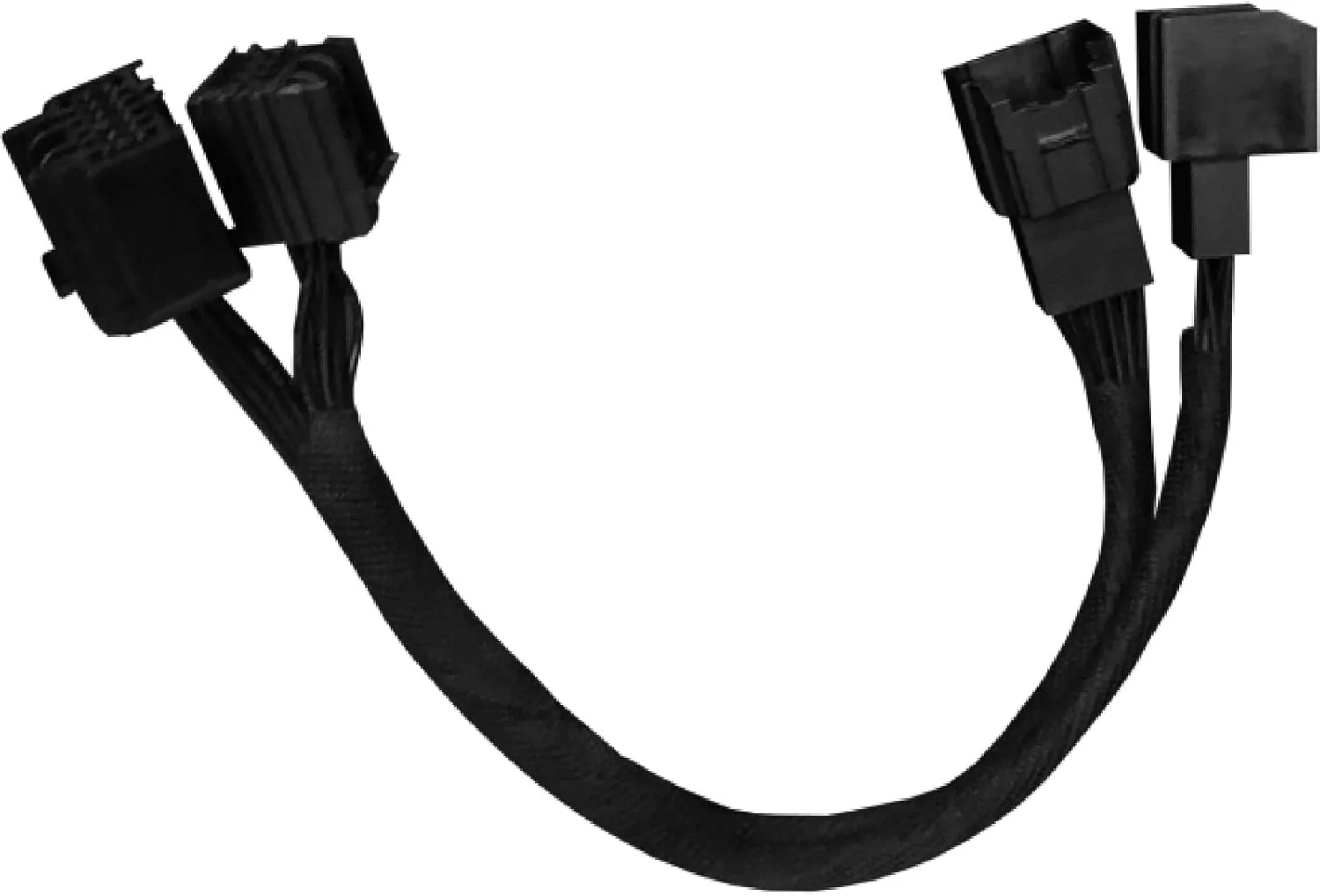

Where the SGW extension cable proves its worth if for people who have a security gateway bypass device like the ECRI, or JL Tazer, or its cheaper somewhat less feature rich sister [product, the JL Tazer Lite installed.
(I suppose those with start stop devices who disconnect them prior to dealer visits also benefit form this extension cord. I'm not sure.)
A narrative describing this may be helpful at shedding light here.
Say you've purchased a JL Tazer.
In order to install it you must removed the factory 12 pin and 8 pin cables from the security gateway. This gateway is not only in a hard place to reach behind the steering wheel but the cables sometimes only release from the gateway with some wiggling.
In to make this difficult disconnection a "one time in ownership" proposition you then plug into the gateway the SGW extension cable.
Then you plug your JL Tazer (which is a security gateway bypass device, or whatever security gateway bypass device you buy) into the freed up factory 12 pin and 8 pin cables, marry the device (if a JL Tazer) and enjoy its features.
At some point, visiting the dealer will become inevitable where disconnection of the JL Tazer is strongly advised. While I've read varying opinions on whether it is necessary to unmarry the JL Tazer first, nobody has told me this is a bad thing, so I unmarry it and then disconnect it.
Thereafter I plug the now freed up factory 12 and 8 pin cables into the SGW extension cable, which is connected to the security gateway, not the security gateway itself . This re-plugging in these cables is necessary for your entertainment system to work and for the dealer to handle h electronic programming aspects of your vehicle. It is this final step that is made infinitely easier by owning the SGW extension cable as will be rehooking up your JL Tazer after the dealer visit.
Without the extension cable I'd have to plug the 12 and 8 pin factory cables back into the hard to reach security gateway, and deal with the challenges some people face dislodging them to reinstall a security gateway bypass after the dealer visit.

The whole point is that the security bypass cables without the extension need to plug into the connectors in the circled picture above. These are hard to access; you need to pull off the dashboard panel pretty much and even then you need dexterity to disconnect the cable.
Better stated, the security bypass cables: those 2 cables, one with 12 pins and one with 8, that come from the factory, need to be plugged into the connectors in my circled picture (i.e. the security gateway) for dealer visits, or to make the entertainment system function if those cables are not plugged into an aftermarket security gateway bypass like an ECRI or JL Tazer.
And when those cables are plugged into the factory security gateway they can be plugged in directly to it, or plugged into a SGW extension cable that is at its other end is plugged into the factory security gateway. Either is perfectly fine, (I'm not sure why you feel the SGW extension cable needs to be taken out of the setup) the latter easier for the access reasons you describe in addition to the sometimes difficulty in removal reasons previously mentioned, which might still be the case even if the factory security gateway was as accessible as the volume control on the entertainment system.
