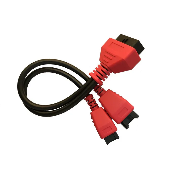

Wait (in mock derision), do note that if you don't buy a security gateway bypass @billjr you will not be able to operate your vehicle's radio during the time that you're working with Jscan and a 12+8 cable.
Frankly, I call this a feature. I'm trying to carefully follow directions when working with Jscan and prefer the silence of no radio on.
Sadly though, the other day I looked at my 12+8 cable and said, "good morning 12+8 cable, how are you today?"
..and this
Jeep Wrangler JL JSCAN 12+8
instantly turned to this
Jeep Wrangler JL JSCAN 12+8fray
like my wife's hair leaving an air conditioned environment into a super crazy hazy hot and humid day (not)

I've never felt the need to have a Tazer mount. The factory 12+8 cables and JL Tazer tuck behind for me without ever falling down. "To each his own."
