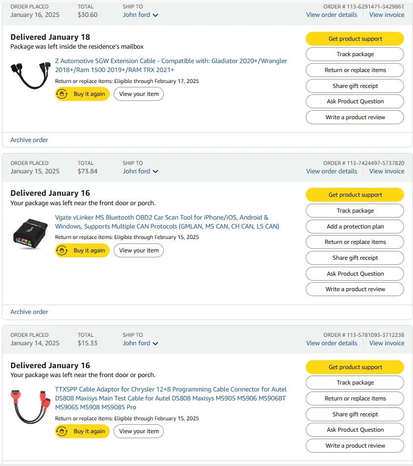

The JSCAN, cable, adapter and license runs about $190.
I'm only going to do passive entry on the driver door using the kit. That runs $250.
I wanted to make sure the $190 I spent on JSCAN would also work on the auto headlamps and the passive entry.
I just dropped 82k on a new F250, so I am spacing out my mod dollars every month.
Jscan license and this will get it done.

You should be able to get it all for under $100 ($20 JScan license, plus sub-$20 12+8 cable, plus ~$60 compatible OBD-II Bluetooth adapter).
