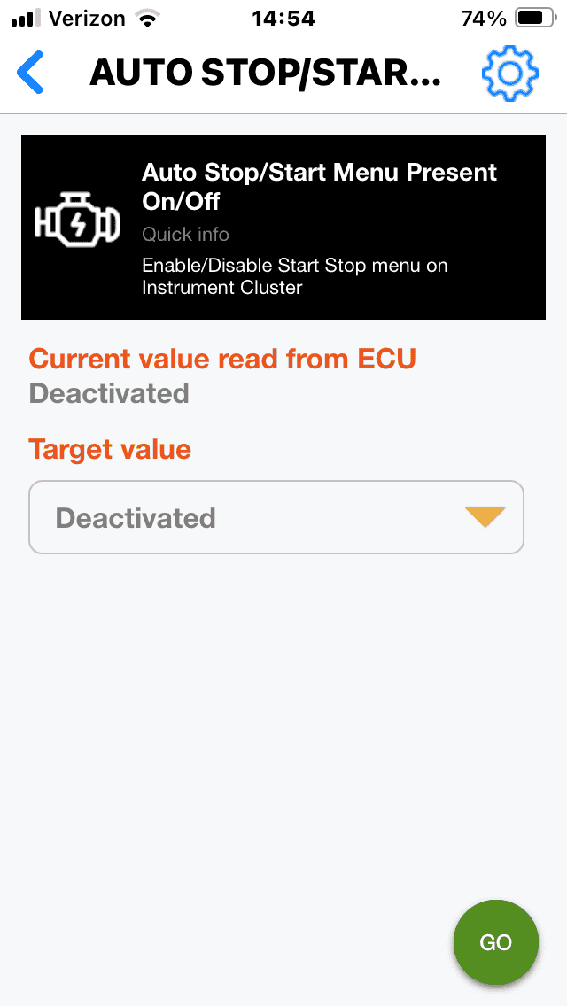

My 36month/36,000 mile warranty expired last week. First thing I did was pull fuse 42 and disconnected the AUX battery negative and taped it off.
I have JScan and a Veepeak BLE+ OBDC reader that I bought last year. I used it successfully to change my tire size in the computer when I upgraded my tires. I also bought the security bypass plug/harness. When I did the tire change I also shut off the ESS settings...I thought. It kept working.

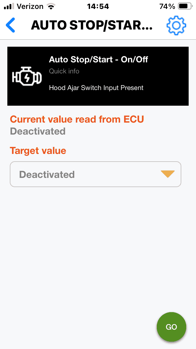

Now that the warranty is off I want to shut the ESS system down without having to push the button on the dash every time I start the JL. I just checked and the settings on JScan show it as disabled. (Photos below) Am I missing another place somewhere in the settings that I have to change? As it's set right now it shows it disabled but it still shuts down unless I push the button.
Stupid question, I just noticed the green GO button on the bottom of the screen - do I have to hit that to make the change take effect? It's reading deactivated when I start up JScan. Or, do I have to leave the security bypass plug/harness connected all the time for that feature to work?

Not sure, but from the text in that setting it looks like you just disabled the Start/Stop menu from showing up in the cluster and not disabling it in your tune. I'm not that familiar with jscan though. I've just used it to clear codes

The bypass plug is not going to affect ESS. You'll need a Tazer or another standalone device that will keep it off. Is it fuse 42 that is supposed to disable it? I saw a thread but don't remember which one. If you have a 3.6 I have a Pulsar tuner that will give you more power and keep it disabled. Pm me.

I strongly discourage you from using JSCAN to deal with ESS..
I am pro JSCAN but again, discourage using it for ESS.
JSCAN's way of dealing with ESS is very lame and is not a way to go in my opinion. You end up with always looking at an Evic warning, remote start usually won't work, and more..

I forgot to answer your ?.
You do the setting with JCAN and that is it. No need to leave the security gateway bypass in place.
Yes, on the green GO!
I encourage you to buy a @SmartStopStart.com SmartStopStart unit ($99) if you want an adjunct to in essence do the ESS button push for you. Many here use a SSS unit.
Please do not buy a knock off of the SmartStopStart unit on Amazon as they are known to hiccup on occasion, etc..
Also... even though you did the Aux bypass, you will see that ESS does still work.

If you look carefully on JSCAN. It will tell you that you also need to remove the hood switch to deactivate ESS. I believe it is the switch closest to the driver side of vehicle. This will also eliminate remote start.
