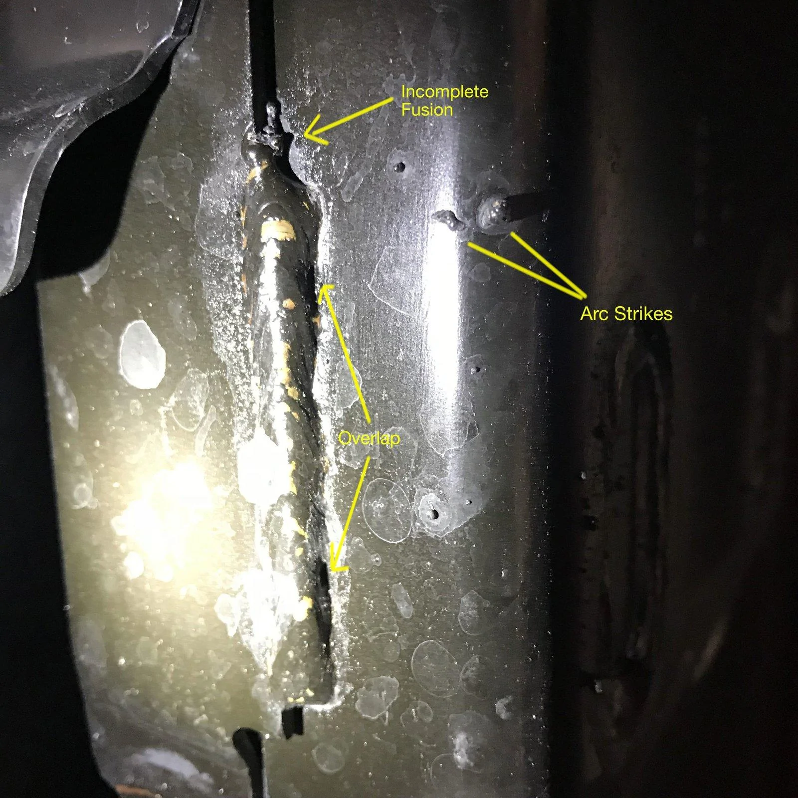

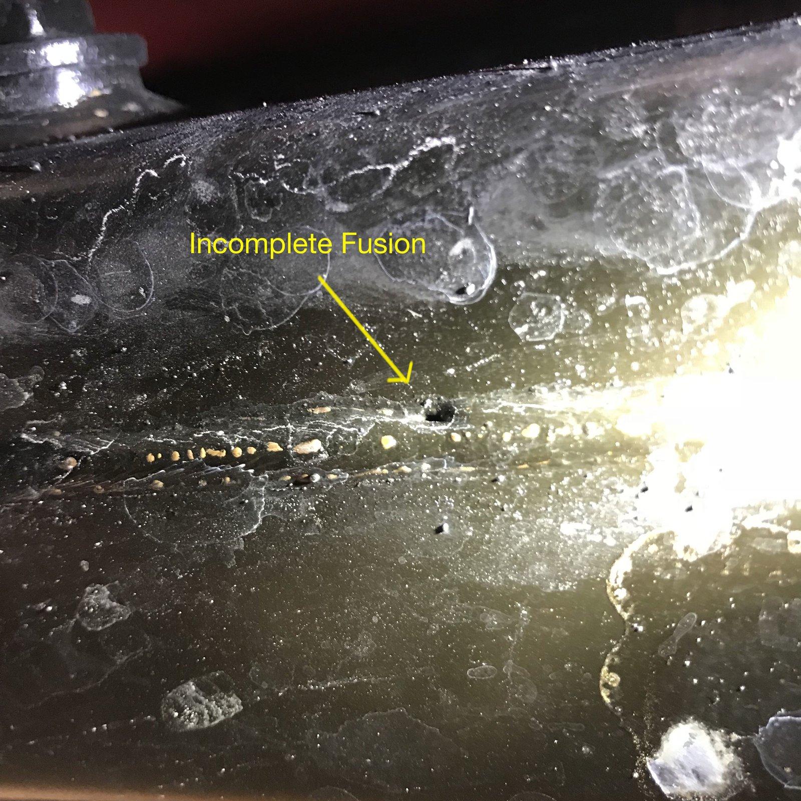

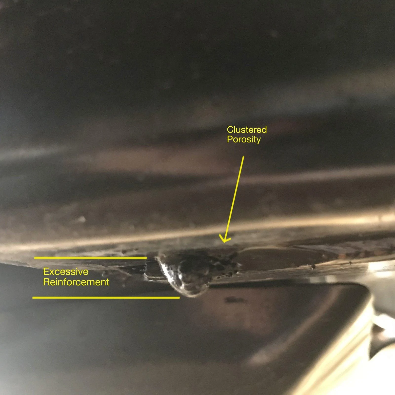

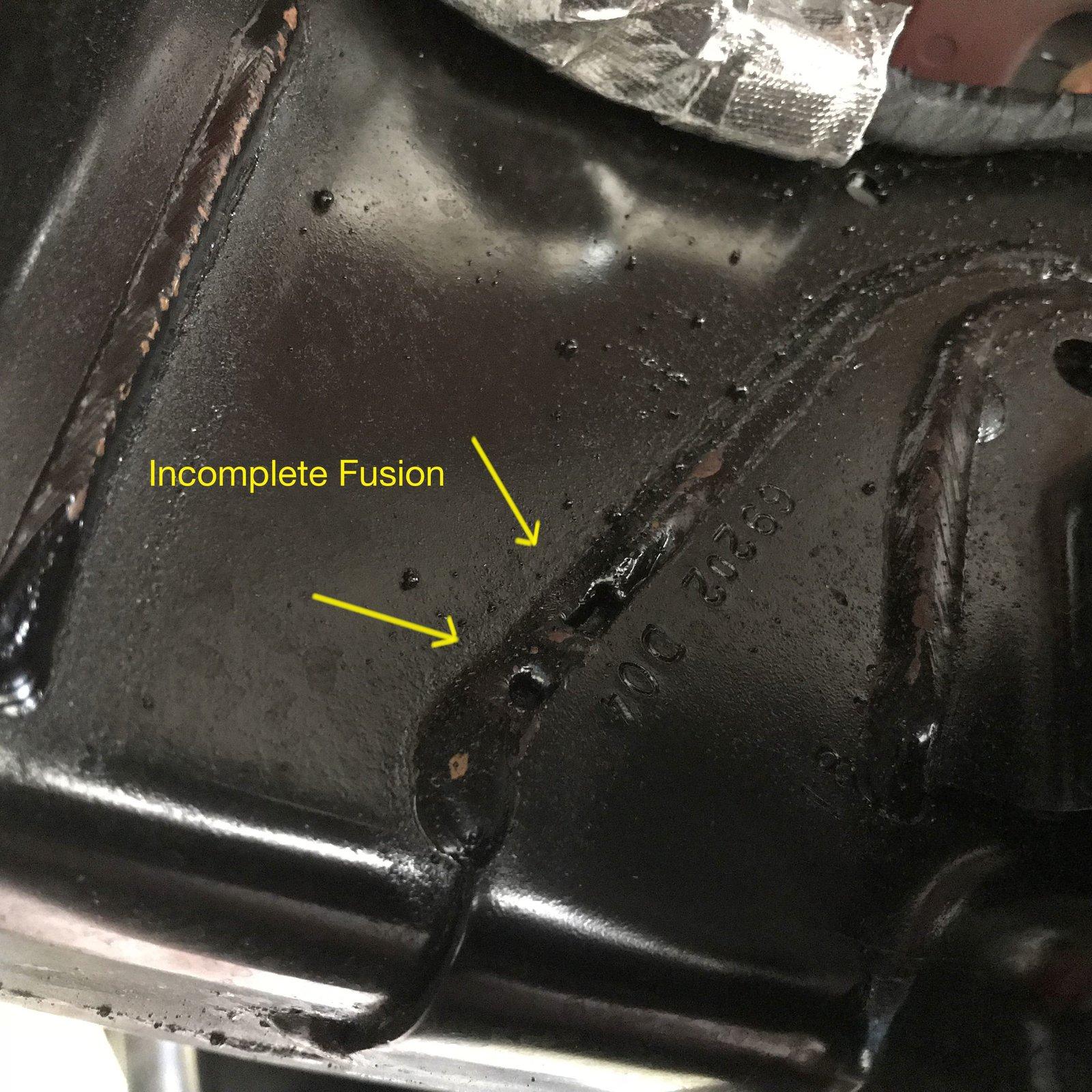

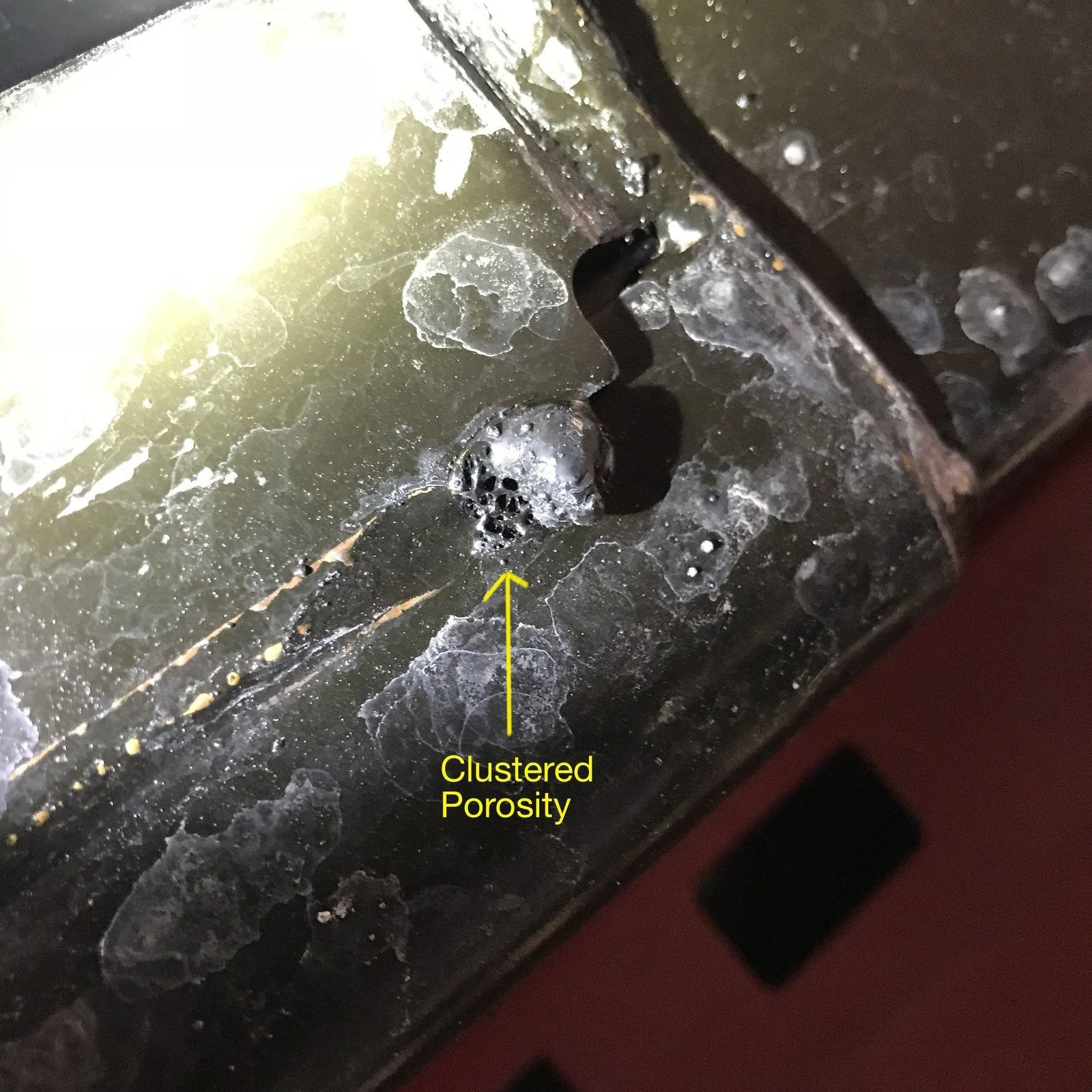

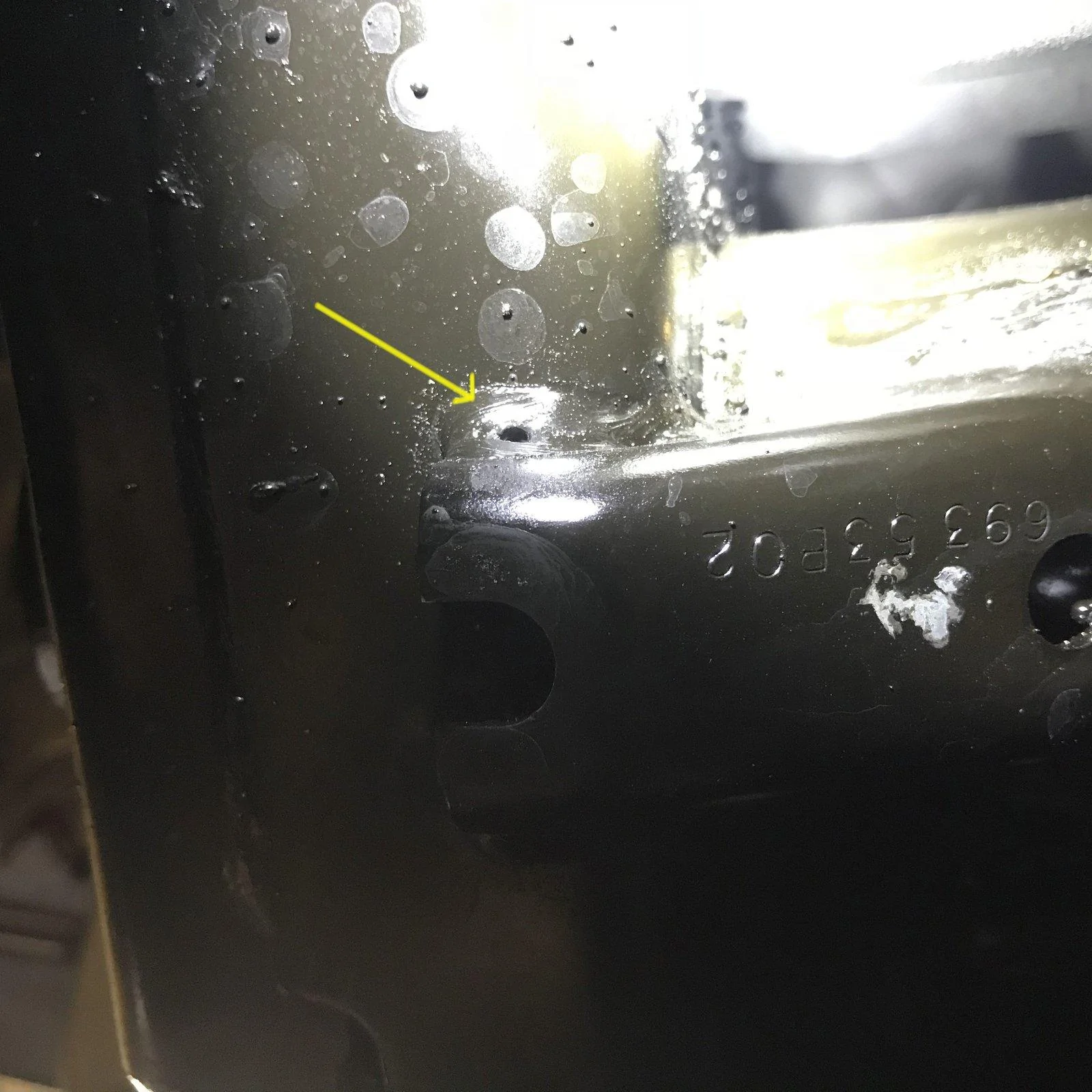

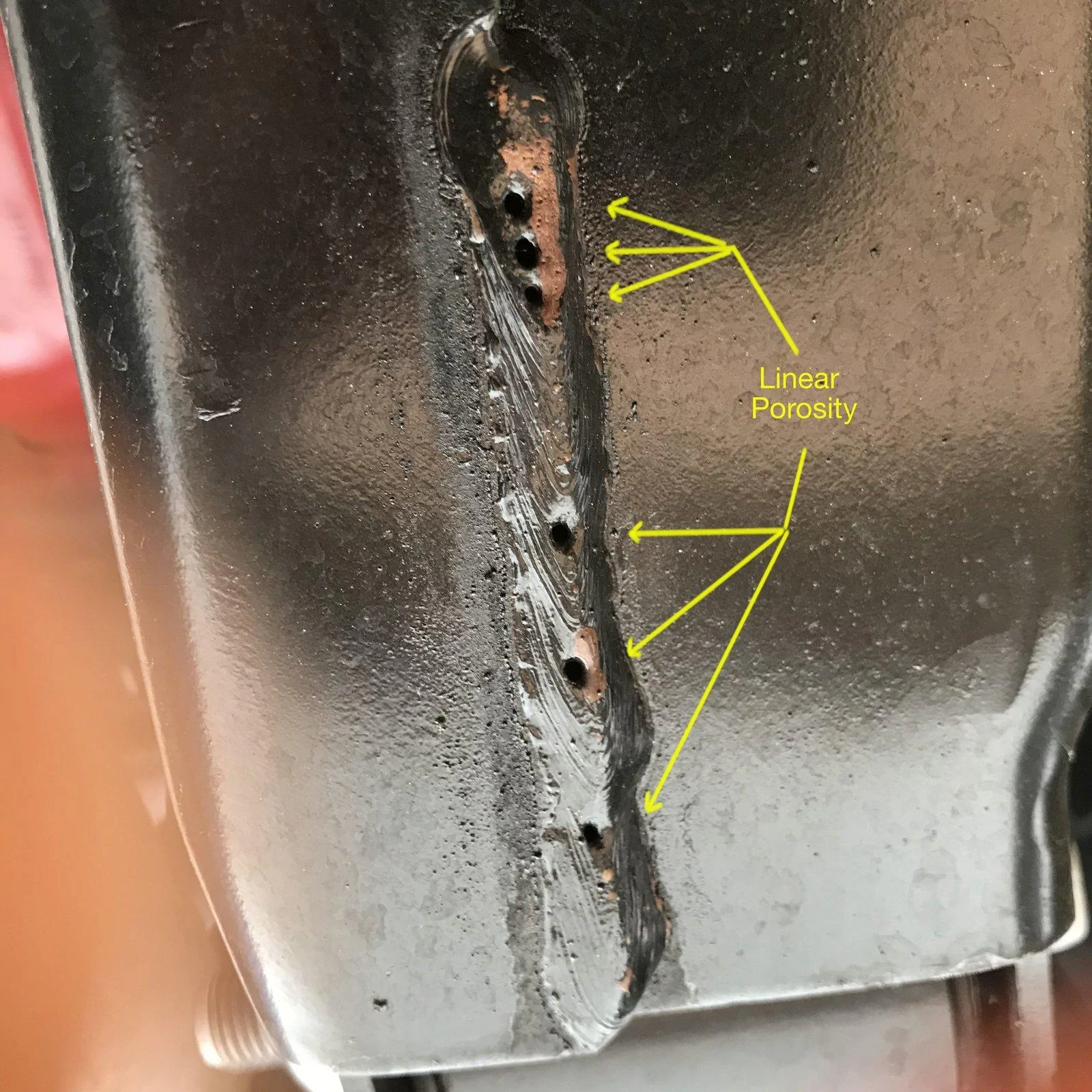

As a CWI, I checked my frame welds and found a lot of weld discontinuities and these are just the ones I have access to and can see. As for the frame being an integral part of the jeep these welds should be sound and complete. For a $50,000+ Jeep, I didn't think I would have to QC my own vehicle.
Looking on this forum I see two track bars failures with a possible third, I do have the X marked over my track bar like others do, but was that the only thing they looked at on these frames.
Going have to make an appointment with my dealer but I have vacations coming up where I need the Jeep.
FYI, Jeep was built first week in July.
Here are some of the weld discontinuities I found on my Jeep, I left a lot of photos out as it was starting to get repetitive.

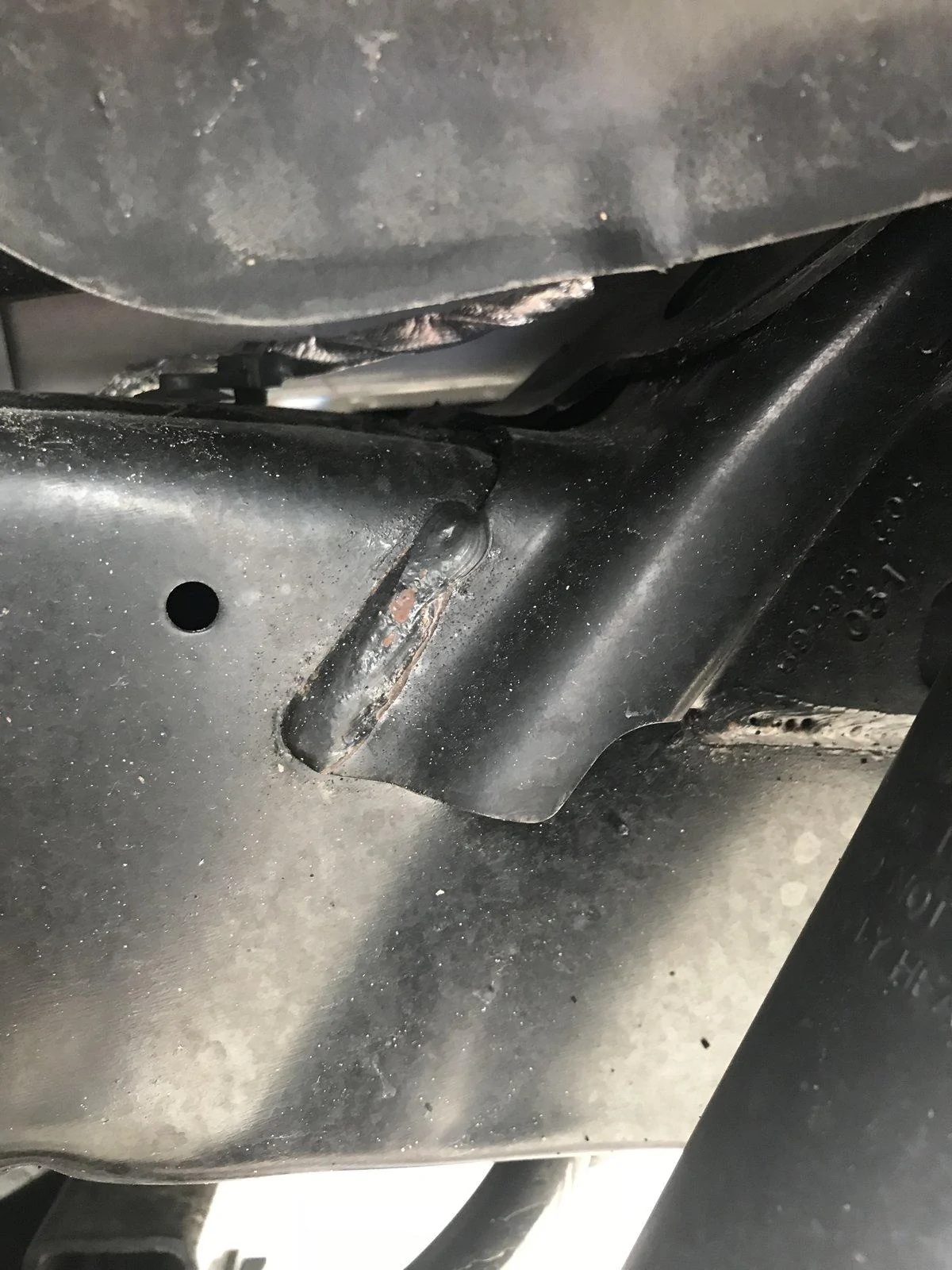

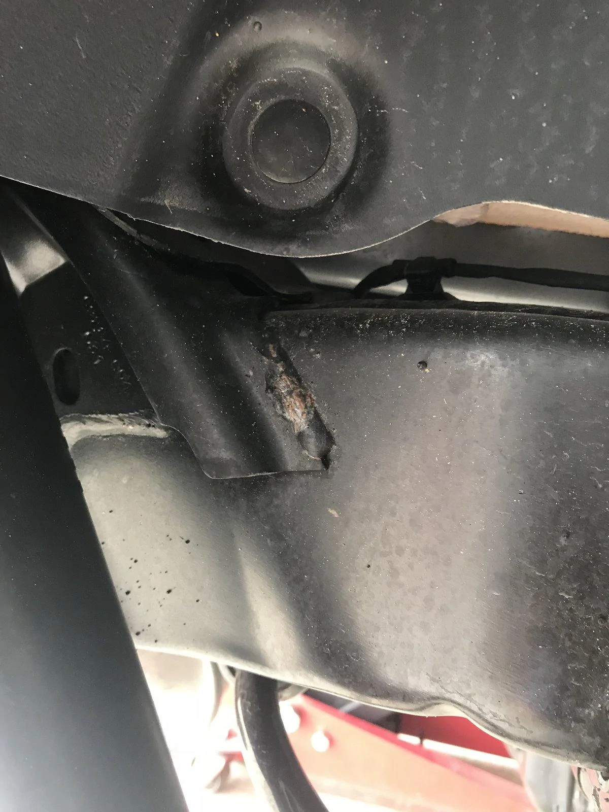

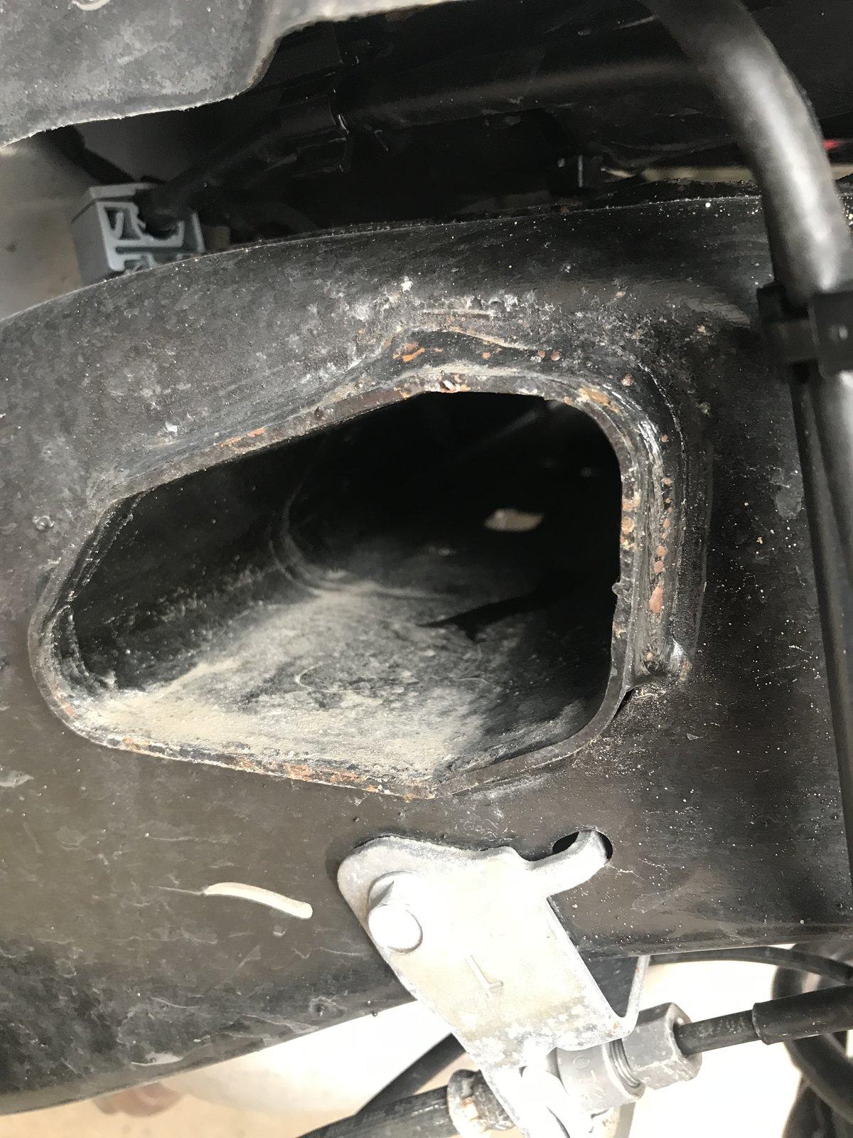

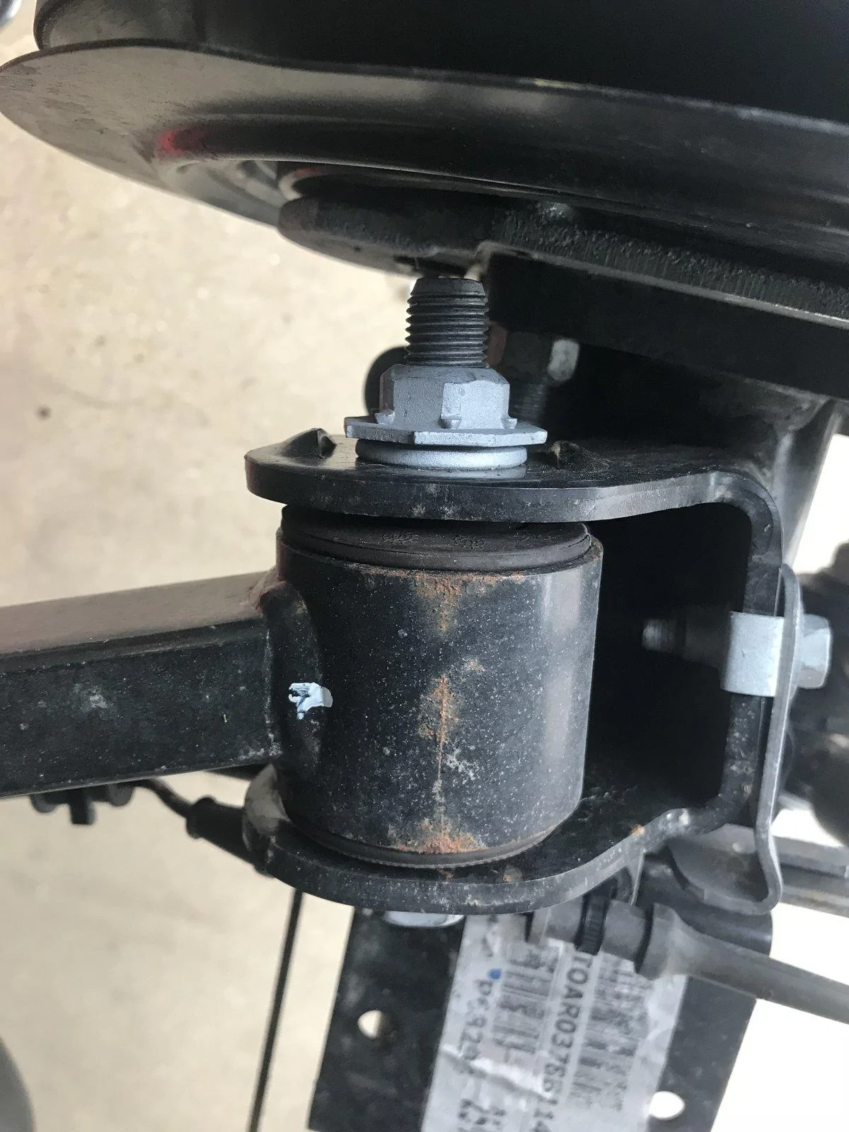

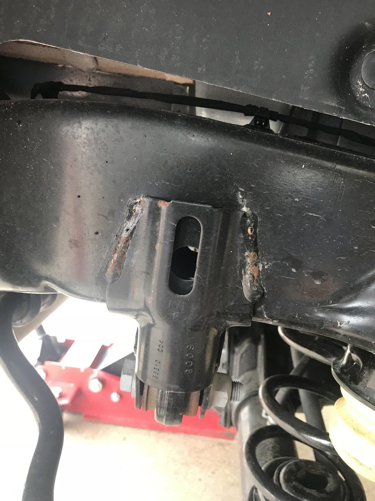

Noticed this today after changing wheels. After reading this thread I was concerned. Took it to a north Texas dealer and they lifted it up, took the wheels off and snapped several pics. Delivery date to dealership 2/2018.
Purchased 9/22/2018
I’ve only put 147 miles on it and have in
2018 JLU Sport S
They said they would contact Chrysler and get back to me on Mon/Tues or once they hear back.
Do I need to contact Jeep Wave or the Federal Safety people to report?
Both , and make complete documentation , including who and when at which dealer .

Thank you. Will do. I took my own photos and then they took photos themselves. Actually they took A LOT of photos and found more spots than I did. They said it was the first one that they have seen.
I'll make a call to Jeep Wave and NHTSA.
