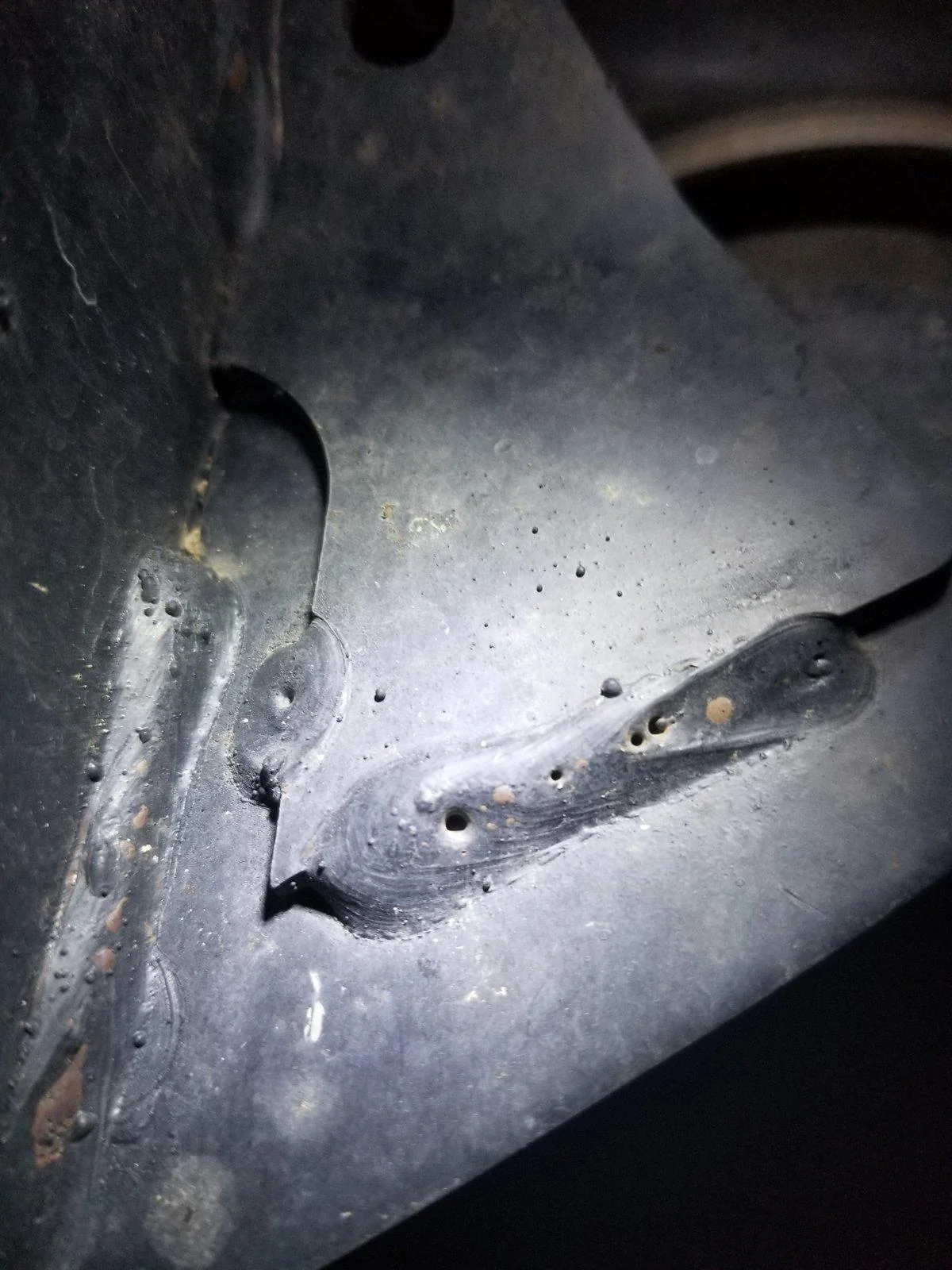

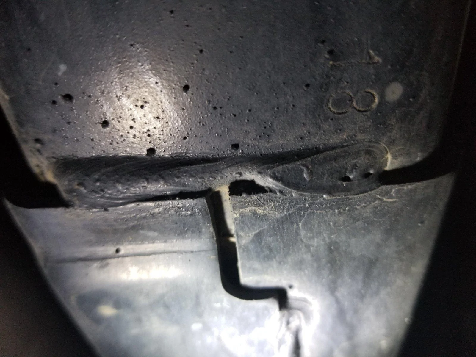

Hey eveyone,
So my JL has shown up on the recall list I checked the welds, some are significantly better than others, especially the front to back.
I called into FCA they told me the recall was just announced, and that no resolution was available yet.
So I took it into my local dealership in MD, at first they wouldn't even look at it since a replacement "part" wasn't available... I has to explain the recall to them as they didn't even understand the issue.
Finally I convinced them to put it on the lift, but refused to give me a assessment of the welds as they said they are not qualified to inspect them. I asked if it was safe to drive since my wife drives it during the week with the kids, and they said I have to make that determination.
Can everyone take a look at the attach pics obviously you will see some in great shape others not so much but I am not sure how bad they are.

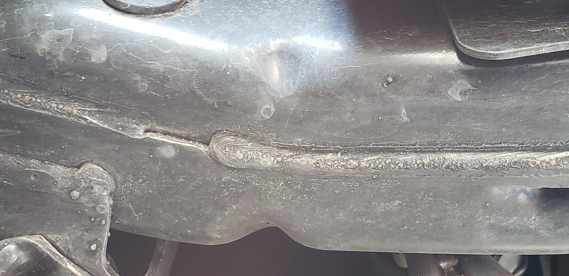

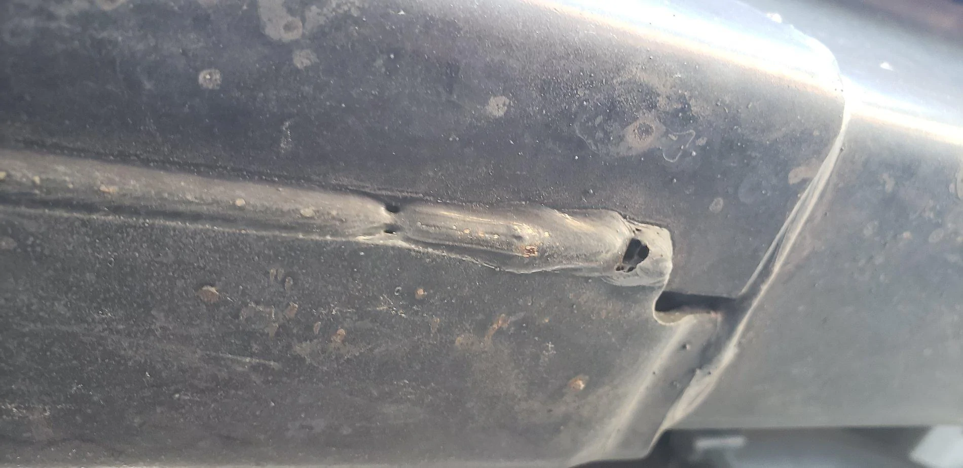

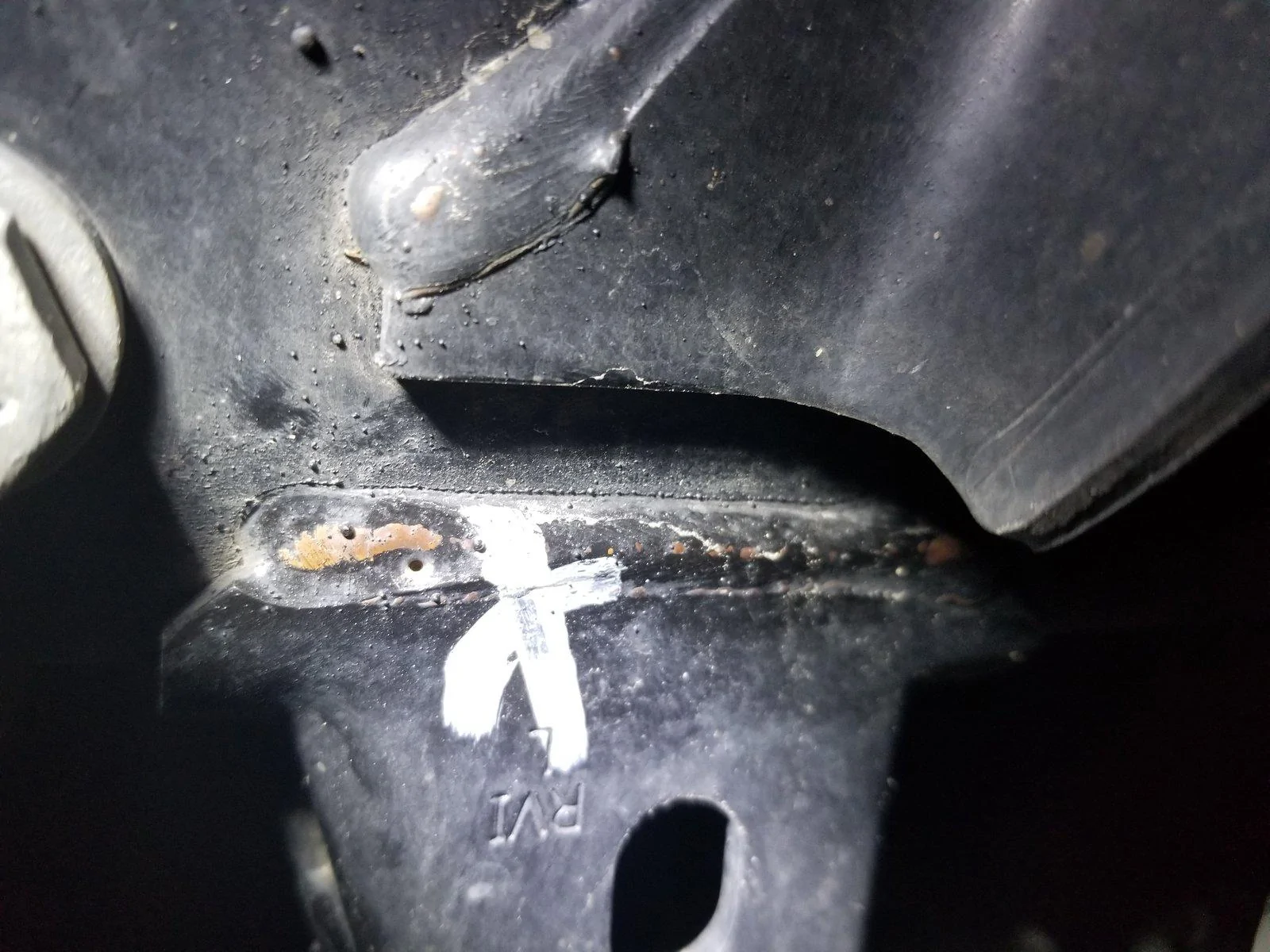

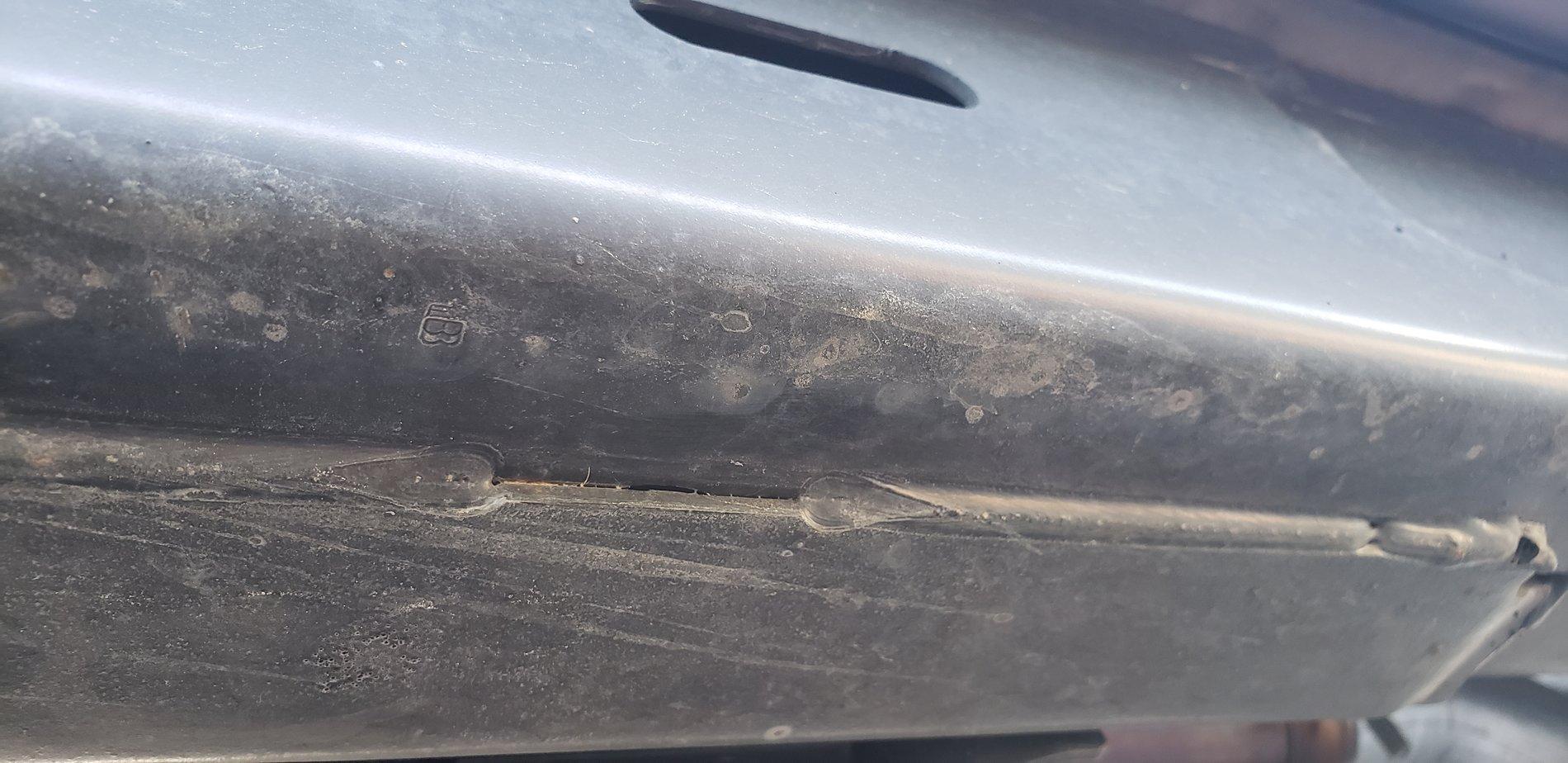

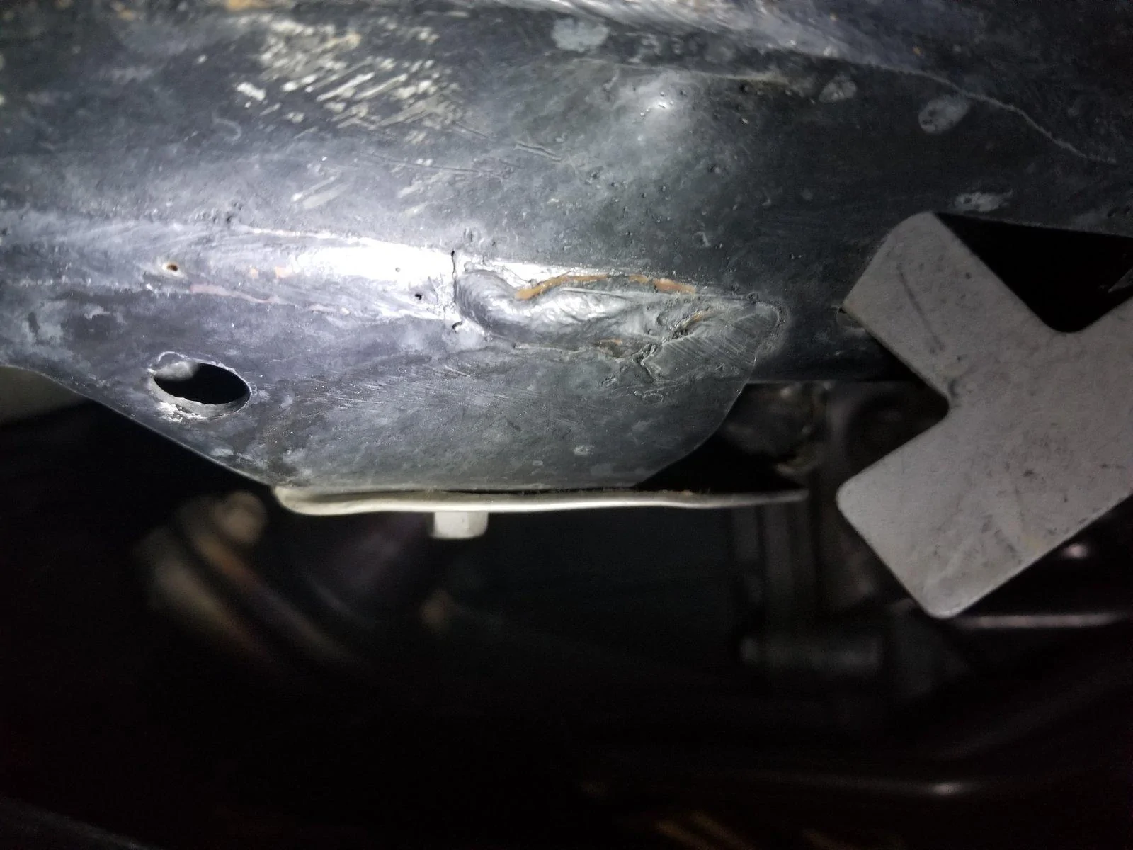

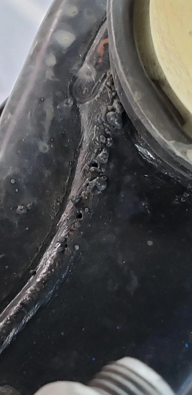

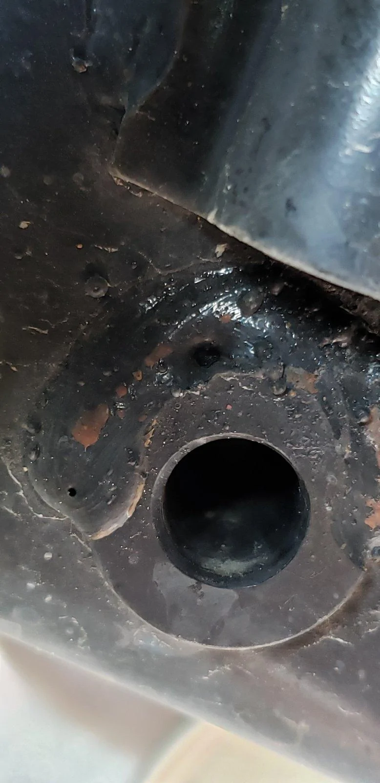

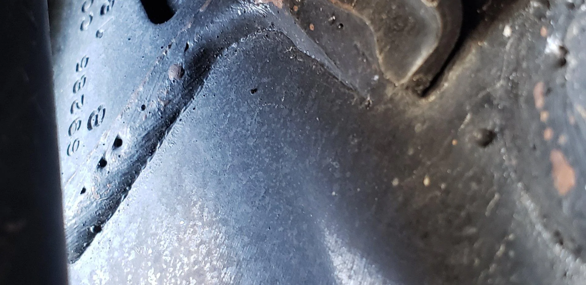

Alright so here are a couple of welds I can see just from getting on the ground and looking. If you ask me, all of those I posted have one issue or another. Dealership is going to put it on the lift so we can see how many more there are. In this scenario, do you think I should seek repair or buyback? This is also on top of a crap 5in radio that's full of bugs. All opinions welcomed! And if most think repair, should I be compensated some how?
REPAIR OR BUYBACK!?

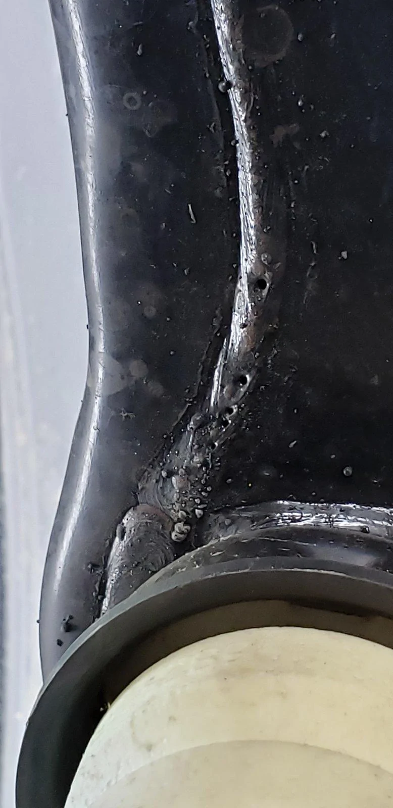

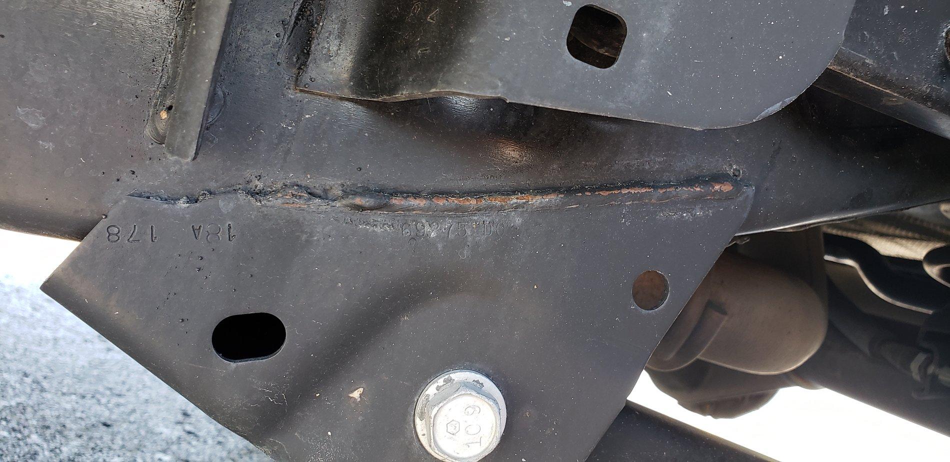

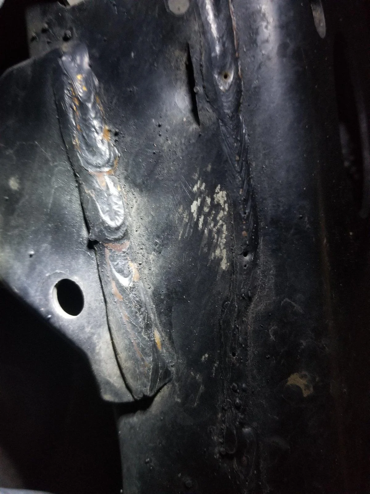

Jeeps been at the dealer for a week now waiting on FCA welding repair tech to fix my bad welds.
The dealers techs admitted they are bad after I showed them the paperwork for the 6.4mm per 25mm check.
It would help a lot of people posted their weld pictures with a ruler beside them.
Here's my back driver bracside LCA bracket to frame weld.
The dealer tech admitted it was bad. Told service agent to send pics to FCA. FCA put a hold on the jeep til their tech gets to it and fixes it.
FCA lvl 2 support hasn't given me an ETA when they will have the tech there to fix it.
NHSTA investigator has received my pictures and wants to see the pictures after the repair.
Sorry for reading ANOTHER frame weld issue thread.
I am pretty sad, my Jeeps been at the dealer for a total of 20 days on 3 visits now.
Replaced batteries.
Repaired radiator leak
Now frame welds.
Jeep Wrangler JL JL welding Issues IMG_20200120_124855

There is a way to verify credentials online, but I don’t know of a directory where you could just search for local CWIs. It’s important to note that the majority of CWIs don’t engage in consulting work. Generally, someone gets a CWI license so that they can evaluate welds as a part of their existing job. I would bet most CWIs use their credentials in addition to welding for a company. There are people who use their CWI credentials and act as consultants, but they are a much smaller population. I actually work for a materials testing laboratory. We do consulting work, failure analysis, materials characterization, etc. A big part of finding one is finding someone near where you live. Generally speaking, hiring one won’t be cheap.
A CWI would not be much help. To validate a weld they would need too much information that isn’t at hand. Training records, material certifications, part fit-up, and more.
jmcf1949
Jim
Jan 19, 2020
Garden City, MI
Chevy HHR
Probably not likely they'd replace the whole vehicle, but you never know. Not to oversimplify things but it wouldn't be terribly hard for a dealer to swap frames if FCA approved it. Toyota was swapping frames on some of their trucks years ago due to some quality issue. Forget if it was the T100, Tacoma or early Tundra's.
If anything FCA will swap out the frame. Not a terribly tough job with proper equipment.
If there are just a few suspect welds FCA standard repair procedures say grind out and re-weld with a similar method that was first used.
