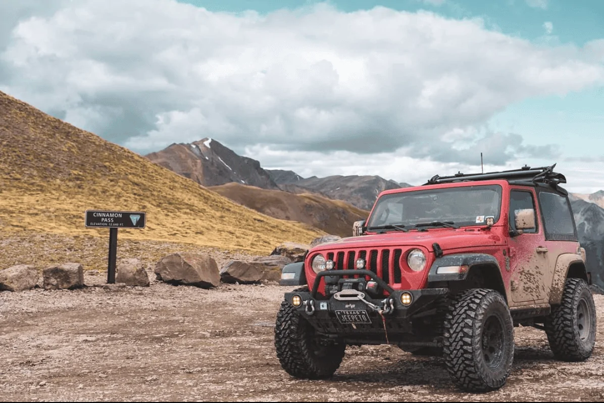

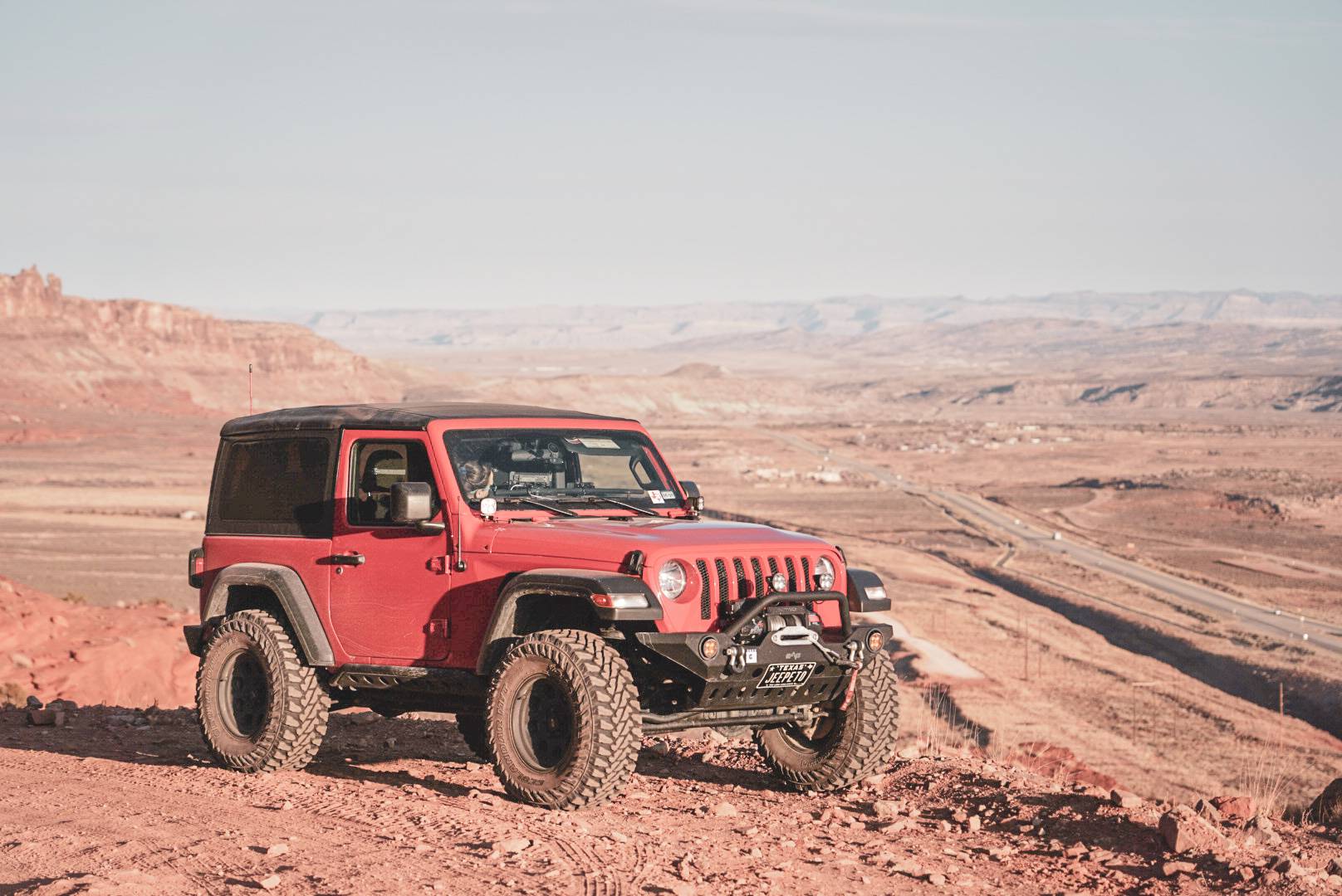

I’ve been running the Dynatrac Endurosport lift since 2019, so far it’s been great. However, I’m currently looking into upgrading to a Metalcloak suspension system based on great feedback and seeing/experiencing it in action.

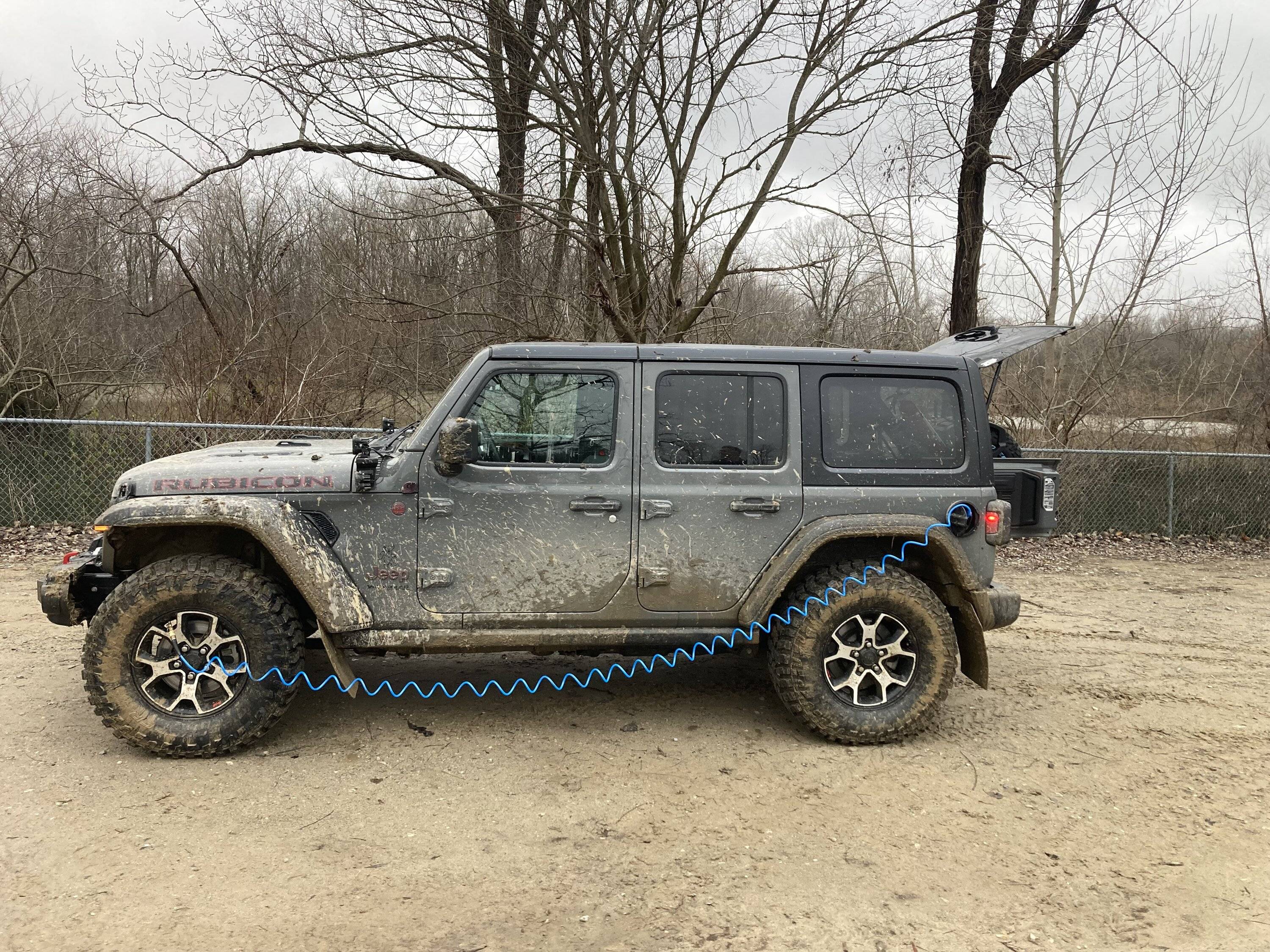

I’m running 35s no lift on a diesel and it flexes to the bump stops without rubbing at all! I have chopped the front fenders. I like the stock suspension.
