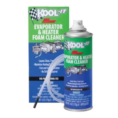

I've used Lysol many times. The effect is mixed. If there is little mold buildup, it will work well enough. If there is buildup on the evaporator, the foam cleaners made for the job work better. The foam actually cleans the mold off . Lysol can't do that.
I've used these two products with success.

Is there a video on how to use the foam? I don’t know how to gain access to the evaporator.

I agree.... but do YOU know how to use/apply these products correctly to a JL/JLU/JT... to get the product properly to the vehicles's evaporator. If so, let all here know.. explain the process. Thanks..
To say like mentioned by another here to ..... "remove the blower" is not helpful....l without giving a guy/gal at least some idea what the task entails..

Got it. Unfortunately, I haven't had to do this treatment to my JL. The last vehicle I did this to was my 14 Camaro.
With my camaro, I removed the cowl cover in front of the the windshield. From there, it was a direct access to the evaporator core.
I'll take a quick look at the JL and see what I can find.

So, I looked at my Tech Authority Service Manual. It says to drop the blower motor, remove the filter, plug the drain, and squirt 3 cans of the Mopar AC evaporator coil cleaner directly on the evaporator.
1 can will probably do, but yes this is the best plan of action.
