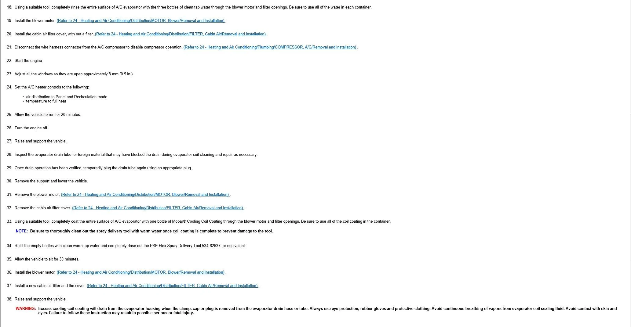

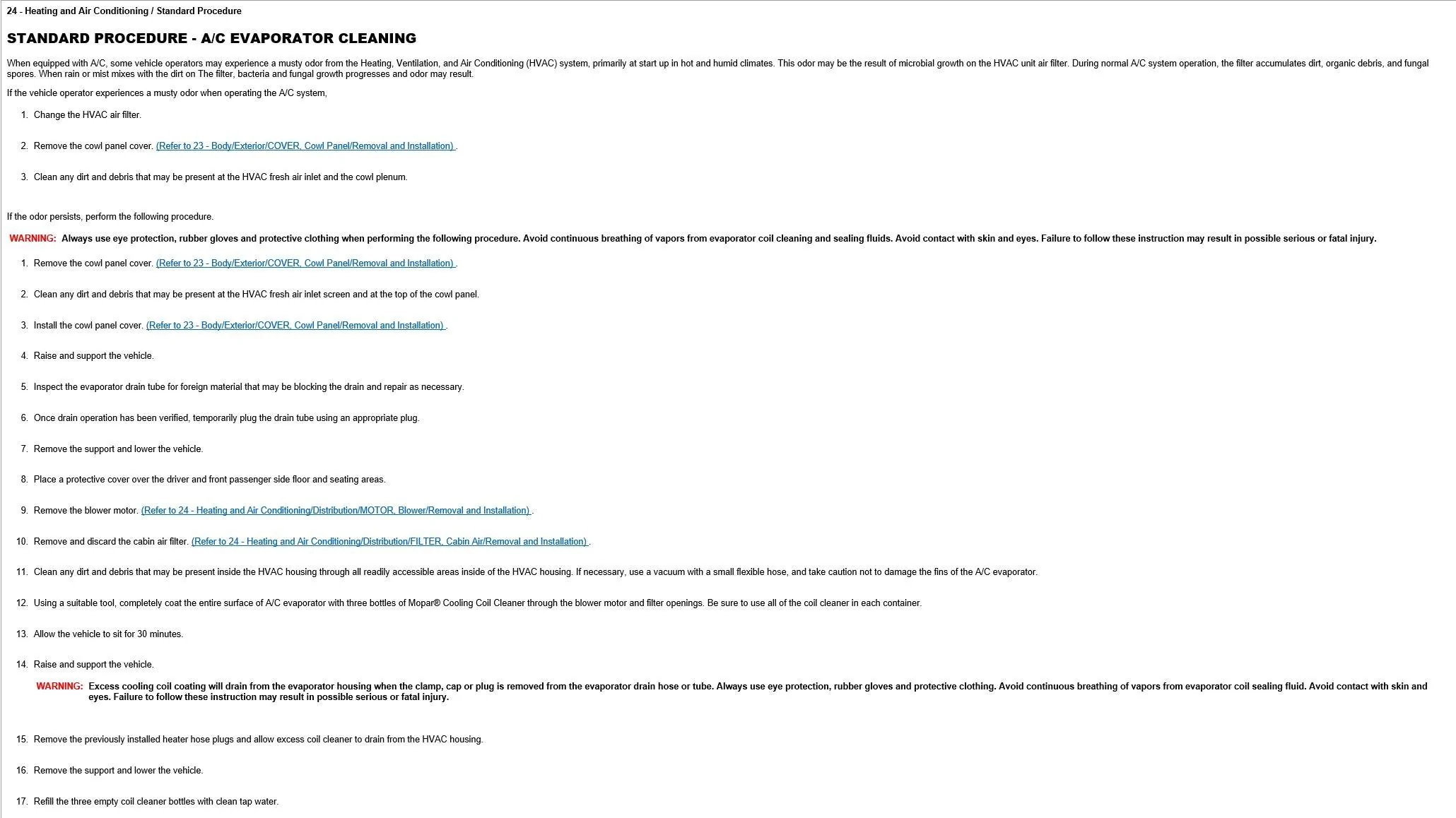

The blower motor is under the dash on the passenger side and you should be able to drop it easily according to the manual (other pages I didn't post).

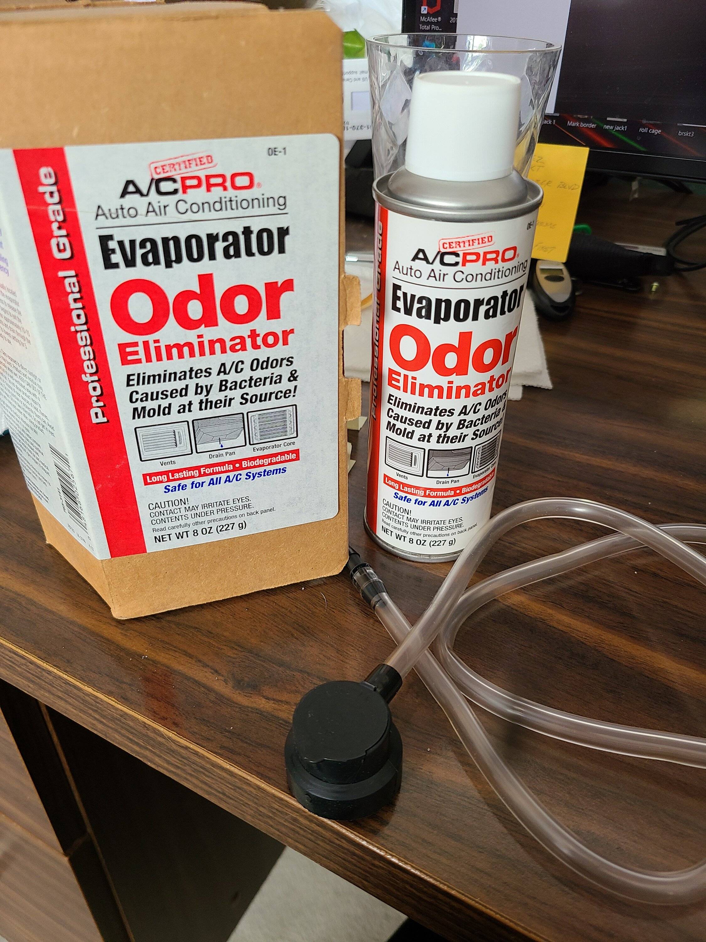

On a past truck, I located the optimum place to squirt the evaporator cleaning foam and drilled a small hole, just large enough for the hose that came with the cleaner. I covered that hole with electrical tape. But it allowed me to clean the evaporator every season.
You don't want your evaporator to get like the one on the left. You can't clean that level of contamination without removing it and even then it's iffy. I had to change one in an old car once due to contamination similar to that.

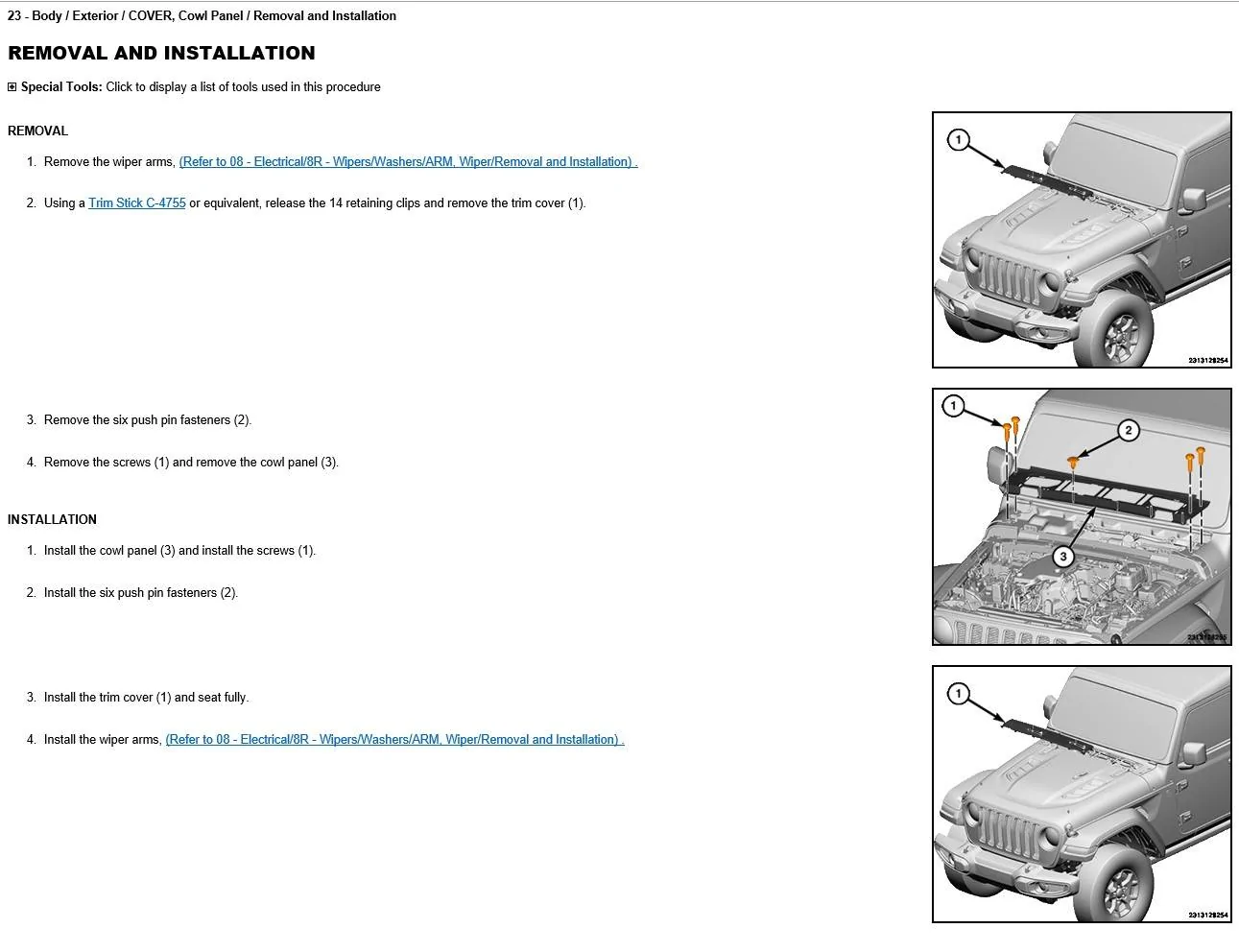

Here's the procedure to remove the cowl.
Jeep Wrangler JL A/C suddenly smells terrible! Jeep cowl removal
