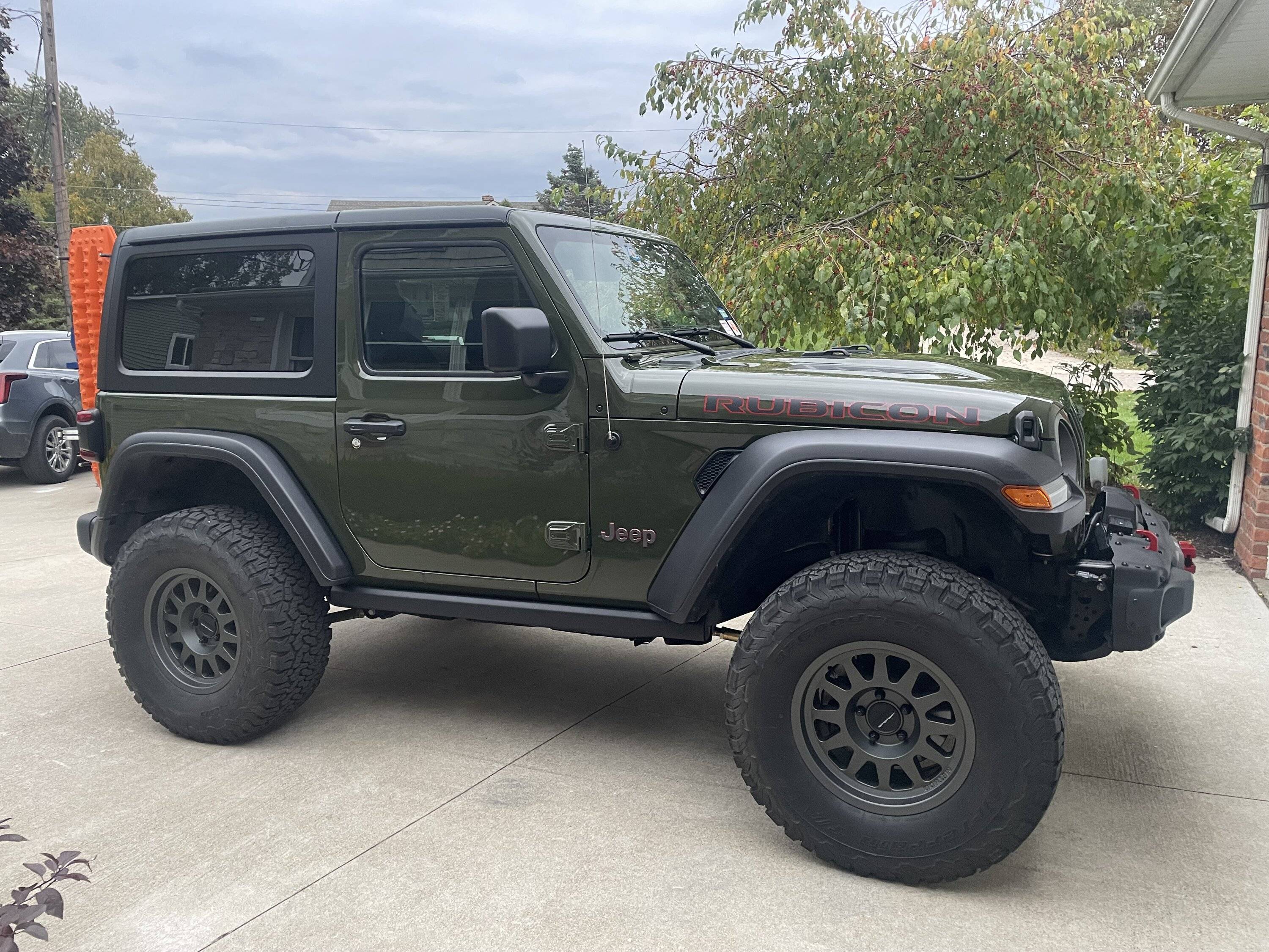

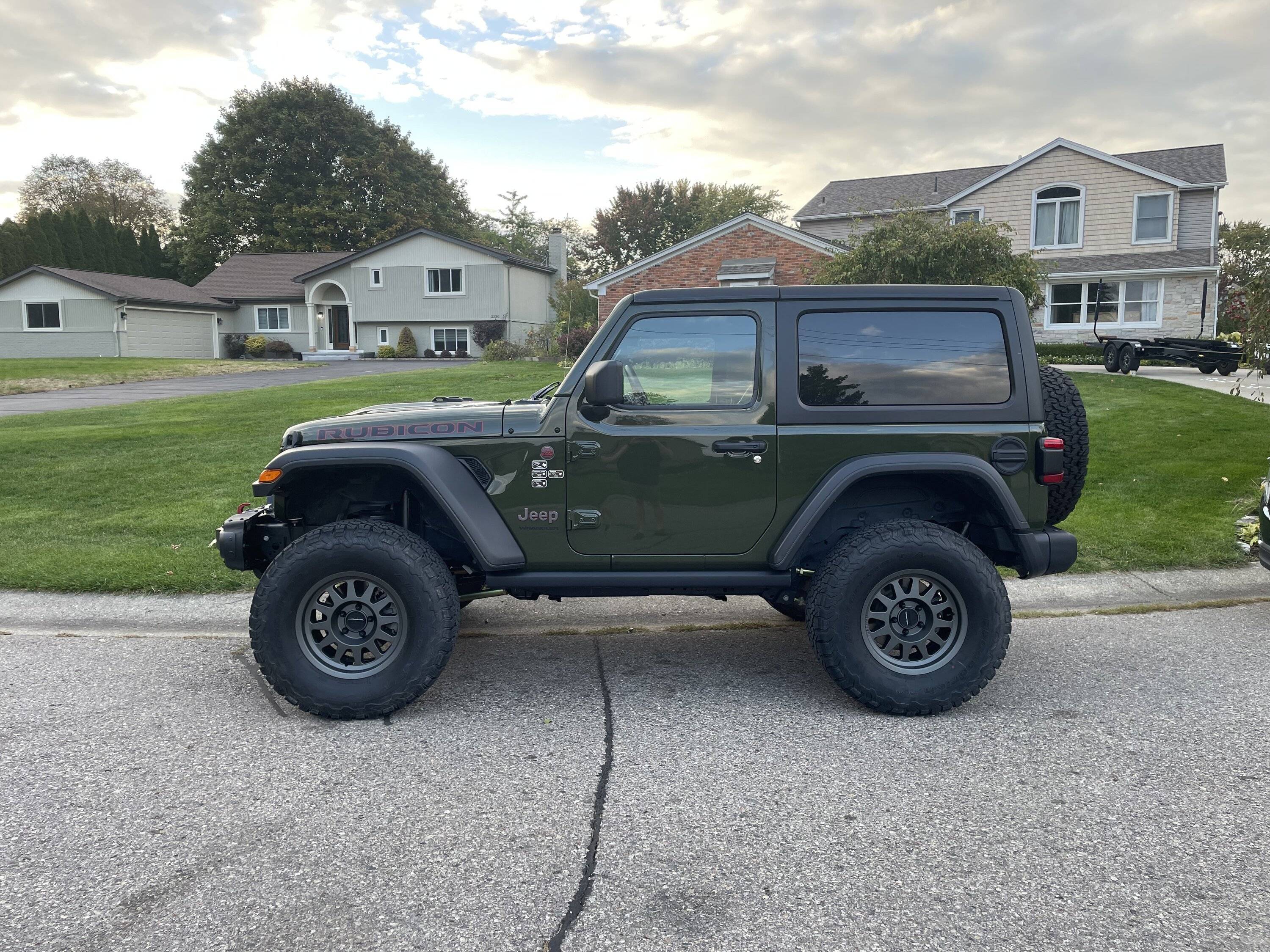

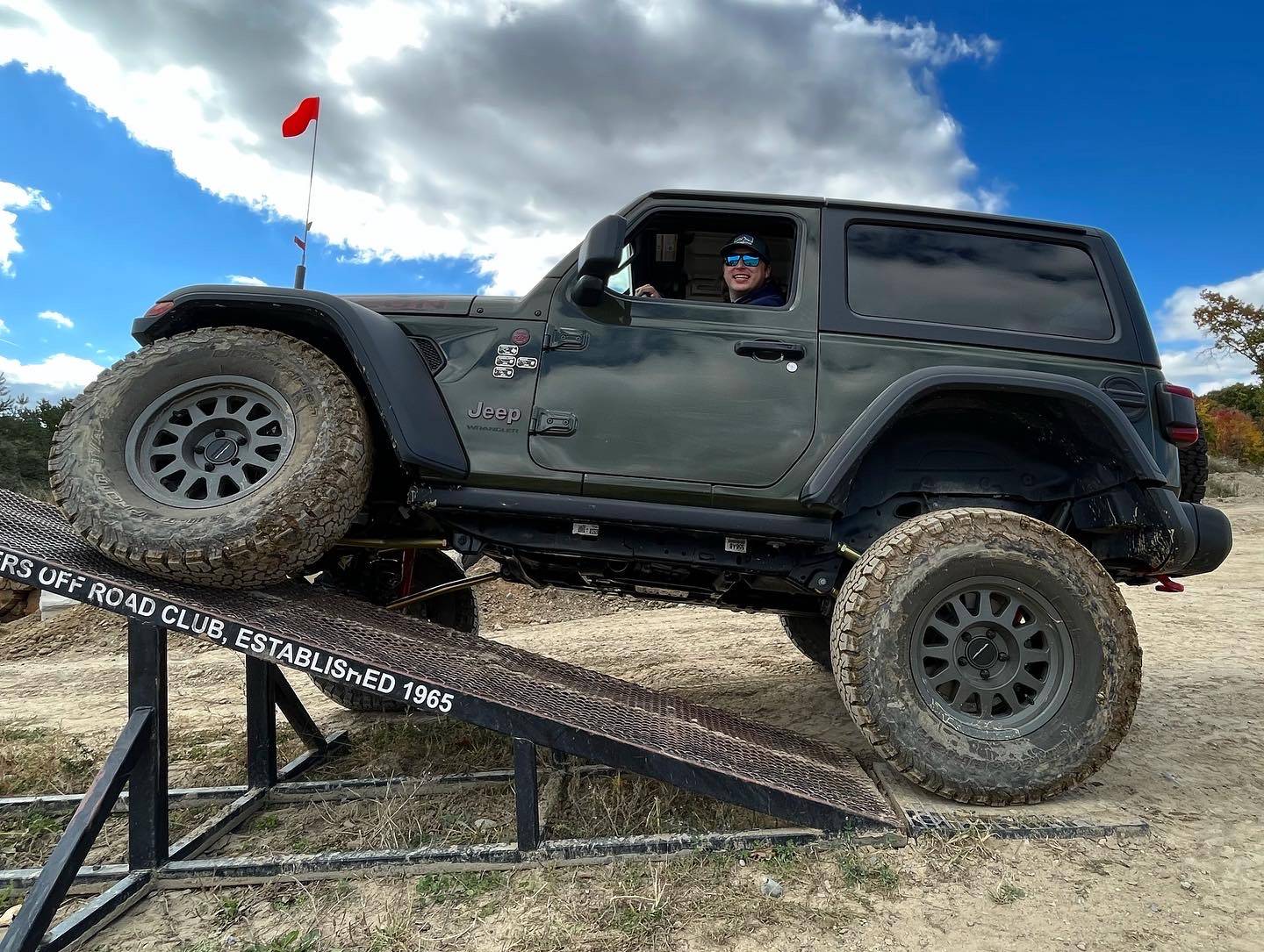

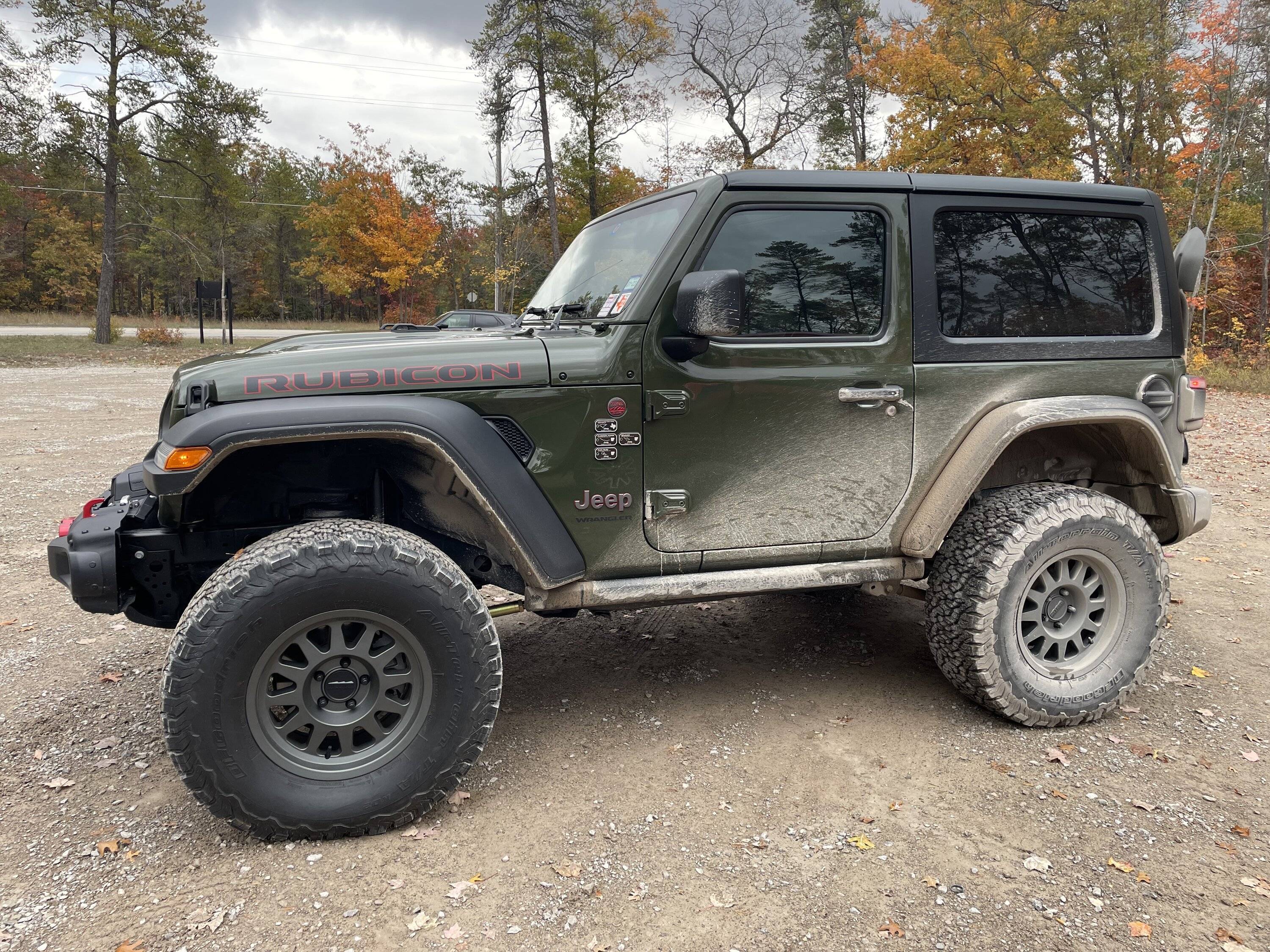

I have the Method 704’s with 4.75” backspacing (0 offset) with the Metalcloak Gamechanger 2.5” Suspension.
You can get away with 4.75” backspacing on the MC lifts only with the wider Rubicon axles and max tire size of 37x12.50… might be able to go to 38’s, but I did not confirm with MC.
Running some XR take-off KO2’s on my setup now, and have been down to 8-10 psi many times with no issues, but not in pure rock crawling situations with those pressures. Definitely enough grip for sand/mud and minimal rock at those pressures, but I didn’t get into much side loading.
If I had to do it all over again, I would consider the Icons a bit more seriously as an alternative to the Methods. Better bead grip without going full bead lock, but I wouldn’t swap from my Methods to the Icons.
If/when I go beadlock, I’ve been seriously considering Traction Off Road. Minimal backspacing, locks both beads, and from what I remember, weight isn’t too bad (but I could be wrong on that - it’s been a while). Hard to beat that!
Pics of my 704’s

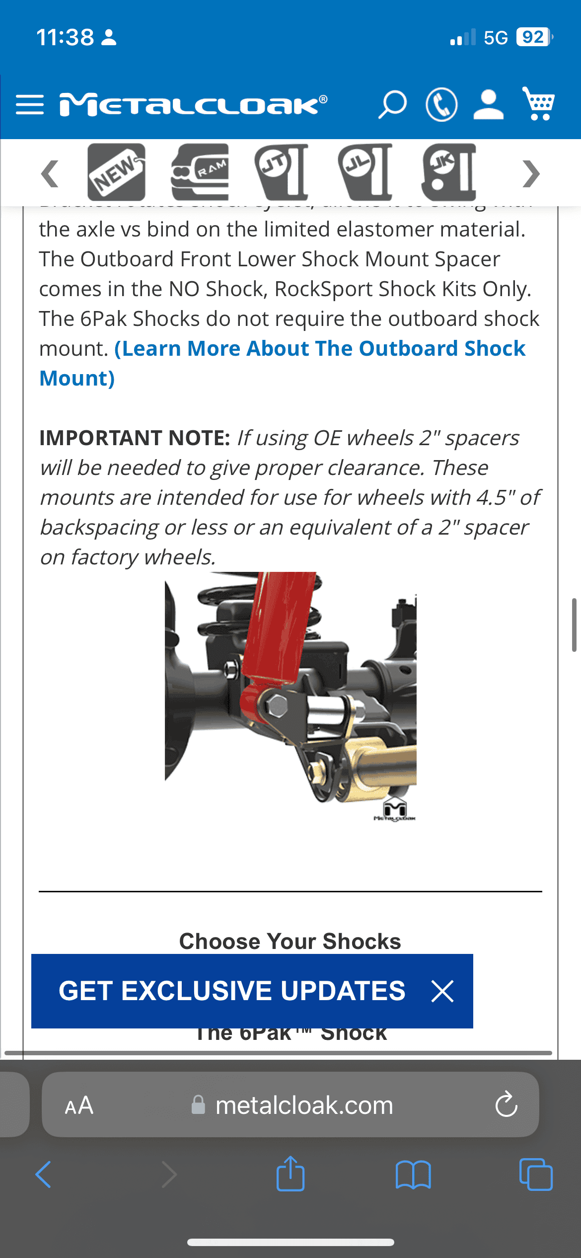

I have the shock relocation mounts. Just going based on metalcloaks recommendation ?‍♂

Fair! I love the KMC’s and I know lots of guys running them love them. They were one of the first wheels I looked at when considering bead locks to possibly replace my current Method Bead Grips.
I also have the shock relocation mounts, but wanted to stay as narrow as possible so did some digging and noticed the 392 lifts can handle 4.75” backspacing wheels and has the same axle width as the standard Rubicon, so I called Metalcloak to see if the 4.5” backspacing requirement on the other lifts was to accommodate narrower axles, and it is! Not sure why they don’t list exceptions for Rubicon axle widths…

Ah! Good to know ? That should be spelled out better in the instructions for sure

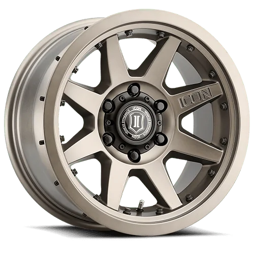

Icon makes an "Innerlock" that uses pins to keep the tire on the wheel.
As I read down through the post, I noticed you seemed to like the bronze/gold look (which I think would look sick on your red Jeep) and, I was on the same page @rdfact was with the Icon "Innerlock". The Icon Rebound Pro's in brass seem to fit those two requirements and look similar to the Methods you linked in your original post.
Jeep Wrangler JL Jeepeto Needs New Wheels (Help me pick!) 1689244655523
Such a clean wheel design and you get serious bead lock ability along with no rings to worry about.
You may have to do a little research to make sure you are comfortable with the alternate bead retention style, but everything I have seen they seem to be a solid option.
