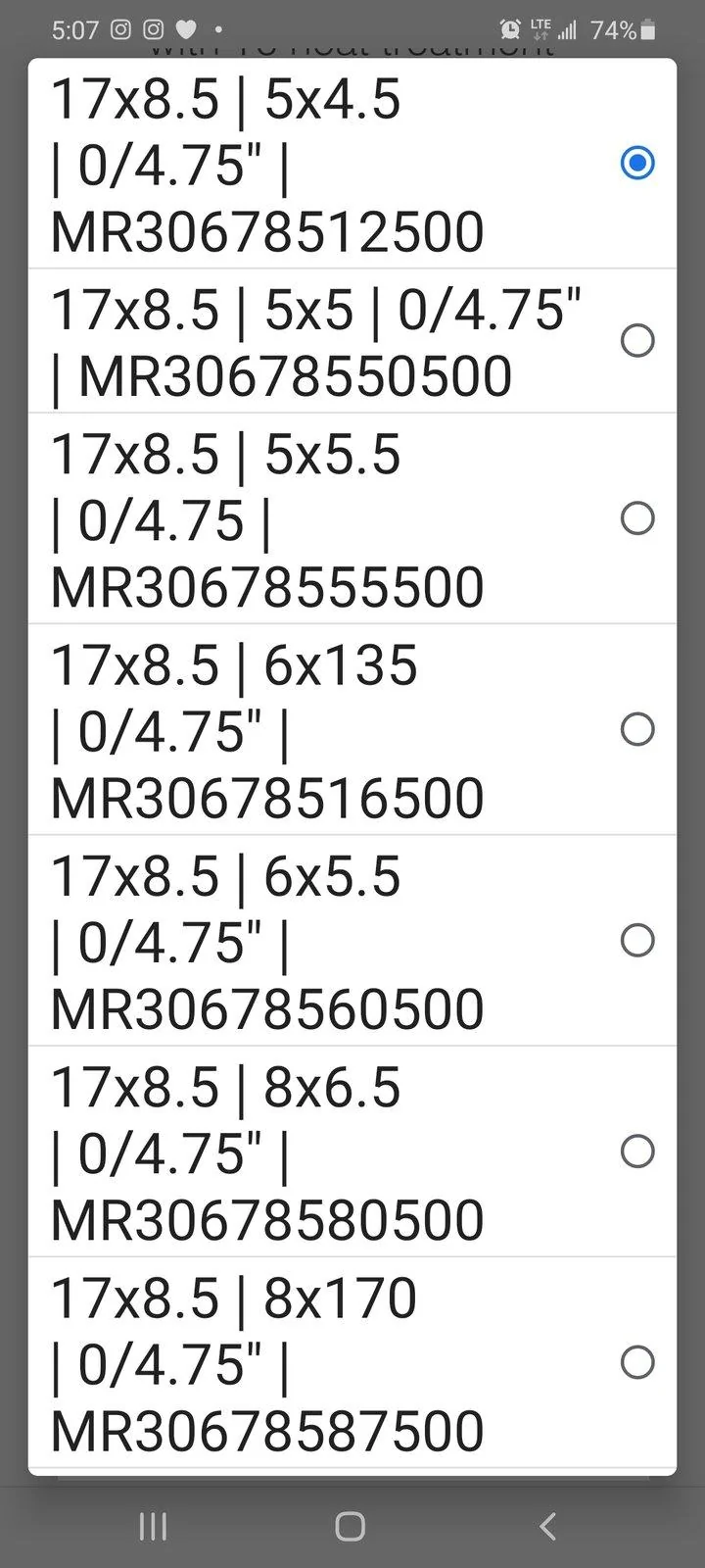

Ok. sorry. Not even sure what all these specs mean? Which one's would I order? What's the difference?

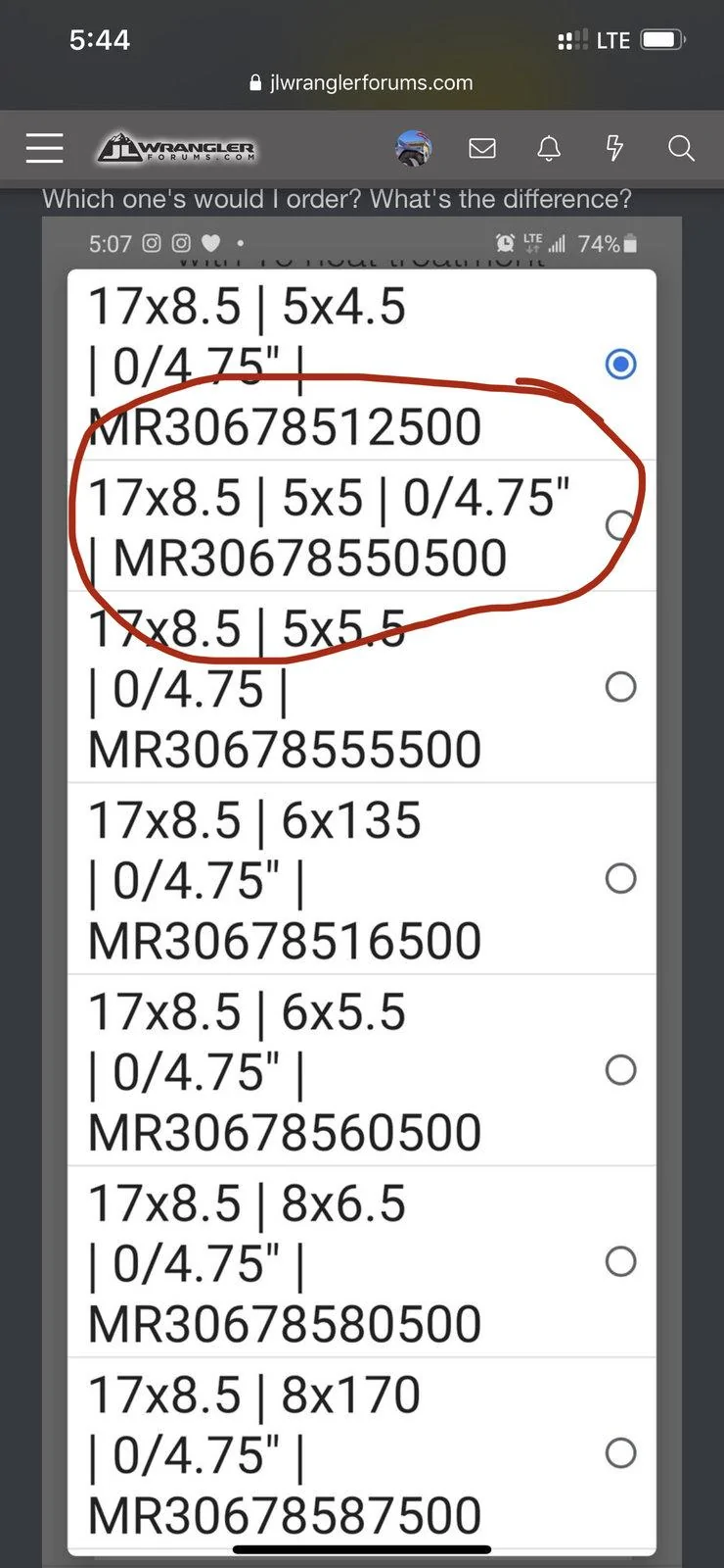

17” diameter of wheel
8.5“ is wheel width
5x5 = bolt pattern.
you should head over to TireRack, or any wheel site. You can search by your make/model and it will tell you which ones you need. I’m pretty sure you want the 5x5

The size you want is 17x8.5 5x5 (5-127) 0 offset. The Method wheels will look great. Please let us know if we can help.
