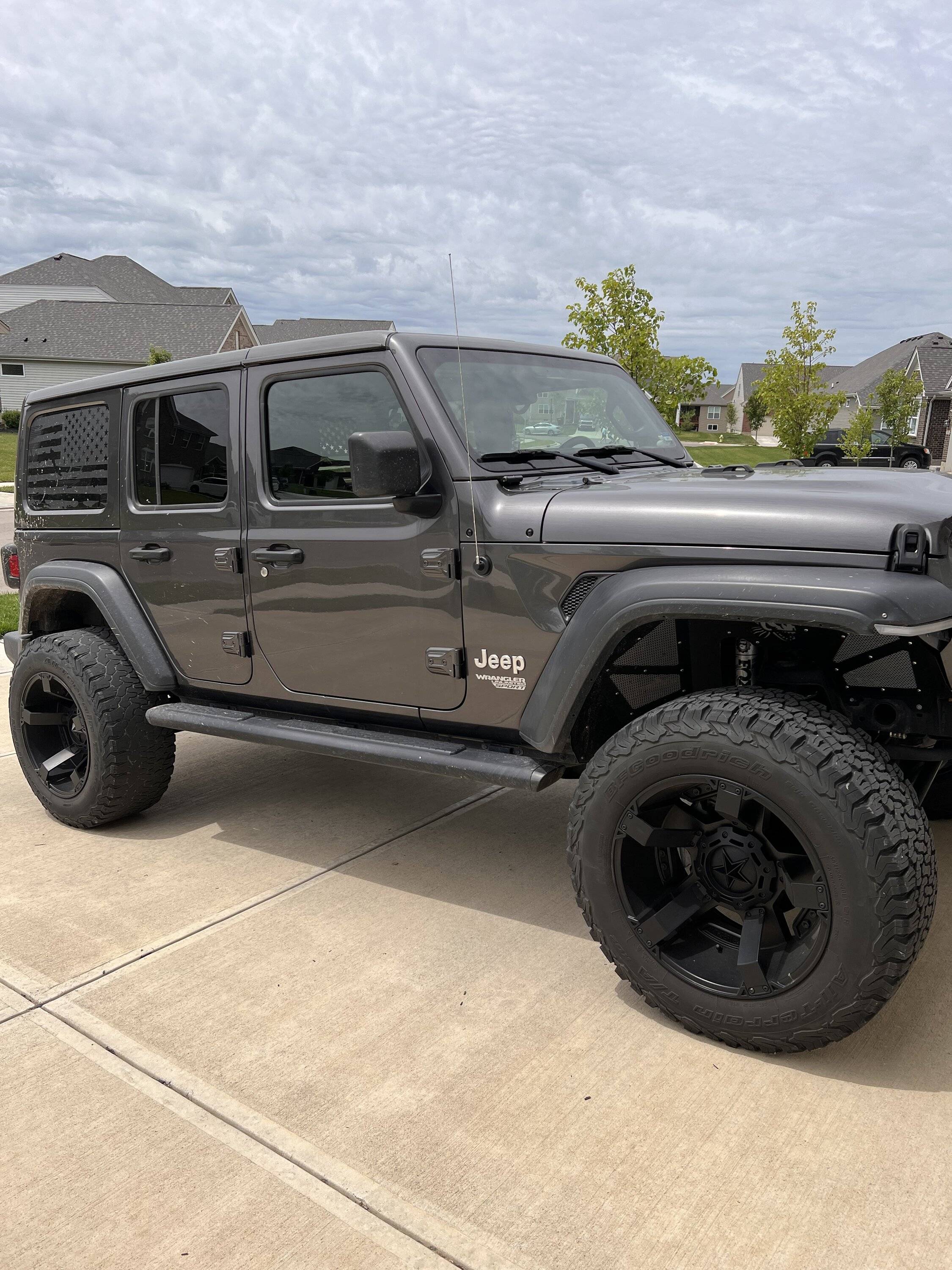

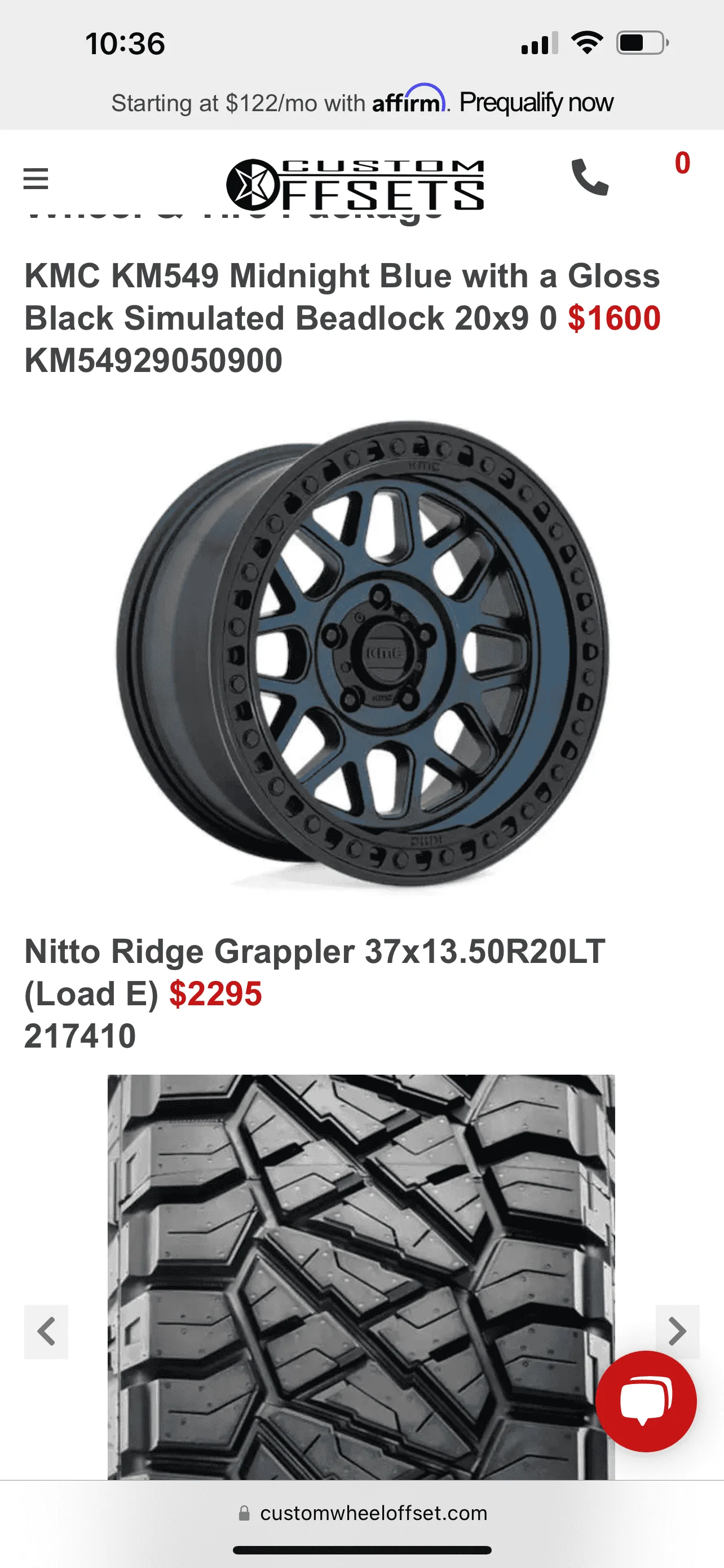

I need help deciding if i should put these midnight blue Kmc with 37 nitto ridge grapplers on my granite gray JL. Please help me!!

Zero offset is a 5" backspacing on a 9" rim, FYI a lot of lift manufacturers recommend a maximum backspacing of 4.5 for component clearance.
Hard to tell from the pictures if the simulated beadlock drains, but, if not, it ends up being a water/dirt catch.
Although it is completely your choice, if you plan to use the Jeep off road, I'd recommend downsizing to 17s for better air down performance, and more wheel protection from "curbing" on rocks. Should reduce your up front cost as well.
Others will likely recommend shying away from E loads due to ride quality, but I recommend making sure you convert the air pressure to make sure you have a good balance of load support/tire wear and comfort.

If you air down a lot TeraFlex has just come out with a larger variety of their wheels with the built-in deflators. It's just one of the many reasons that I love my Nomad wheels.
