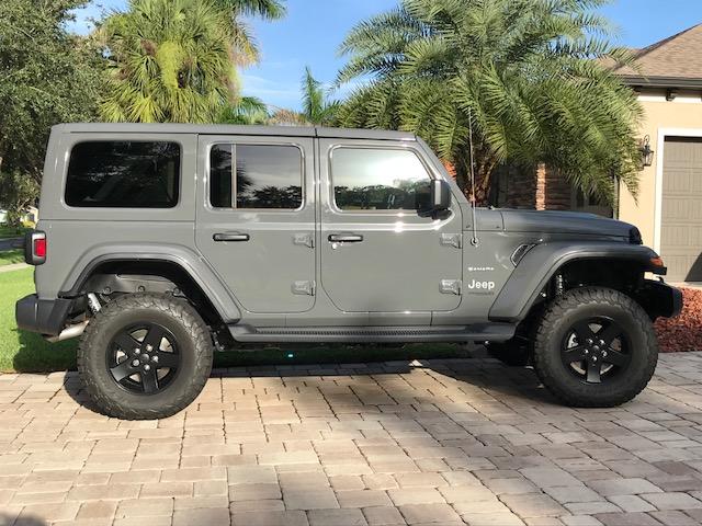

So after installing the Mopar 2" lift on my 4 door Sahara, I've decided to go with a bigger tire than what I currently have on, BF Goodrich KO2 in 285/70/17.
This is not a daily driver as it's my days off toy for going to the gym, beach, running the dog around, etc. I have no immediate off road plans as I live in SW Florida where off roading is limited and involves sugar sand and trail brush, neither of which I am interested in.
Any opininions, advice, personal experience is welcomed here.
Jeep Wrangler JL Help me decide on tires IMG_0858

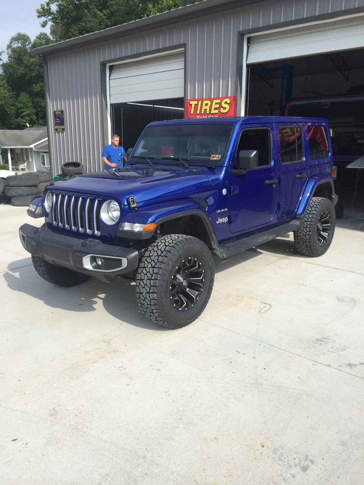

Tomcat
Thomas
Aug 18, 2018
WV
2018 Jeep Sahara JL
Jeep Wrangler JL Help me decide on tires 0FC8AF58-1B10-4929-8808-2A4848CE5C26
We did a 2 inch mopar lift with 18x9 fuel assault wheels and falken wildpeak at3w 305/65/18 Tire’s and it ride and drives great and it still does well on the interstate with that size tire and the 3.45 gear.
